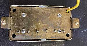

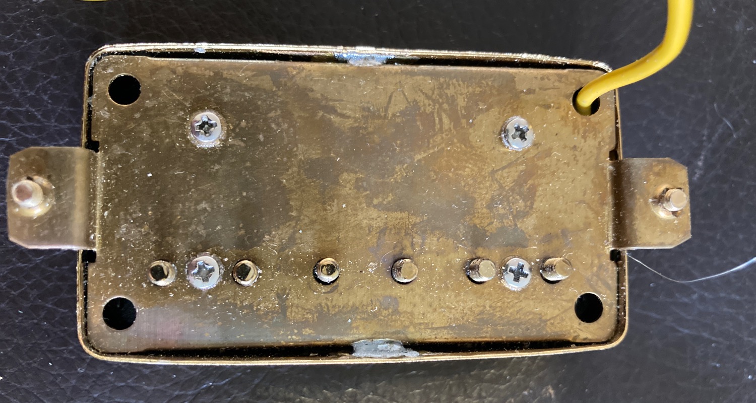

    I’ve just had a look at an old kit humbucker and I noticed a loose strand of wire poking out.

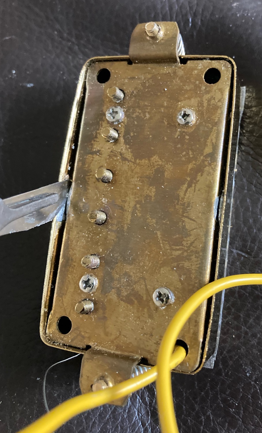

    So I cut the solder blobs holding the cover on (it’s easier to cut them with a sharp knife than to try and desolder them).

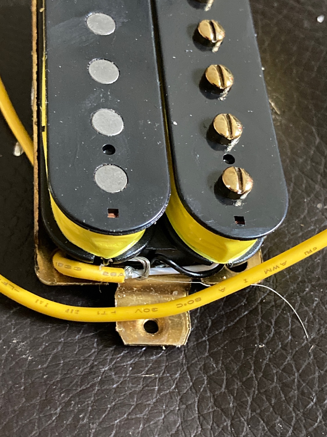

    The cover just then pulls off. This is what is underneath:
    In this instance, the wire was part of the outgoing wire outer shield, so already grounded and not touching any signal cables and would just need cutting back. But you can see that the coil connections have been made under the tape wrap. There’s not a lot you could easily do, even if you could see a broken wire.
