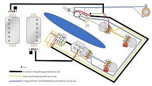

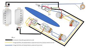

    I've redrawn Wierdbits' wiring diagram to work some ideas about how I will lay this out in practice.
Name:	Guitar Wiring 1.jpg
    In this first drawing (above), I've:
    - moved the ground to the three way switch to be closer to the bridge
    - run the neck pickup to the volume pot
    - connected the third wire from the neck pickup to a spare lead in the 4-conductor wire to run it to the 4PDT switch
    It takes the wiring around the f-hole, but there are still a lot of ground connections.
Name:	Guitar Wiring 2.jpg
    In the second drawing (above), I've:
    - soldered the braided wire (running from the 3-way switch to the bridge volume) to the neck volume and both tone pots
    - removed some of the ground connections which (I think) are no longer needed
    This is about as minimalist as I can get the wiring.
    Assuming the second drawing is a goer, I have some questions:
    1) Should the braided wire running from the 3-way switch to the bridge volume and soldered to the pots be insulated with heatshrink?
    2) I assume the wire running from the volume pot to the 4PDT should be shielded due to the length? If so, I assume I need to ground the shielding at one end (only)? And again if so, should it be insulated with heatshrink? Or do I not ground it, but instead run it against the braided wire running from the 3-way switch to the bridge volume and perhaps insulate both together with heatshrink?
    I'm going to make up a mounting template tomorrow, and check how the components will fit through the f-holes to make sure everything is aligned correctly. Then, depending on feedback from the brains-trust, I'll start soldering it together over the weekend.
    Mathew.
  3. #23
    The second diagram is pretty what I was thinking.
    If you connect the yellow output from the middle lug of the Neck volume direct to the 3-way lug along with the multi-core yellow, then you can eliminate the yellow vintage cloth run to the 4PDT. Electrically it is the same and eliminates the long wire run.
    You only really need to heat shrink things that could move and short onto something else, depending on how much slack there is in the wiring. In your above diagram, the braided run from the jack to the 3-way would be the most important to cover. Any place where a braid etc could short your hot or potentially touch a ground connection in multiple places and create ‘ground loop’, then it’s better to insulate it.
    In some cases, especially with small wires, heat shrinking connections can make them more robust as well as protecting them from shorts. If you do put heat shrink on connections, put it in place but (where possible) don’t shrink it down until you’re sure everything is solid and working correctly. And again, you always have to have an eye toward how it will fit through the f-hole.
    The shorts runs between the Bridge vol push/pull and the 4PDT may be too difficult using the multi-core, so if it is proving too awkward don’t be afraid to go to single wires instead.
