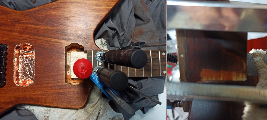

    I spent some hours this sunday monrnig in my guitar project
    Fixed tuners on the headneck and fit the bridge ( some issues due to a light distorsion with the bolt holes ( slightly more space between them,, but I thing I solved It )
    Copper isolation done ( not at the neck cavity jet)
    And at last the neck is glued ĦĦĦ with 24,75 propper distance........
    I had thought I will only need one clamp but at last I used 3 ĦĦĦĦ . Squeezed as tight as i could
    As you can see in the photos I have found that I will have to retouch the finish between the body and the neck. I expected it because under no circumstances I wanted to put oil in the gluing area.

  6. #16
    Member Juan's Avatar
    Jan 2022
    Mungia. Spain
    12
    Hi again
    Had some problems.... At last I´m so stupid I did it wrong when I glued the neck and had has to make some "wood work " to solve It.. but now it´s ok. Just have to move 5mm the bridge's holes
    I´ve made a cooper shield: pickups and pots cavities are fitted and with continuity .. I will connect them to the bridge to earth them
    I will try to solder this weekend...

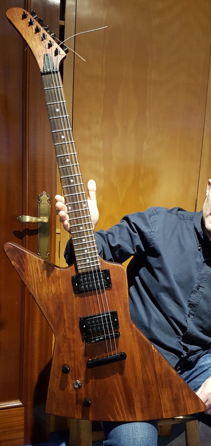

  7. #17
    Jan 2022
    Mungia. Spain
    12
    Hi friendsĦĦĦ
    Seems that at last I solved all issues and It is almost finished
    Soldering was easy
    It looks great and it sound nice....
    But theres is a bit of work to do before I can say it is ready to rock Ħ
