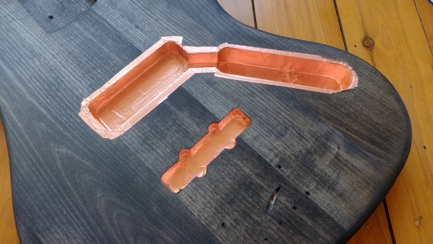

    Maybe this is basic stuff but it's all new for me! I upload here below a couple of photos in case is helpful for other beginners like myself.
    This is the copper tape laid inside the 2 cavities
Name:	2021-09-07 16.05.45.jpg

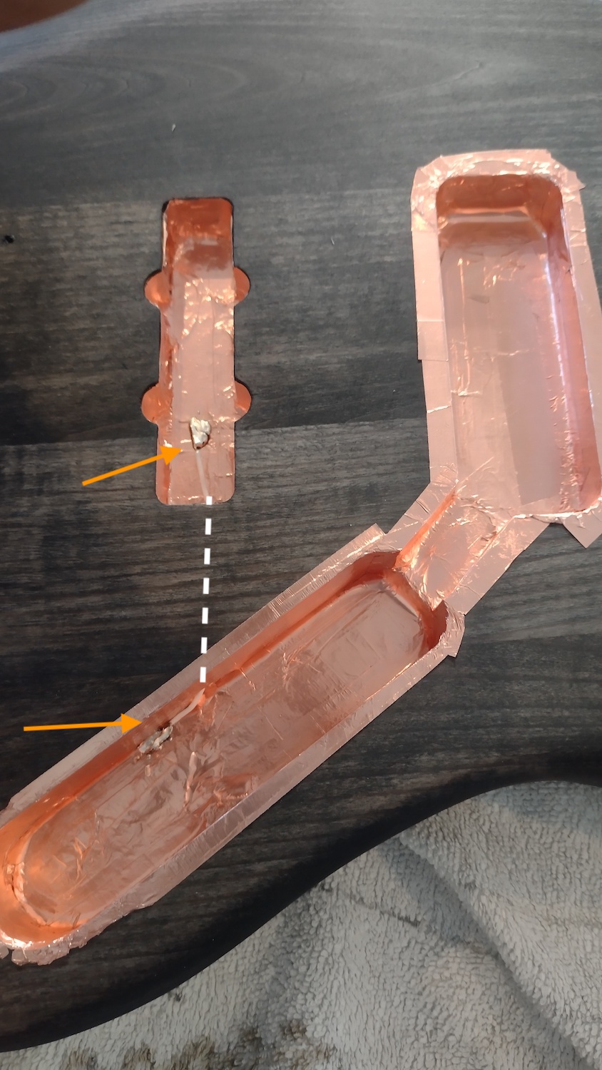

    and here the wire soldered between the bridge pickup cavity shielding to the control cavity
Name:	2021-09-07 16.27.56 copy.jpg
    Have checked with a multimeter for continuity and all sections are happily connected.
    I don't have enough copper tape to do the back of the pickguard, will do another time.
    I definitely underestimated this step. It wasn't overly complex but it took some time, precision and patience.

    That looks like an awesome job with the tape, well done!

    It's hard to see for sure in your photo, but the solder on the wire in the control cavity looks like it could be flowed a bit better.
    Next time you're doing your soldering, just hit it with the hot iron and reflow it just to be sure.
