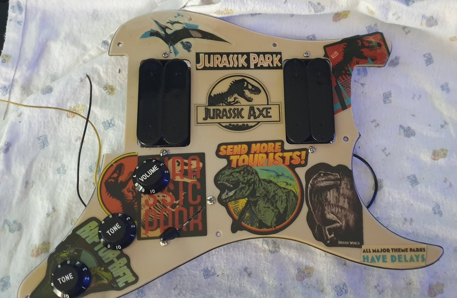

    Well, painting the pickups was a pain in the rear.
    They're not perfect, but they're painted. It took a couple of attempts to get them right. I think I like 'em more than the white.
    I did manage to get a wind up with a line buried in the clear coat across the pick guard - just showing how slow it is getting that stuff to harden. I wound up having to sand that area back, respray, resand and polish to get it back. There's still a few spots that are just too deep, but it's not so noticable. I'm not feeling terribly perfectionist, so I'm happy to leave it like that at the moment.

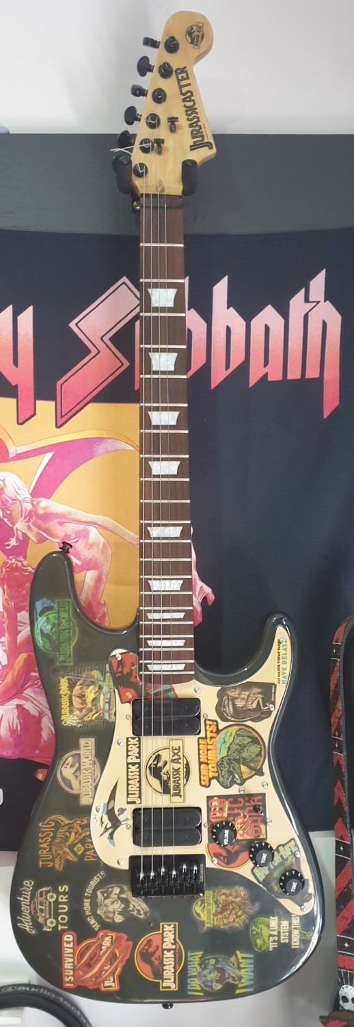

    99% Done.
ID:	41997Click image for larger version.
    The bad:
    - The driver skipped when I was putting the bridge screws in, putting a hole into the finish below it. It's gonna take some time to fill and polish it up.
    - The string ferrules - I didn't quite have enough space between the holes, so they're overlapping in a couple of places.
    - I broke the 1st and 2nd string intonating. I don't care. They were kit strings. DR Black Beauties will go on it when I'm ready.
    - I'll need to pull the spring off the 6th to get it to intonate. It's close... but I need just a fraction more out of it.
    The electronics work, though the tone controls don't seem to make much difference. The volume at least does.
    The body is actually damn near liquid shiny.. except for where you can see my fingerprints. It could do with a little more polishing, but I'll get to that when I finish dealing with the unintended hole.
    For the TL;DR readers, the body was actually gloss black, now it's an interesting colour. There are a lot of layers of cl
    ear coat, and it does start to discolour. The pickguard is a great example of that - it was white, and it's only had a fraction of the coats the body has had. The stickers on the front are buried fairly deep. There's a few edges sticking out, but across the top is buried fairly well. Edging is more obvious on the back. The discolouration was starting to get a bit much and was rapidly going from sun aged discolouration to just a nasty brown-ness to it that wasn't even consistent, so I called it quits there and pulled it back as far as I game with sanding whilst ensuring the stickers are well protected.
    I don't think I'd rush out to do a finish like this again in a hurry. Still, it was an experiment, and I don't hate the end result.
    It's been a fair journey so far - 40 days since the kit arrived and still a few days before I can finish it off.
