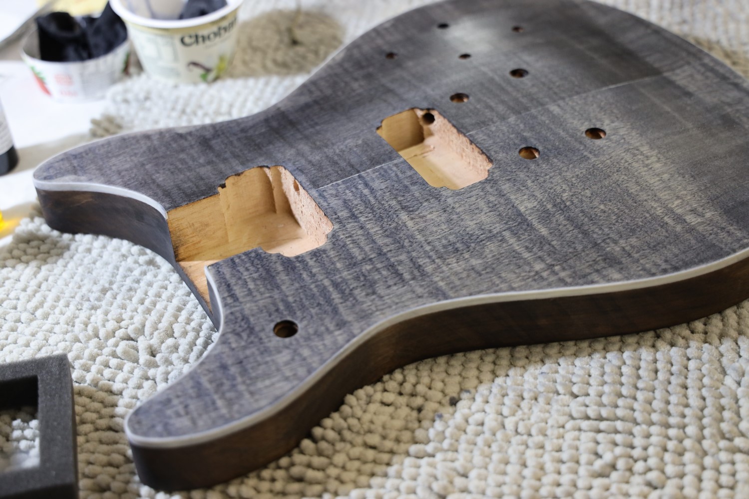

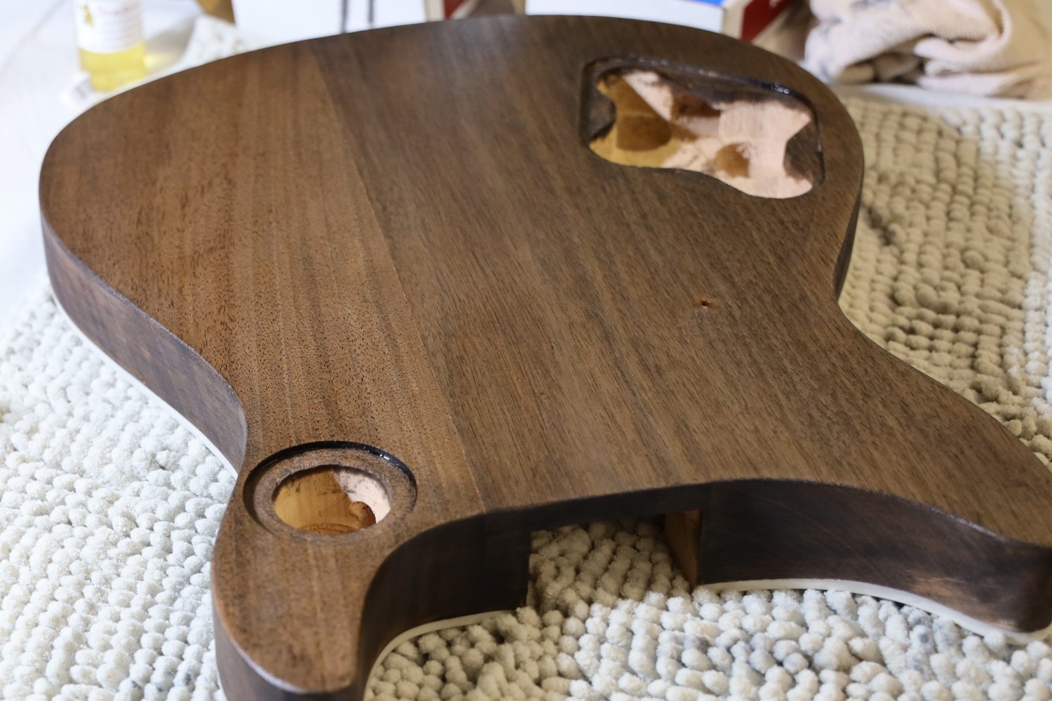

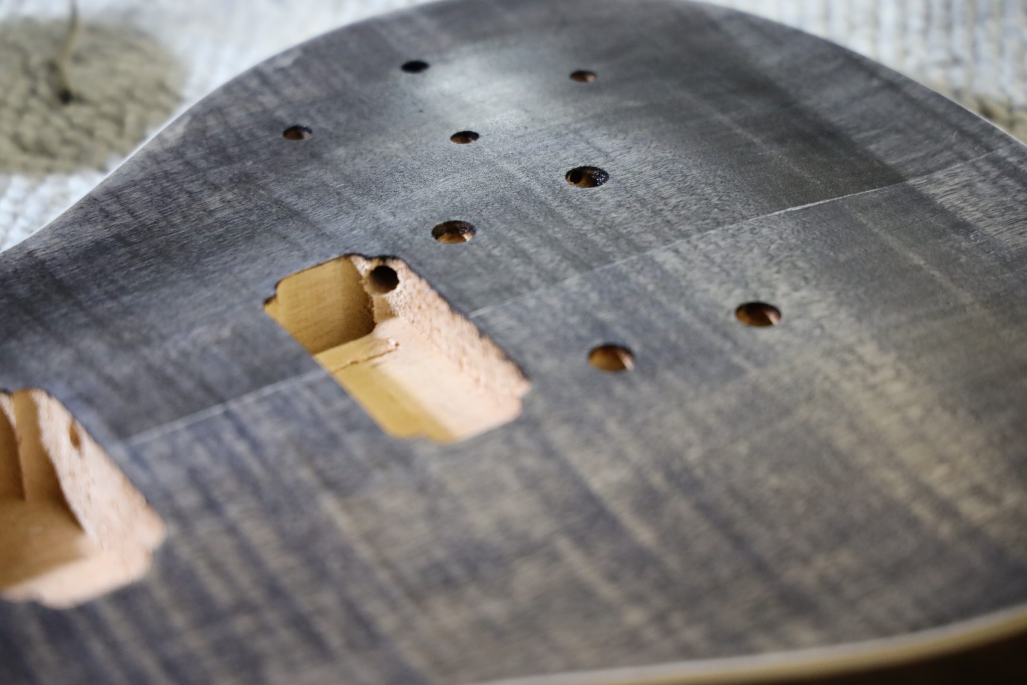

    OK. Underway and things are going ok. Lined up the strings and the neck seems fine. Quite a few machine scratches over the body though. Got most of them out with some fine sandpaper (P400, worried about wearing through the thin flamed maple veneer) but I think that has caused some issues with the absorbency of the DingoTone so I have a few patchy spots that haven’t taken the colour so well.
    I’ve used Black Stump with a little bit of Bondi Blue on the body, and on the front I’ve reversed the quantities of black and blue. Just waiting for the lot to dry now before applying the intensifier.

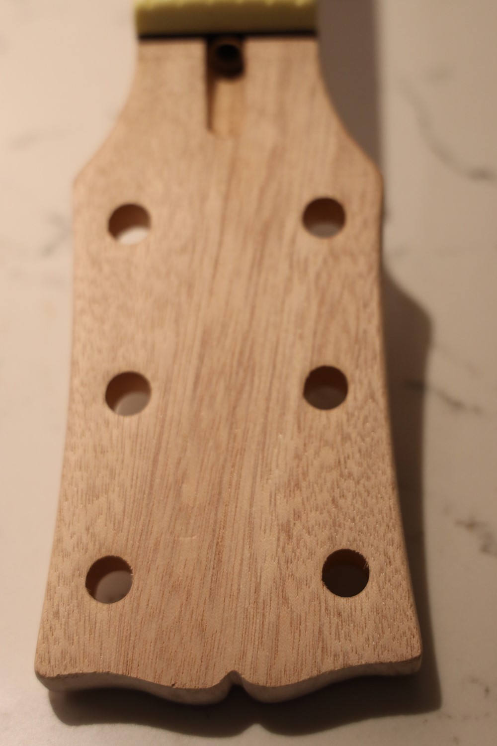

    I’m starting on the neck and it all seems pretty straight, so that is looking good. I’ve cut in an open book headstock (ie a very dodgy Gibson LP version) and we’ll see how that goes once it is cleaned up. I had a dismal fail with the jig saw initially, but I started a fair way from where I eventually wanted the line to be so no major damage done! I ended up doing a straight cut across with the jigsaw and then using a rasp and coping saw to shape it.

    Now for a few photos of the build to date! Still got some work to do on the headstock as you can see.
