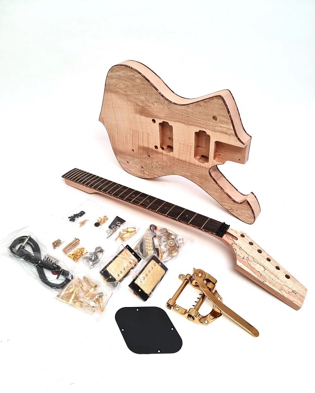

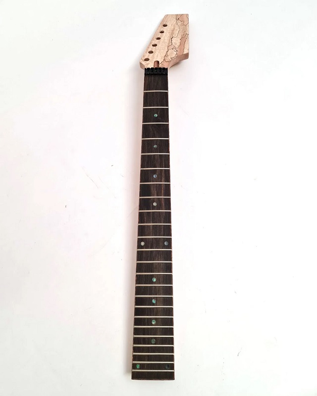

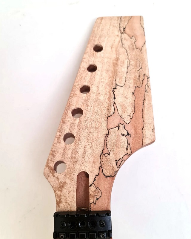

    How would you change out the locking nut...obviously for a Floyd Rose style setup?
    The bridge end has a tuneomatic bridge with a Bigsby tremolo tail piece.
    That is a big chunk out of the top of the fretboard to cut and replace. I suppose a rosewood or similar veneer and then a top of the fingerboard mounted style nut...like the BIG G guitars.
    But as it is...tuning and intonation completion would be a nightmare.
    I love the veneer and the binding though. How good would this look natural finished????

    I would look at custom making a cradle for a roller nut set up or a solid brass zero fret/nut/string guide combination.
    you could also do an accent piece behind a standard F style nut, like a decorative plate behind the nut?
