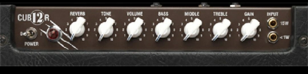

    Today my Christmas present arrived. It's back in the box now, but I had to take a look at it to makes sure everything was working,right?
    In the US this amp is sold by "Monoprice" and is branded "Stage Right" (model 611815). It seems to be sold in some places as the Harley Benton "Tube15" amp, for example by Thomann.
    Most of the reviews have been good. It seems to be a re-cabbed version of the Laney Super Cub 12, which have also gotten decent reviews. There are some differences. The Laney has a proprietary speaker and a digital reverb. The Stage Right has a small spring reverb and a Celestion Seventy-80 12" speaker.
    One of the biggest surprises was that, unlike many of the reviews which indicate that it has unbranded tubes, mine came equipped with JJ tubes. Three 12AX7's and 2 EL84s. Rectifier is sold state, so no tube for that.
    One cool feature is a switch that drops the power output from 15 Watts to 1 Watt. Good for my garage.
    Won't be able to really test it until after Santa officially presents it. I wanted something primarily for home use that would be loud enough to keep up with my son's drums and would not break the bank. Looks like it should fit the bill.

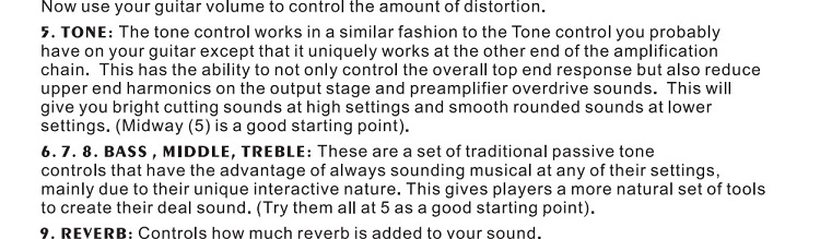

    I’m curious about that amp having a 3 band EQ plus an additional Tone control.
    I’ve not seen that before on any amp.
    I have. I have one on my Laney Ironheart. It’s a simpler form of the Blackstar ISF control. This is more of a tone ‘tilt’ control, so central is neutral, to the right is more treble and less bass, to the left is more bass and less treble. It's gentler and less peaky than the normal 3-band tone controls. You can treat it in two ways. One is to use it in conjunction with the EQ to help get just the sound you want, or if you gig a lot in different venues, you can leave your basic EQ settings as you prefer, and you use this control to adjust for the sound of the room e.g. if it’s bright sounding with lots of hard surfaces then turn it to the left, and for a dull room with lots of soft surfaces and drapes/curtains/carpets, turn it to the right.
    Or whatever. It’s just another control to help get the sound you want.
