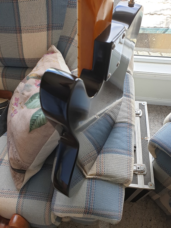

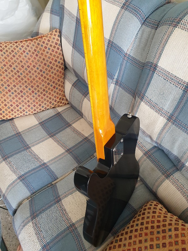

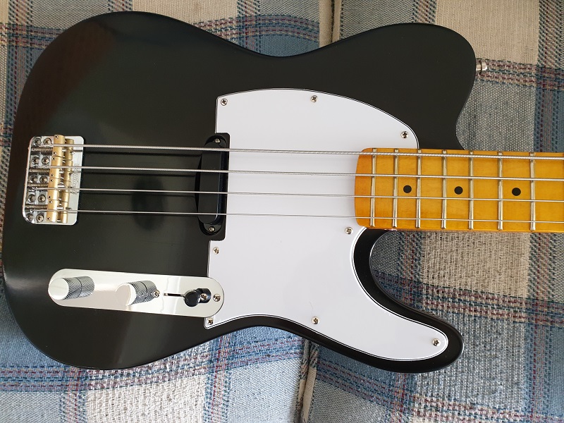

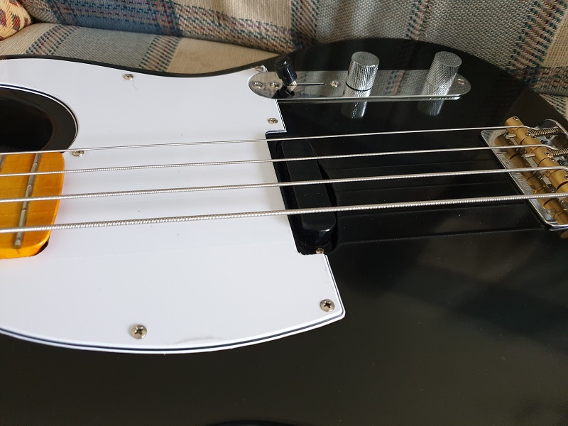

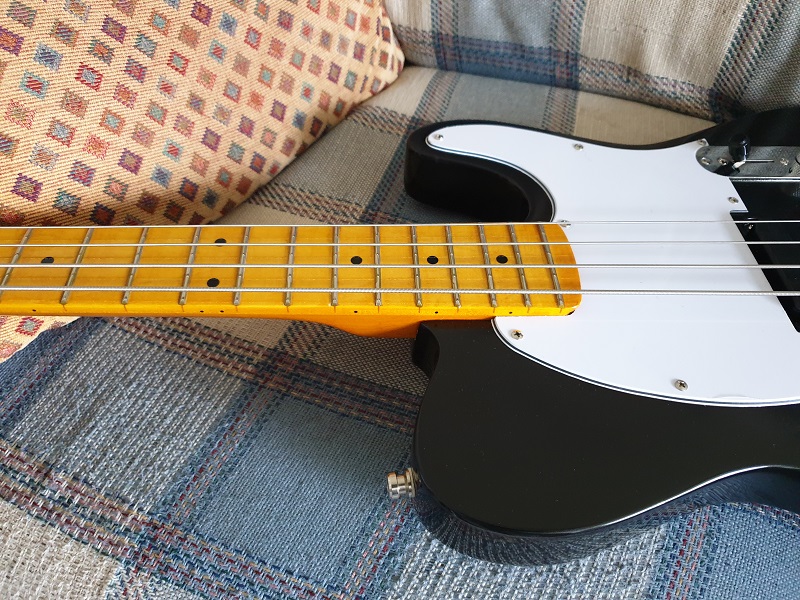

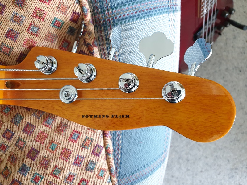

    One humble daggy simple Tele Bass is lost amongst the tall trees.
    The Build Diary....
    https://www.buildyourownguitar.com.a...ad.php?t=10588
    Standard Electronics, bone nut, Gotoh Tuners, Switchcraft jack, recessed jack socket.
    Spray can black body finish. Stained and Spray poly neck and fretboard.

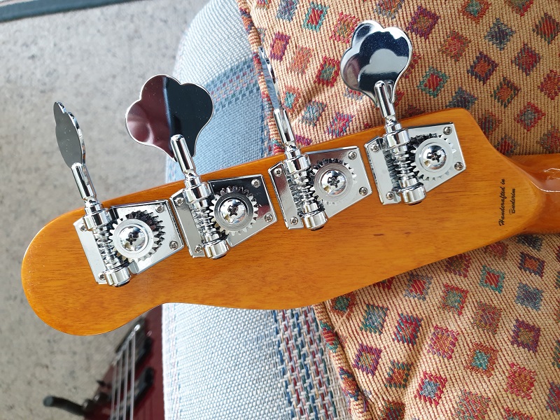

    And a couple more to complete the picture.
    Just two more....

    Quote Originally Posted by colin2121 View Post
    Nice looking bass. Black gloss finish is sparkling in the pictures.
    How does it sound?
    The pickup has six magnetic pieces in it and the fat E string does not really get heard as well as the other three.
    That being said...I am amazed by the sound from this pickup and the standard kit electronics. The output is low...compared to ToneRider, Seymour Duncan, Entwhistle pickups I have here in other basses. But, the mid range and top end this pickup brings is amazing in use. I had to play with my EQ on my Amp and now I am loving the bigger sound....more noises make more smiles.
    Thank you for the kind words....it is not a good finish...and not a good path for me. I have no idea what I am doing with paint...and to me it shows. I am tempted to hit the body with 80 grit and do a stain and some spray polyurethane.
    Sadly though as per page one of my build diary I wanted to try and get close to the Photo of the Black Body with a yellow neck Squier as I posted there. I think I did pretty well with that goal.
    In summary....It sounds different yet amazing from my other bass guitars...it has some weight to it...the neck feels amazing...the body is a site for a future upgrade.
    Gloss black is the hardest paint to do really well. I think you’ve made a great effort. Getting that really high gloss requires the right products, and while possible by hand, is best done with an electric buffer. Personally I think this has a lovely vintage look. Once it gets a bit of wear and tear I think it’ll look great.
    Sonic, thanks for the nice comments.
    My idea was classically simple like the photo on my first page of my build thread. I hope I got close.
    She plays really well. 😎
