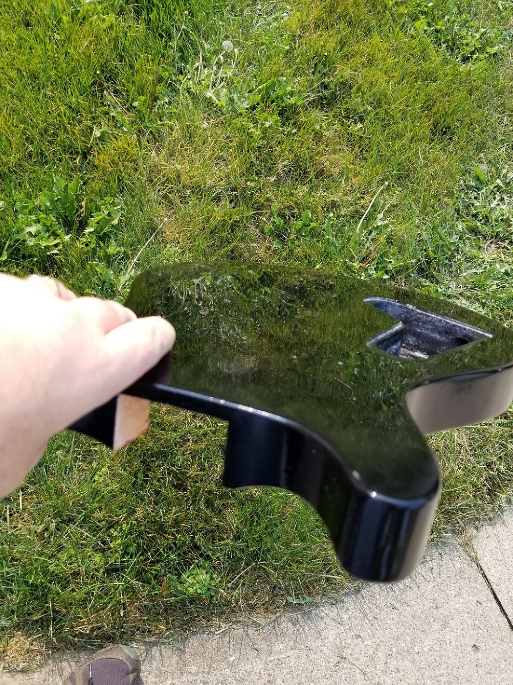

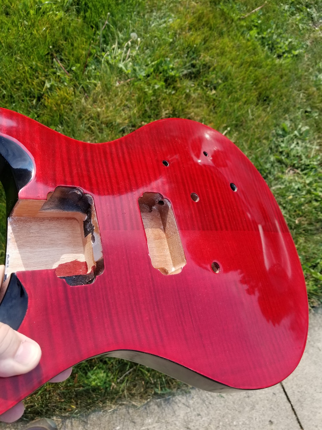

    I got the body buffed as good as my buffer can do. I need a bench mounted buffer with a couple different size wheels. My 10 inch orbital is only so good; I could get an even better shine if I could navigate curves better and maintain a slightly higher speed.
    I also glued in the neck so assembly will begin tomorrow.
    I will post a couple photos as soon as I get a chance. Plus I am starting video 4.
  7. #27
    Body; front and back
ID:	37490   Click image for larger version.
