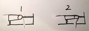

  7. #17
    5,605
    So are the strings running more like 1 or 2? 1 is better for lower friction.

  8. #18
    Hi Simon.

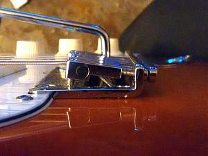

    The strings are more like '1'.
    Here's a side shot of the E 6 string.
Name:	string break.jpg
    cheers, Mark.
  9. #19
    5,605
    Ah, that's OK then. Not sure at all now. Just try some new strings.
