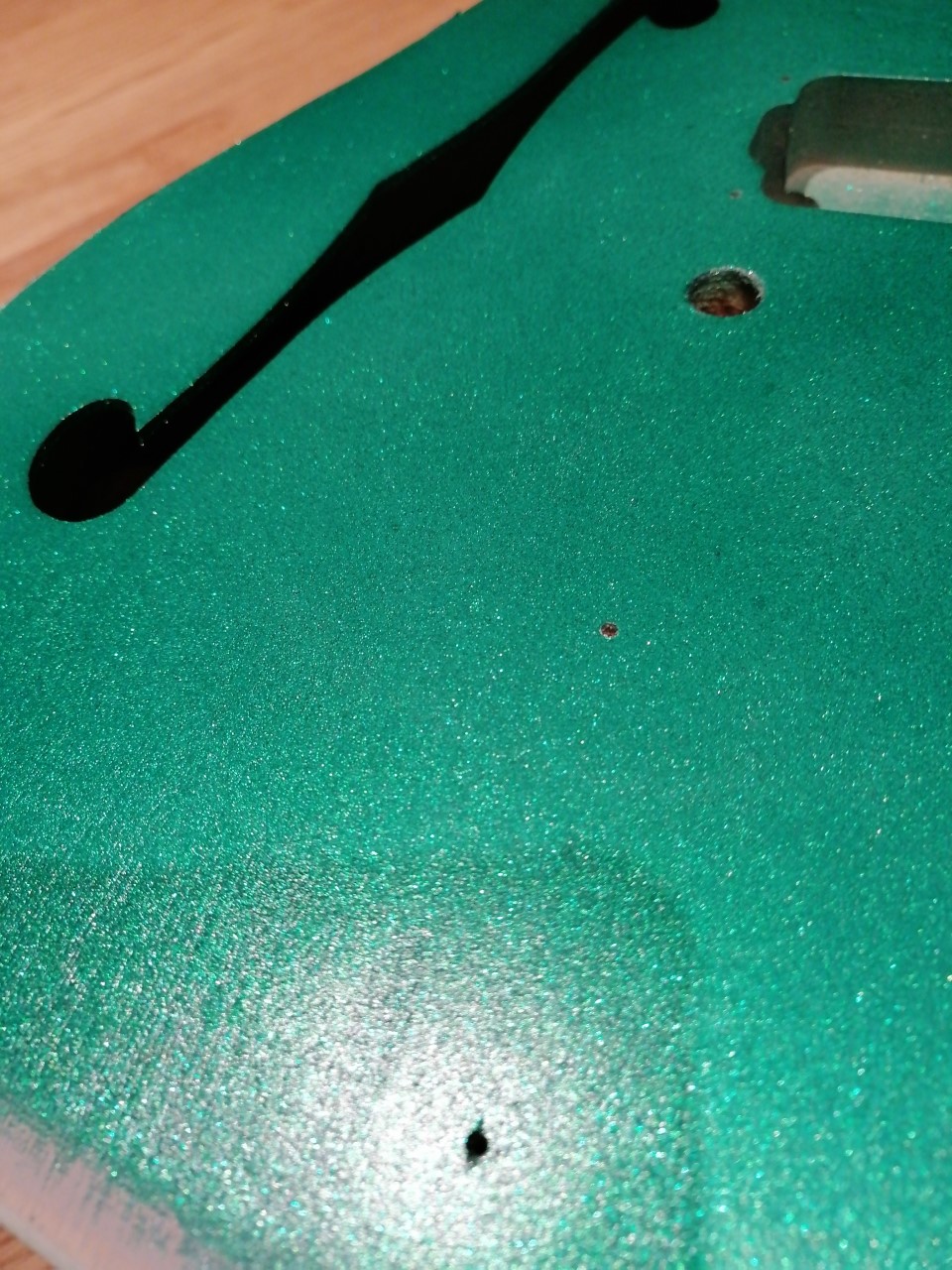

    Hello fellas, I am new to this.. And as you imagined I messed up the paint on my guitar, I wanted to do a green flake but the base colour dripped at a couple of places.. The question is do I sand the spots and redo them or do I sand the whole guitar and respray?

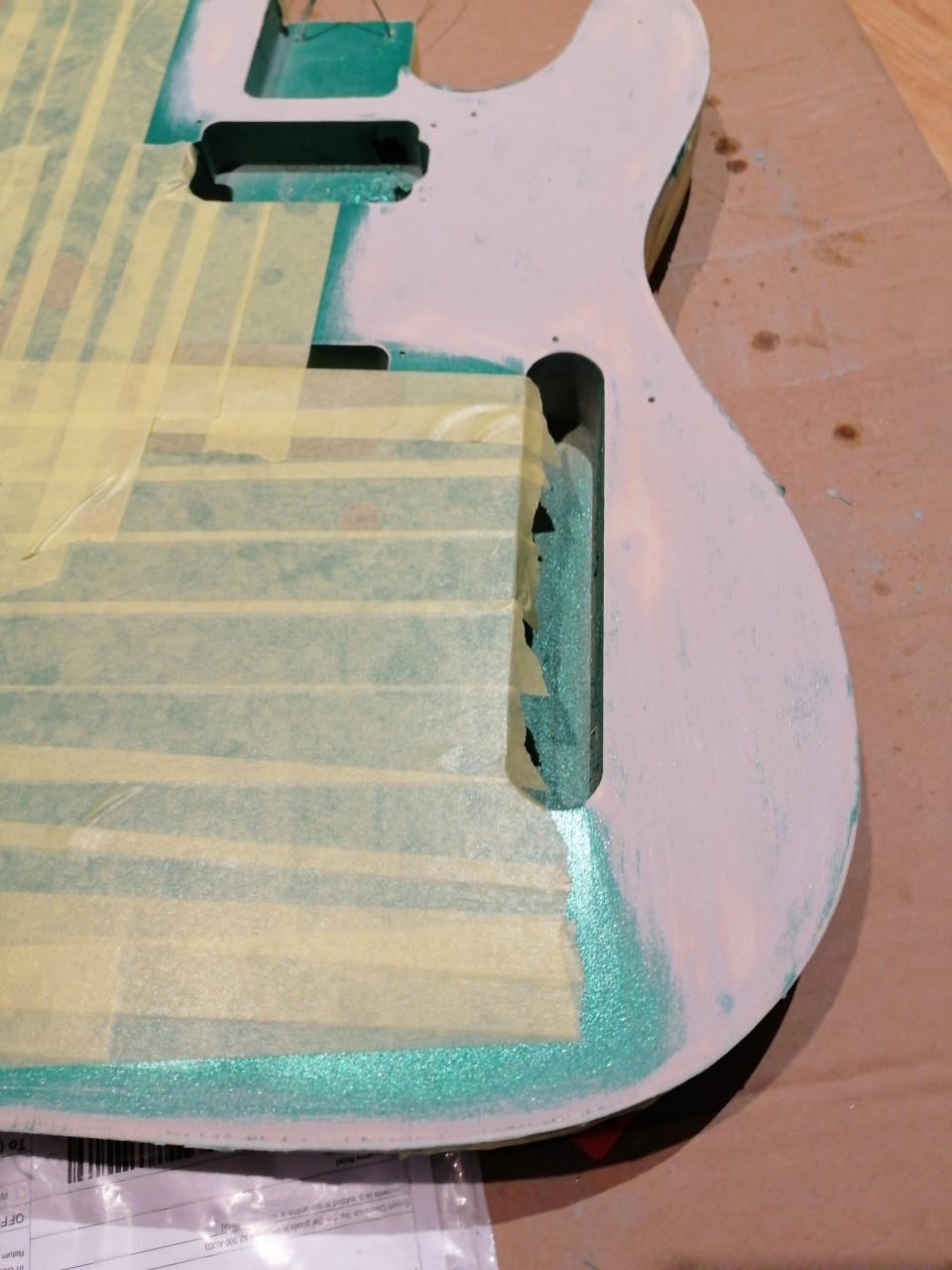

    I think I'm gonna do the whole thing again cause I think I didn't sand the primer enough and it gave some imperfections.. Thanks a lot for your replies I much appreciate it your time and effort
    I'd just sand what you have flat, and then spray over the top of that. Getting the surface as flat as possible is really important to a good finish.
    So that's what I did...What do you think I should do?
    I agree with Simon. I'd wet sand with 600 then respray

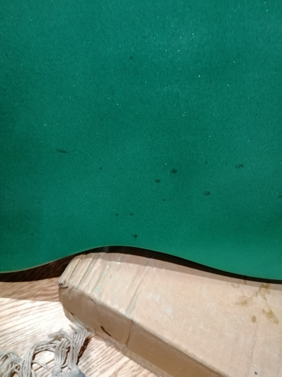

    If you noticed at the bottom of the second picture, I got something that looks like wood texture.. As if I painted with my base color directly on the veneer but I used primer and wetsanded it with 600 first.. Do you think that 6 coats of 1k clear coat is enough to cover those flakes?
