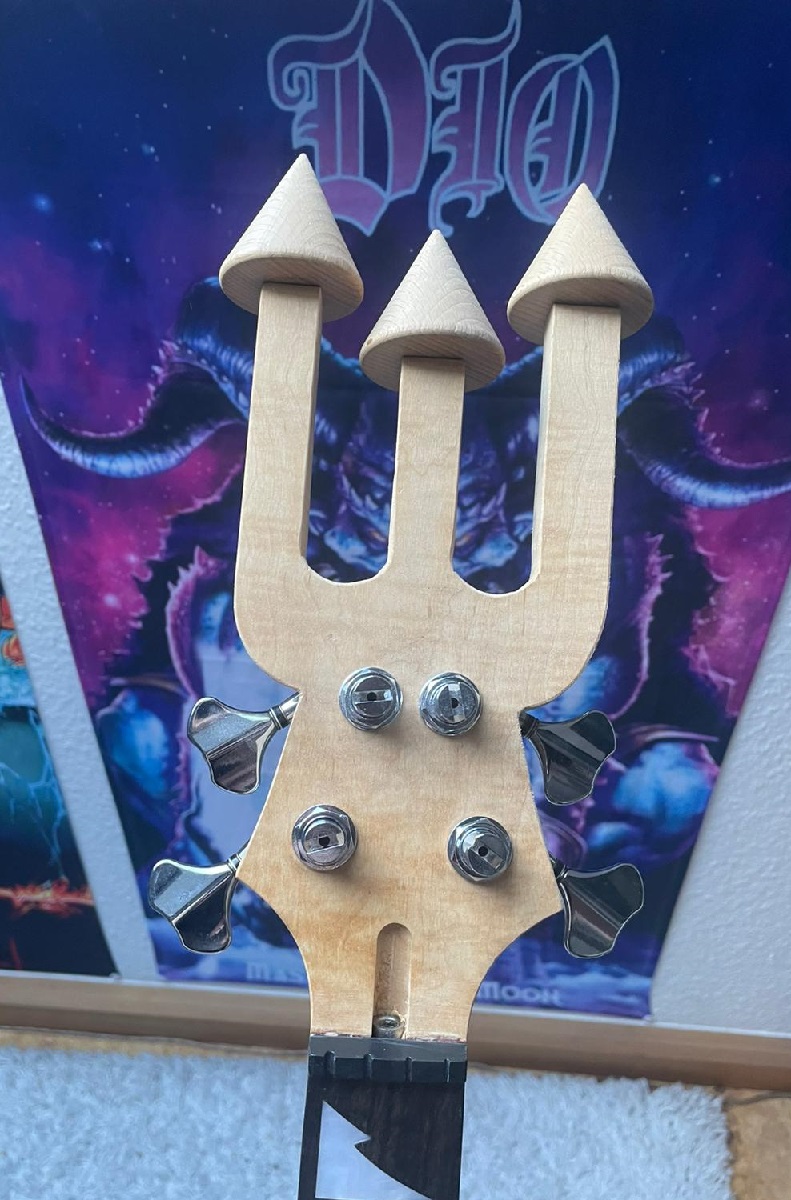

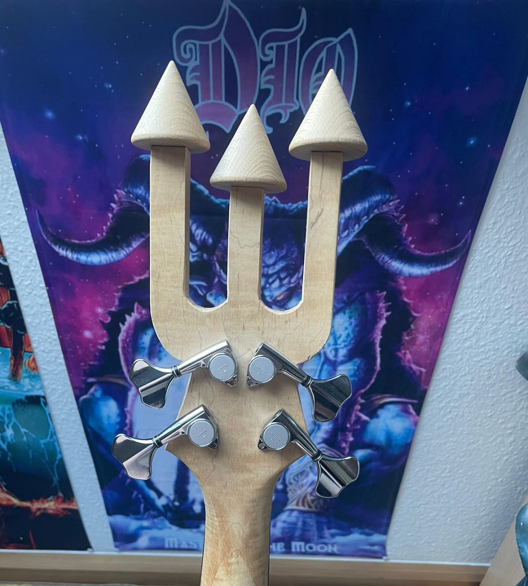

    I problem I do see is that in post #6 the two lower tuning pegs are in the wrong way! I'm sure they need to be fitted so that the string tension on the posts pull the post gears towards tuning peg gears (otherwise the gears may pull apart and slip).

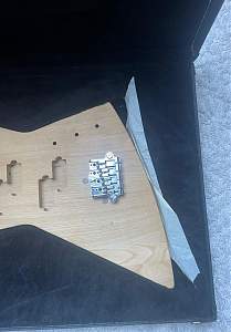

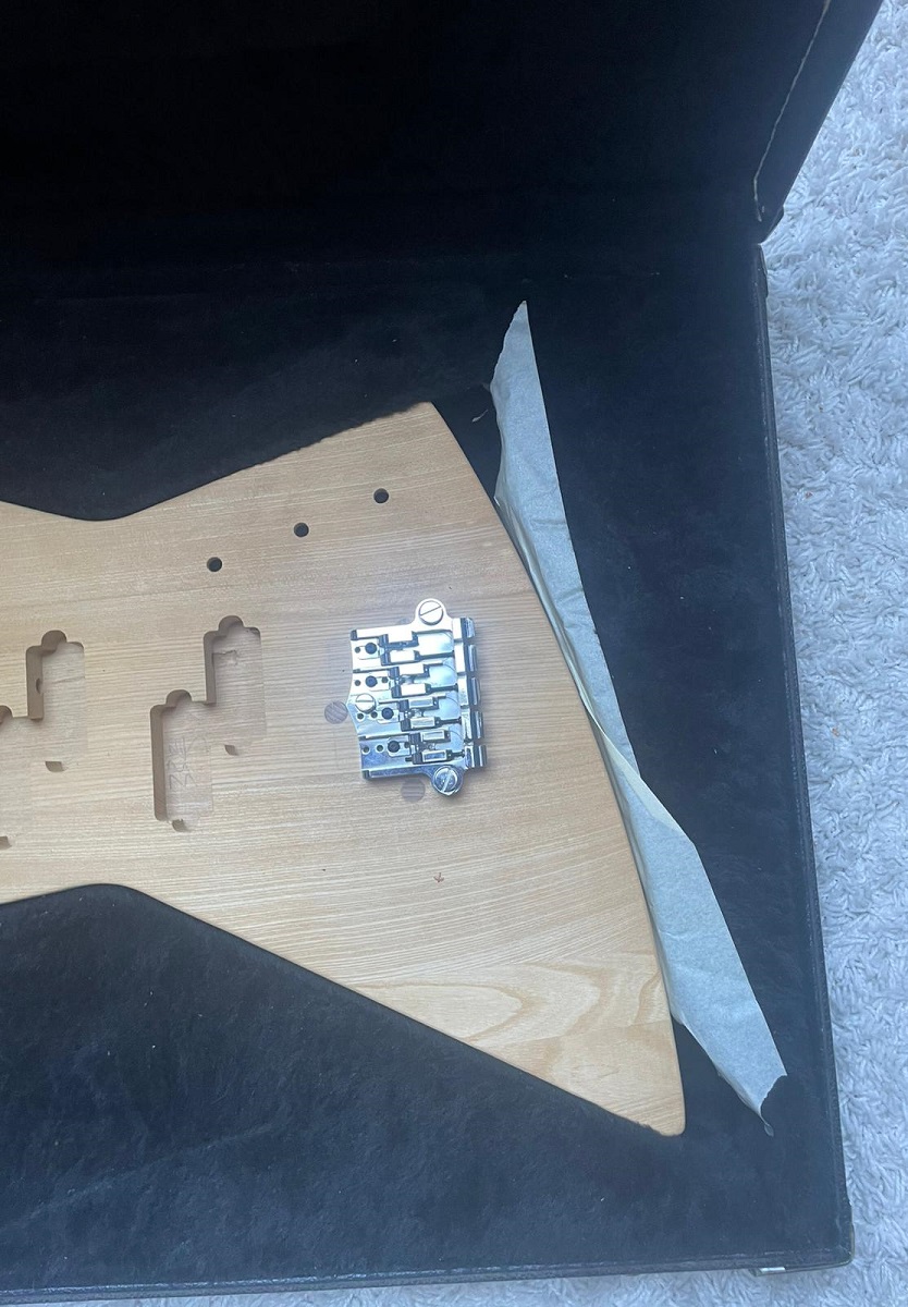

    BTW Having an oddly shaped bass project in the cue... I am very curious what you have done with the case?
    Thank you for telling me that issue!
    I was able to just switch the two and turn them around:
    I butchered the foam in the case of a Charvel Star Bass with a knife to fit both basses now

    ok, I'll still have to unscrew the spikes at the headstock...
    so....l In case someone buys a Charvel Star Bass just to get the case... I might be interested in buying the bass, especially if it is a model with P-pickup(s) and any color but black

    Great that you found a case that could fit with just a little modding! FWIW I found a fabric store that sells "fur" similar to what is in a guitar case. I bought a couple of square meters of it that I have been using to cover either places where my cuts have left the foam exposed, or to cover foam pieces that I have cut to improve the fit of the guitar in the case.
    It occurs to me that if get tired of unscrewing the spikes, you might be able to use steel slugs/dowels and rare earth magnets so that you can do a "quick release" for the spikes when you want to put it in the case. Something similar to what DeWalt and other tool makers use for quick release screwdriver and drill bits.
