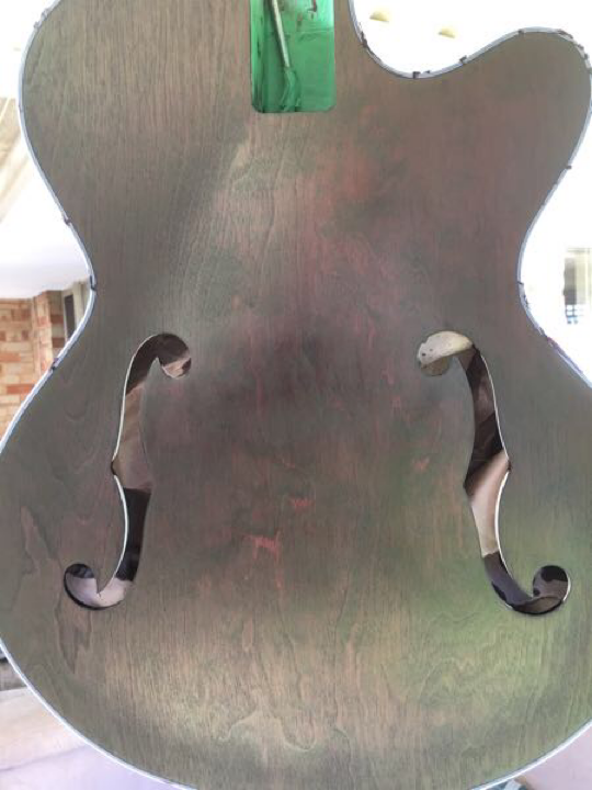

    Two coats of mahogany.

    I was scraping binding last night (The masking had done it’s job well) when I noticed the tide line? On the middle side of the right f hole. So I re-masked the binding, wiped the face with metho and re-stained this morning before work. Looks much more even. However, a lot more stain got onto the binding this time. The price I pay for not getting it right the first time.

    No Drew, I’m a patient man with a blade and a steady hand. It will be coming off. I think it’s oil based? Cleans up with methylated spirits.

    I did a little experiment this time before I stained. I used a cotton bud to give the binding a coat of wipe on poly before I finished sanding. Apart from one little slip around an f hole I was able to keep it of the wood. I’ve still got stain in some larger binding cracks, but it doesn’t seem to of bleed into the smaller hairline cracks like I’ve seen before. Then again the binding might just be in better condition and I’m just kidding myself.

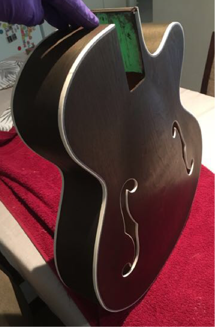

    After several hours the scraping is done.
