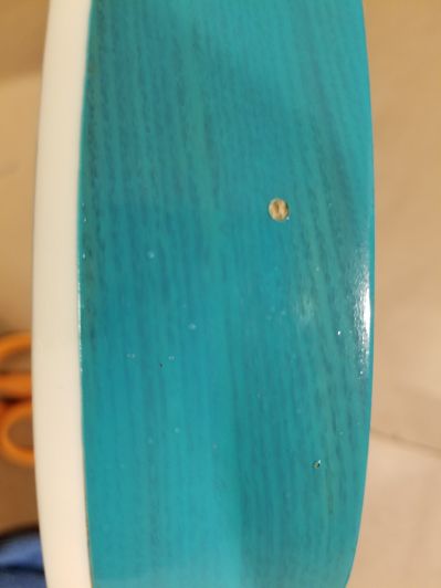

Well... the deed is done. Glued in the neck. Cleaned up all seepage as she sat all clamped up. Once the nut is filed and set up, I think the action will be good. The MusicMan Humbucker bridge pup is a bit wider than the string spacing. Maybe been placed too far off the bridge. I positioned center, and shimmied the pup towards the E string. The G string sits a bit off center of the pole. 24 hour wait. Then clear coat when the weather allows.
I still used a laser level. Found that it confirmed my indecision's. I did go thru and mount my E and G tuners, measured 34 inches from inside nut to 3/4 FORWARD bridge travel on the G string saddle. I strung line down across the neck, bridge. I'll add I purchased the KSM Full Contact Foundation bridge, clamped down, and measured, measured and measured. Clamps move, strings pull stuff out of line to be sure. My hope is I'm good.
I did drill my bridge saddle screws in today.
Is it me or is the hook on the neck upside down or is it a pseudo lefty?
