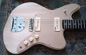

    Another progress shot.
    Still waiting for a toggle switch in order to finish first electricals.
    cheers, Mark.

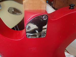

  3. #83
    O.K. Now where did I put those strings?
    cheers, Mark.

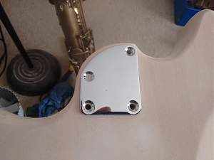

    So I broke the high E yet again (from the no-name set included in the kit) so not the full range.
    I guess I've satisfied the initial test.
    So I'll probably fit the bridge ferrules as the tremolo won't work without the rocking bridge.
    Timely as I saw a youtube hint about tightening the tremolo arm up a tad.
    cheers, Mark.

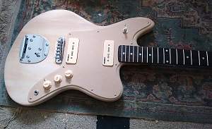

  5. #85
    It's on a holding pattern.
    Re-routed some of the tremolo cavity, and re-fitted the tremolo.
    Decided to fit decent strings and 'play it in'.
    Tremolo doesn't work. Bridge is probably too low and not 'rocking' on the 2 bridge screws.
    If I screw them in it only raises the action so I'll probably have to shim the neck.
    Time to put it to one side (except for the playing part) and get on with other projects.
    cheers, Mark.
  6. #86
    Better to find these bugs now I suppose. It's looking good. I have zero experience with those bridges/trems so can't help with any advice there.
  7. #87
    It's looking good.
    Thanks SM. I'm quite happy with the way it's turned out so far in that department.
    I get the impression you are not alone.
    Think I'll drop into Music Junction and see if I can get a hands-on impression of the real Jazzmaster and see if I can work out what's up.
    Could be just the cheap Chinese tremolo, but there's not a lot to them.
    edit: Actually it's easy to bend the strings up (pulling up on the arm) but doing the down meets with strong resistance.
    cheers, Mark.
  8. #88
    2,824
    Could the underside of the trem mechanism be hitting the side of the cavity rout
  9. #89
    Hi Dave. Thanks, I'll check it out.
    I had to deepen the side where the bar is inserted as I hadn't taken that into account beforehand.
    Still...live and learn eh?
    cheers, Mark.

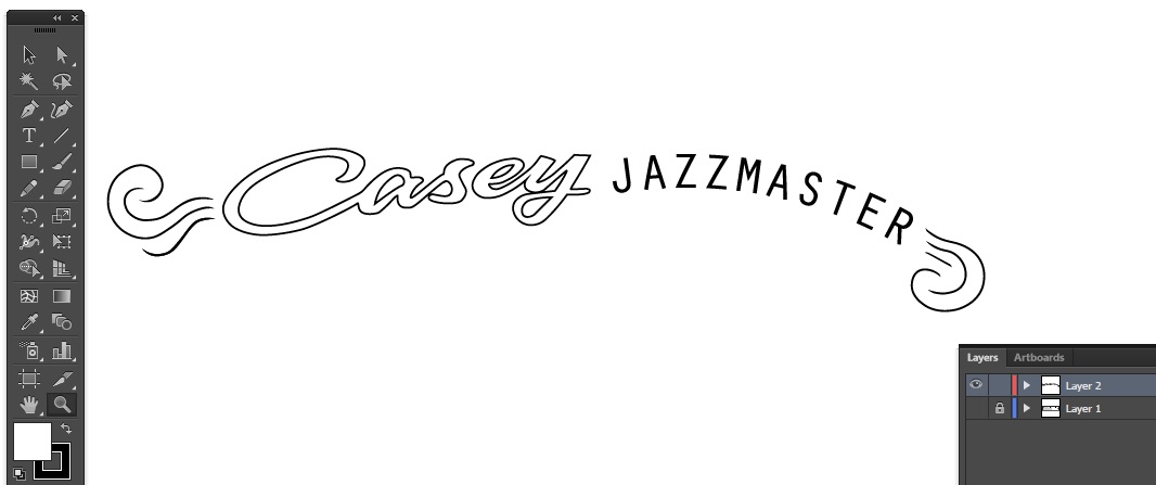

    Decided to re-visit the Adobe Illustrator learning curve and refined the headstock logo.
Name:	Casey Jazz update.jpg
    cheers, Mark.
