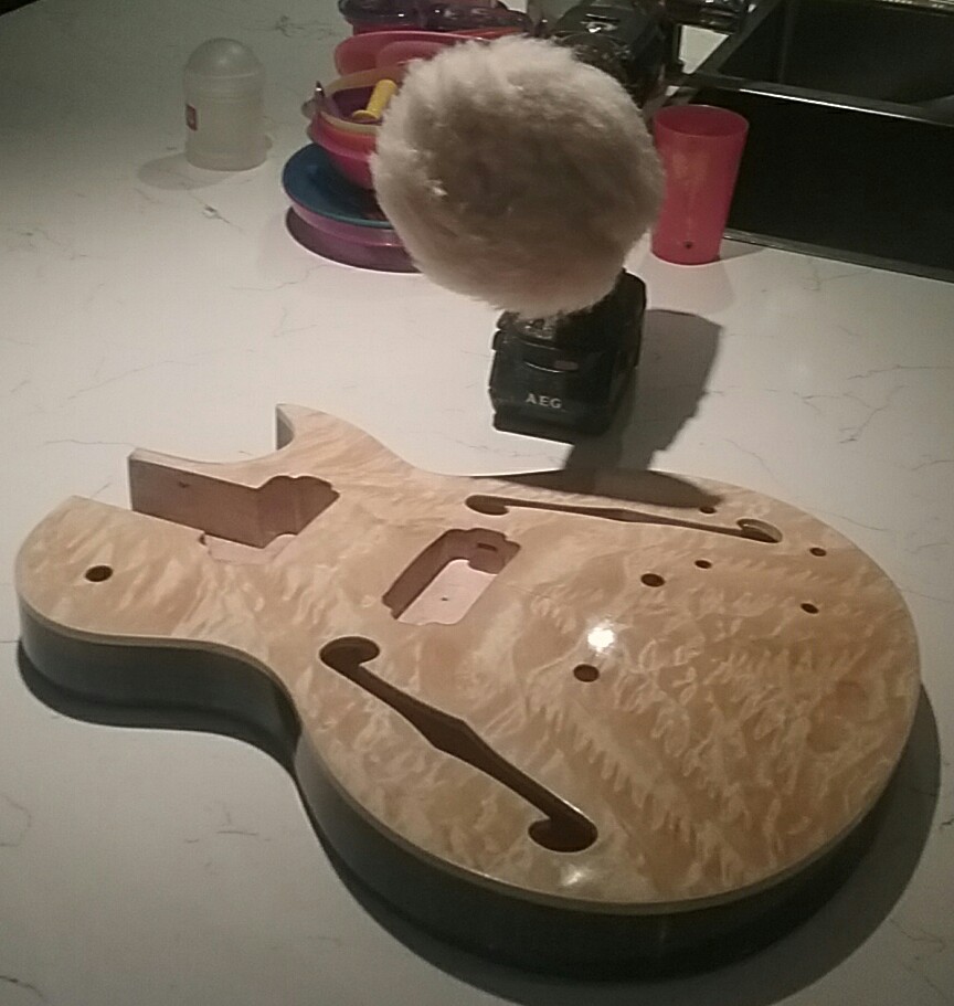

    To get a truly glassy finish, you are going to need to sand back enough to get rid of the 'orange peel' on the surface. You can see it where the light is reflecting on the top corner of the neck pocket. Not sure whether buffing with a pad will do that - or else it will take a very long time indeed to do so. Look at the surface against a light at a shallow angle, which is the best way to show up imperfections in the finish.
    But having never used TO, I don't know exactly how flat and shiny you can get it. But I'm sure you'll get there.

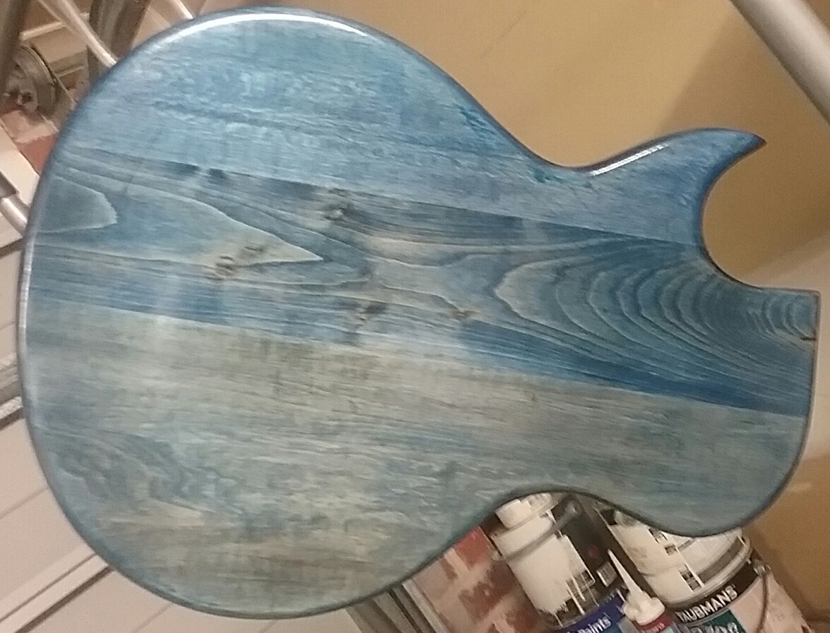

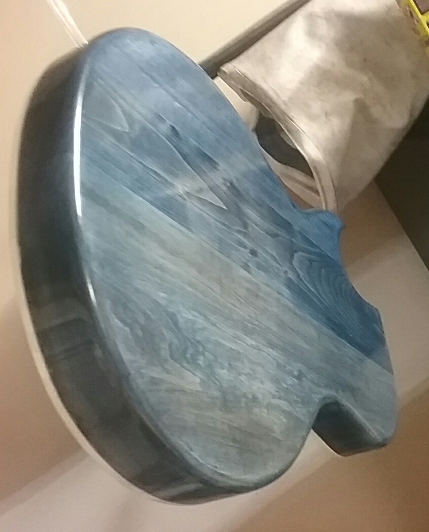

  3. #83
    Mentor Adam Barnes's Avatar
    Feb 2017
    norah head nsw
    613
ID:	21085Click image for larger version.
ID:	21086Click image for larger version.
    Another coat that will do on the back and sides, ill give the top another tomorrow but its very close to right

  5. #85
    Mentor Kick's Avatar
    Feb 2017
    Amsterdam, The Netherlands
    823
    I'd like it more if the blue would be a little darker. The top is great!

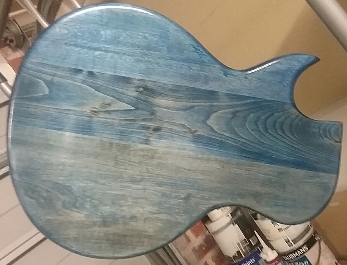

    Feb 2017
    norah head nsw
    613
    Just gave it a wet sand and thought id see what happened with this, its a little bit shiny
  7. #87
    Hmmm, very shiny indeed.

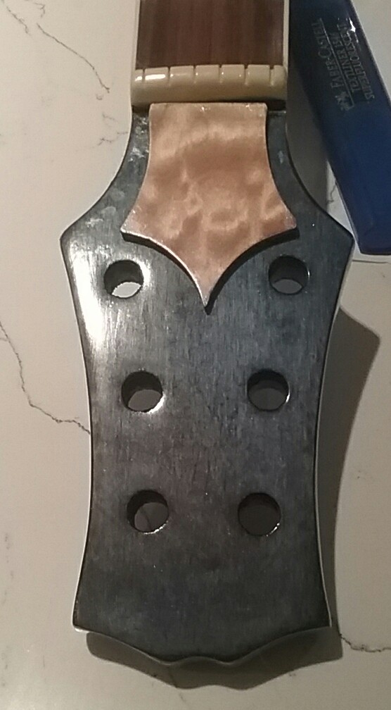

    With or without 2nd peice
  9. #89
    one piece for me.
  10. #90
    I'd say with, ideally if you can inlay it. It obviously doesn't need to be as thick as the truss rod cover, and the thinner the better if you don't want to inlay it.
