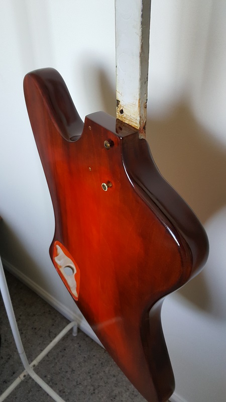

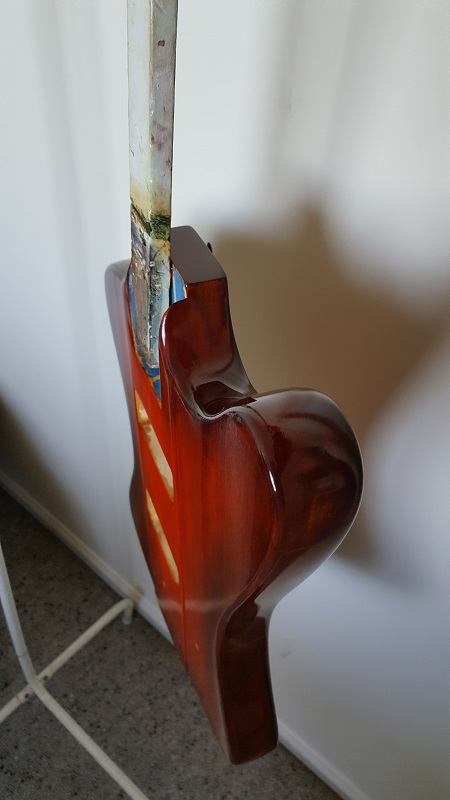

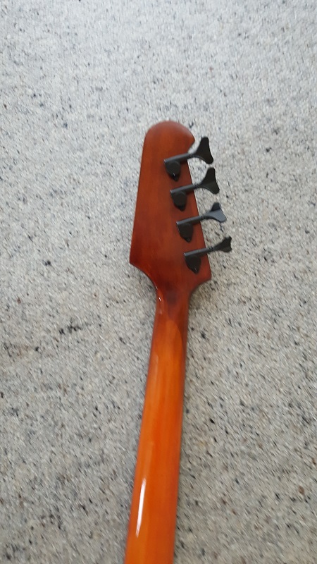

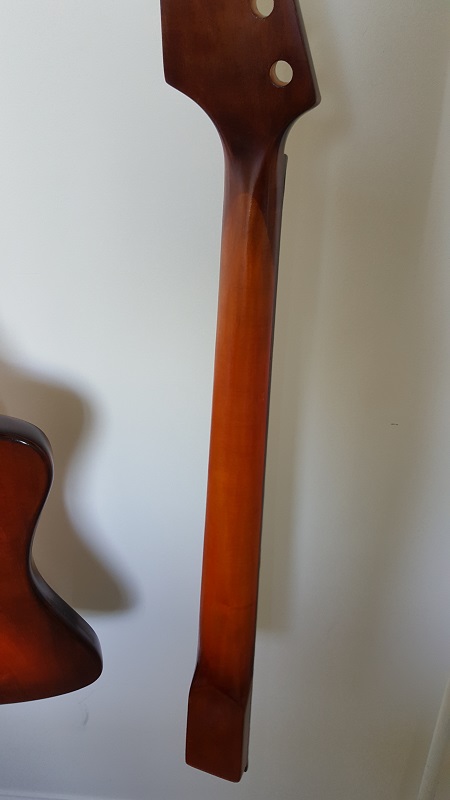

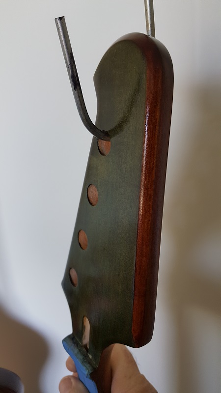

    Back to it again.
    Waz....yeah I was surprised too. I had done 9 coats of poly and 6 coats of tru oil respectively.
    Today after a restain where needed.... done yesterday....and the required sand to 240 grit.....first soak coat of Tru Oil reapplied.....wiped as much into it in the bare places and then wiped any excess off. Final strokes with the grain. I am liking the shine at the first coat.

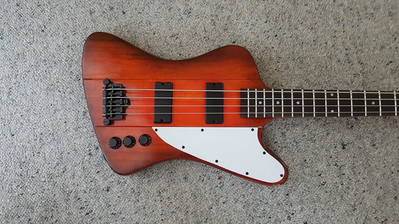

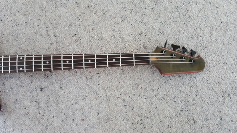

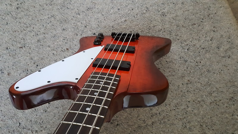

    All together now.
    Many things have been occurring...job hunting...still.
    When you can't sleep and it is 0300 am what do you do? You get out of bed...do a fret levelling....neck to body fit and string your bass.
    This "Thunderbird" style kit ( ) has been so much fun to build and was the best quality starting point of any PBG kit I have made so far. Well done to Ads for sourcing them...and well done to the factory for making some good stuff.
    I do have a router...Aldi one....but I have not had any practice yet....so the control cavity turned out to be too tiny for four great big GOTOH pots......so I made a new wiring harness using all the original bits...even the green capacitor. (Oh...the kit had 2 x B capacitors and 1 x A capacitor...so I swapped one B out so I had 2 x A for the volumes and the single B for the Tone.)
    The control cavity cover was cut, drilled and countersunk in mirror image....so no shiny side out....but it is against my tubby belly so who cares. Yes...fully shielded of course and so is the nice shiny front side of the control cavity cover that is now facing inwards.
    The three point bridge is so hard to set the string height on. I have the neck now wedged with 2 x pieces of business card under the front of the neck lifting the headstock and lowering the strings down. Works and the string height is spot on.
    The pickups come wired for splitting with red and black, silver and green wires in them. I soldered them in pairs and just used them as a single humbucker. Whilst not as thumping as active pickups these sound nice for chinese ones. I may chase some Seymour Duncan Soapbar Basslines I think.
    Left to do is the fitting of PABLOPEPPERS great truss rod cover...thanks again.
    And the printing and sticking of this Guitars Logo on the pickguard...."The Downunder Bird"....an Emu...slightly stylized of course.
    Love making this one and need to drift back to the BG-46 and finish her off now.
    Changed....control knobs to Bell type ones and nut to a graphite nut...input jack to switchcraft....jack socket to recessed Tele style one....sorry WAZKELLY I left it with the lip on the surface and did not recess it right in. Love the look though. I have straplock connectors to go on....black to match the other metal.
