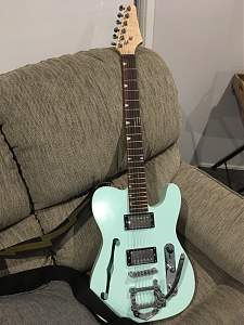

    Life has been hectic so the poor old guitar project took a back seat, but I had a few hours today to bang her together in the hope of using her for our New Years Eve gig...

    It’s not 100% perfect but when I get time I’ll go back and make it so, but spare time is super rare at the moment so I have to make do. The two main problems are (I’ve never owned a bigsby style tremolo before so I could be wrong) the tremolo arm seems to sit pretty high so I’ll probably get a shorter spring. The other problem is I replaced the nut with a Graphtech one and the strings hit the first fret, even with the action at twice what I would normally run at. I didn’t take any off the bottom of it before installing so I’m a bit bummed but I’m sure I’ll be able to work out a shim to get it to a more suitable height. It’s not too bad, the strings just rattle a little on open strings, so I’ll still use it for a song or two, I’ll just make sure the songs have no open chords
    Anyway, thanks for looking and have a safe new year...

    I had that problem on my JMA kit. I ended up shimming it with a bit of street sweeper wire and then eventually filing a very small amount off to bring it back down a bit. It's great where it is now.
    It's turned out nice. I think the "bigsby" sits a bit high because it needs the clearance over the knobs. I got this model as well. It's been my main guitar for the last few years.
