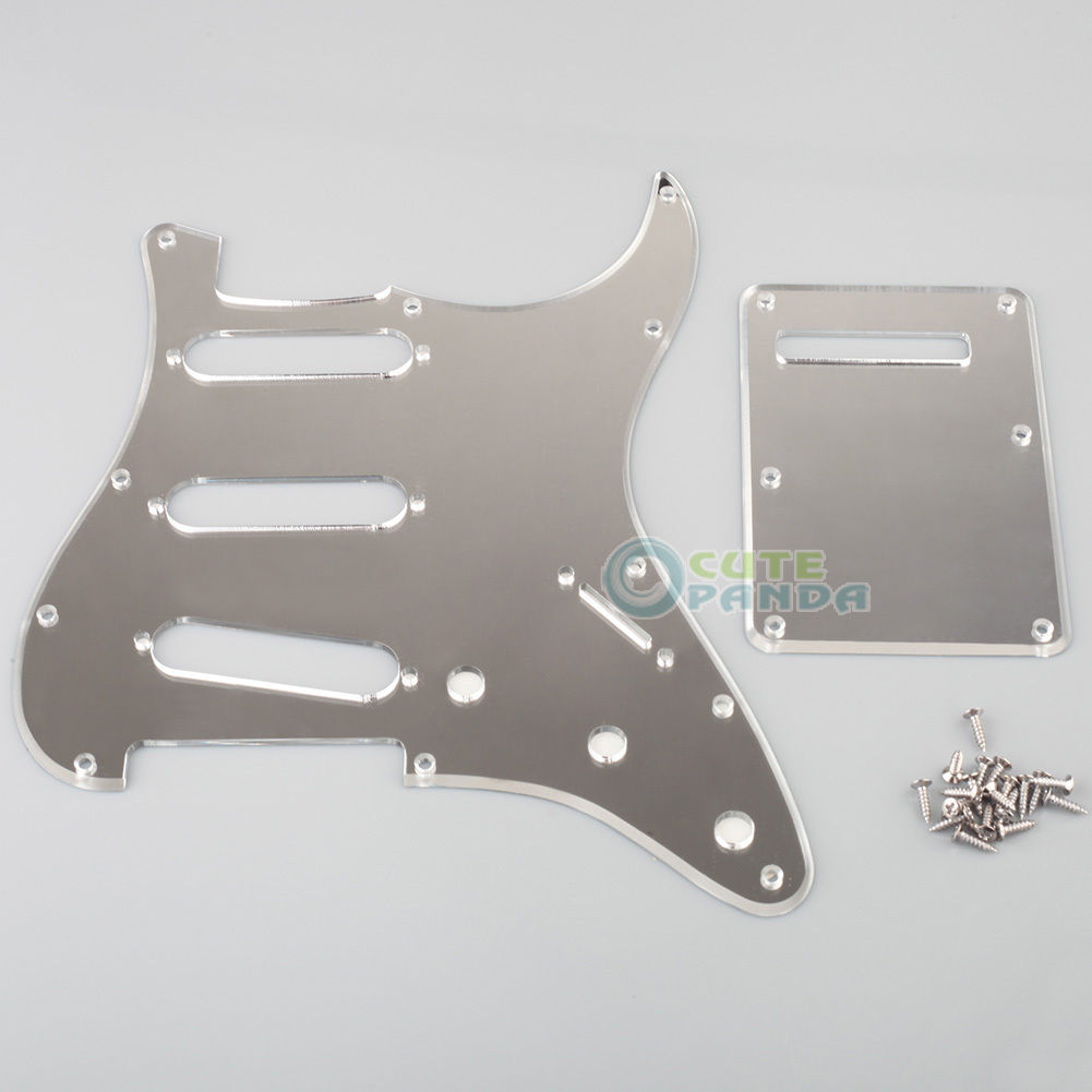

    Hi Sarge, the white one might be ok as that would match the binding but suggest having a look at these mirror ones....Pablopepper who is based in Brisvegas might be able to make a custom one for you?
    http://www.ebay.com.au/itm/1-Ply-11-...wAAOSwgQ9VvHBI

    Thanks Waz. Someone else on Facebook suggested the mirror pick guards. I was kinda hoping to get the chrome option (if it exists or if I go so far to make one) engraved to fancy it up a little bit.
