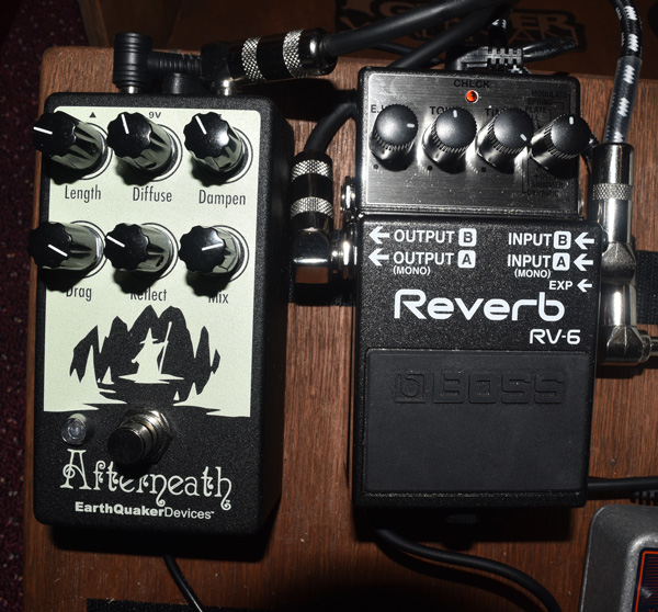

    some folks stack gain pedals....not here

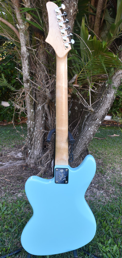

    OK, some unforeseen and some unfortunate and fortunate things happened today.
    On looking at that head stock again I asked what the hell they put in my coffee that day. So I decided to use the neck off the community prototype strat instead. ( I was planning on giving the strat to a mate for his first guitar after switching out the pick ups and he said he would have preferred a rosewood neck anyway). So I unbolted the Strat neck and laid it on the bench next to the kit neck.....wtf? its an inch longer. Yup the JM actually had the shorter scale neck. Hmmm me thinks and quickly dummies the guitar up and measures bridge position, perfect with the strat neck not so good with the supplied shorter neck. At this point I also noticed that you could drive a truck under the strings no matter which neck was in place. Because they use a Gibson style bridge it sits a lot higher but there is no change in break angle (just like no change in position with the shorter neck). I delaminated some ply and used one layer for a about a 3mm shim and glued it into the neck pocket which lifted the neck and gave a much better string clearance. I also made a handy testing tool for Gibson type bridges and tail pieces, I took a set of spare bushings and filed all the striations/grooves off the sides so they slip into the holes but don't grip so you can pull them out easy with pliers.
    That was today's adventures, remember kids always bring a towel!

    Almost done but close enough to call finished . Just needs intonating and strap buttons, I also put a small chip in the paint on the edge of the neck cavity that needs touching up.
    Thanks again to Pabs for the custom shaped clear pick guard and RW Promotions for the reversed sticker on the back of it.
    Might cut a coil or 2 out of the Chinsby spring as it sits a bit too high.
    What does it sound like? no idea, ask me tomorrow, it passes the tap test but I haven't plugged it in yet.
    Attachment 19736
    Attachment 19737

    hey Dedman, another sweet guitar. you build yours guitars so well. jealous much? yes i am. lol
    i have one question i notice you put different stickers on your guitars on the head of the neck. do you make them or buy them?

    I make them brokin. This one I printed in reverse (laser printer) onto greaseproof paper (from the kitchen) then ironed it on. This only works going onto bare timber. Others I've had printed either as stickers or waterslide decals
