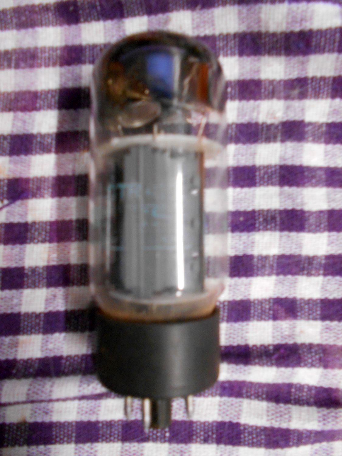

    Here's a closeup shot of one of the 6L6 power tubes from my Fender Super Twin amp, from what I can make out by looking at it through a magnifying glass, it says "STR415 Mesa Engineering" on the glass envelope:

    What does seem a little strange is that the glass envelope seems to be a bit shorter than most of the 6L6 tubes I've seen on the internet.

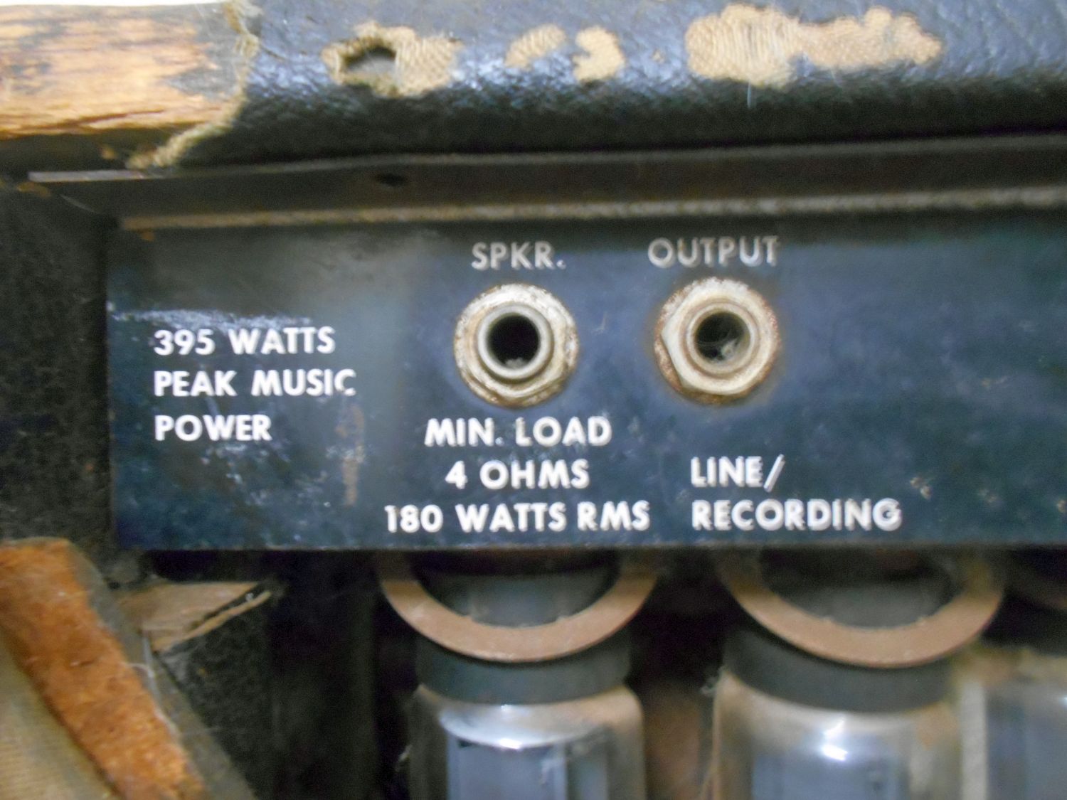

    Here's a closeup shot of the Fender Super Twin's back panel where the speaker out socket is located:
Name:	Super Twin Speaker Out_resized.jpg
    That socket labeled "Line/Recording" is going to be useful since I can connect a D.I. box up to it and send a signal out to a P.A. mixing desk in a live band scenario.

    For their plate dissipation 6L6's are quite a short tube, and EL34's are quite long.
    I've never had much faith in the "line/recording" socket on most amps. Mostly as so much depends on the volume level that is being used on the amp at the time you want to pull a signal from that socket. If the guitarist cranks the amp you get heaps of level, maybe too much, and if the guitarist winds things back then the console operator is hunting for gain on their desk due to the piddly tiny signal from the socket all while screaming out for their SM57. They can work but success can be hit or miss...

    Also there's no speaker emulation, so unless you keep things clean (and use a fair bit of EQ on the desk), any overdrive or distortion is going to sound very fizzy indeed, as you don't have the natural low-pass filtering effect of the speakers
    It's probably best used for feeding another amp for more volume that has series effect send and return sockets and plugging it into the return, so it can drive the 2nd amp's power section directly.
    The STR 415 might be a badged Phillips valve (or a copy of), in which case it's specified like a 7581a (35 watts), as opposed to the 6L6 (30W rated) STR-387 also used by Mesa.

    You'll probably do better by simply buying a speaker emulator pedal. As well as a low pass filter to emulate the natural HF roll-off of a 12" speaker, you'd also need to try and emulate the EQ effect of the speaker's frequency dependent impedance curve (which is itself modified by the type of enclosure it's in). The trouble is that a guitar speaker normally has a very steep roll-off typically somewhere between 5kHz -6kHz, but drops by around 20dB and then levels off again (normally just radiations from the centre dome). So a LP filter alone removes too much high-end for realism, so you also need an attenuated (around -20dB) filter bypass path to mix some of that high frequency signal back in again.

    There are plenty of calculators available via Google to work out what you need to make a passive filter to emulate a speaker....
    One I thought might be worth a try is at http://www.calculatoredge.com/electr...low%20pass.htm
    Put in the impedance and number of stages and the calculator does the rest..... 600 ohm for line level or 8 ohm for speaker level, and more stages gives a steeper slope. May not be ideal, plenty to experiment with and worth a try...
