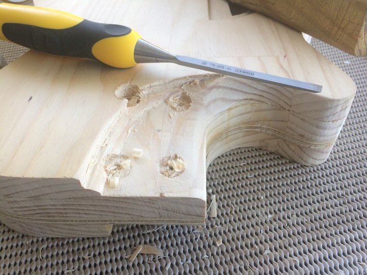

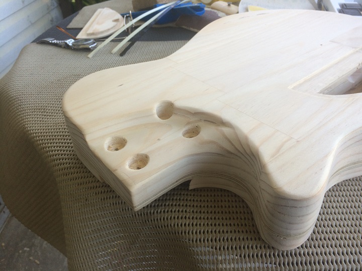

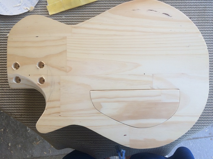

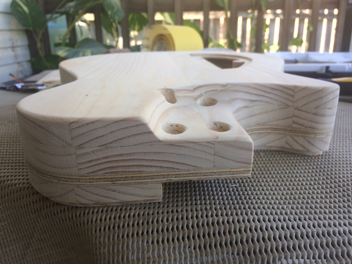

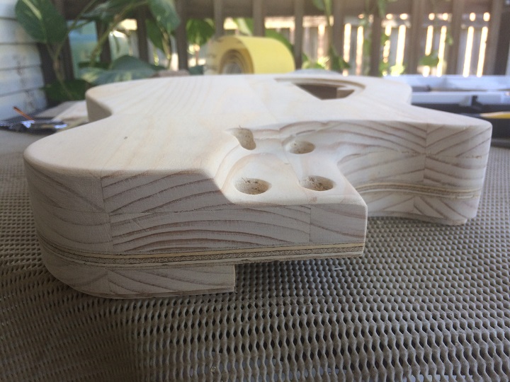

    So the body has now been glued together.
    But it was then that I realised that as the body is much thicker than a standard electric guitar the neck screws I had bought were way to short. I would have to leave the ferrules deeply recessed. Then thought that I would bevel the area behind the neck pocket to give me better access to the higher frets. Then I thought, what the heck, why don’t I just try and shape it a bit. So I did.
    This is where it started. You can see the bevelled area near the ferrule holes.
    This is after I started to get stuck into it with a chisel
    And here it is finished. One of the ferrule holes is still deeply recessed but I wanted to keep the same flowing line from the lower horn but I was restricted by the size of the central core of the guitar. So the ferrule stays recessed and once again a design flaw has been turned into “character”. Lol.

    Love the progress Robin, the way the grain pairs up on the lower horn is very fetching. And also how it seems to complement the curve of your cutaway across the neck heel. Very nice stuff.
