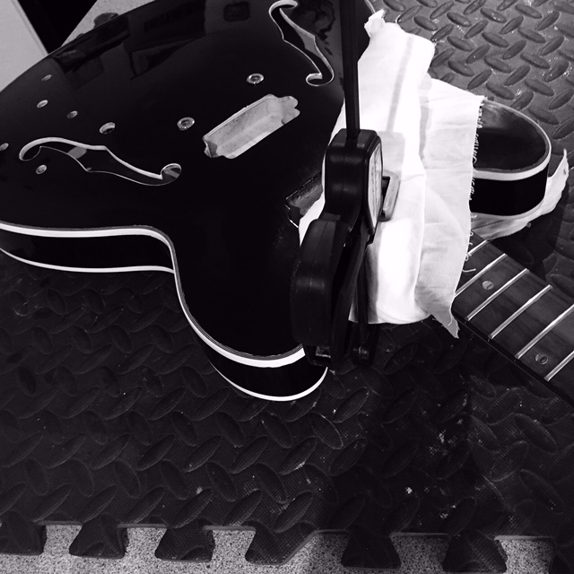

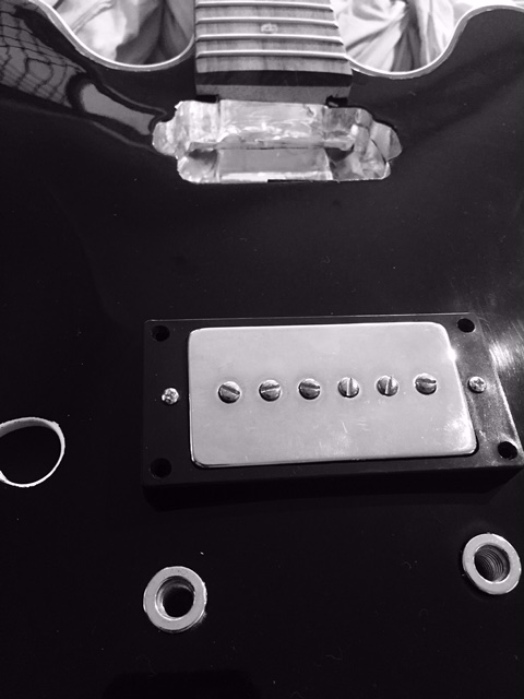

    Finally got into the glueieness of the kingdom of the neck
    and the shielding of the valley of the cavitys

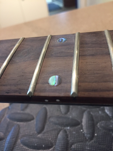

    and the sandiness of the abolone dottage

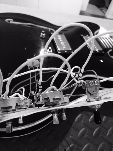

    A couple of steps forward and now quite a few back.
    Got the wiring done, looks like frankenstein.
    Worked fine outside the body. the problem was putting it inside. I used full sized Gotoh pots, which are some of the biggest you can get.....whilst I like them...not the best choice for this build. I ended up snapping some of the solder joins trying to pry them into the guitar and had to resolder. I thought i'd fixed it all but alas, once I had it all in place.....she no work....I must have stuffed a few.
    sooooooooo
    I've ordered CTS mini pots and will rewire the lot.....I'll use the gotohs on another LP copy i got lying around.....twas a good excuse to buy more toneriders....

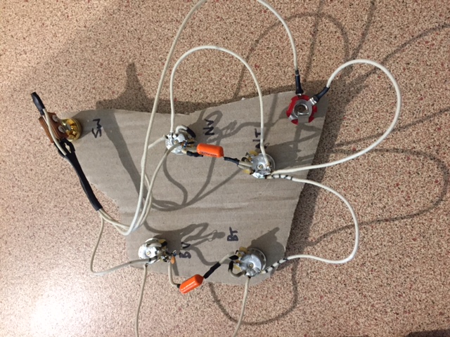

    Update
    Rewired this baby on the weekend. took me 5 solid hours to wire it up and install using Gav tube technique (thanks Gav)
    The mini CTS Audio Pots slide right in!

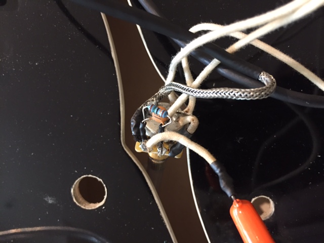

    encountered a bit of a problem, when i was pushing the neck volume knob on, I pushed too hard and busted out the bottom of the pot! had to pull the whole loom out to put the pot back together (that'll learn me). When i was pulling off the neck tone knob to take the loom out i pulled the shaft straight out of the pot! DOH DOH DOH DOH!!!
    One day i'll finish this build.
