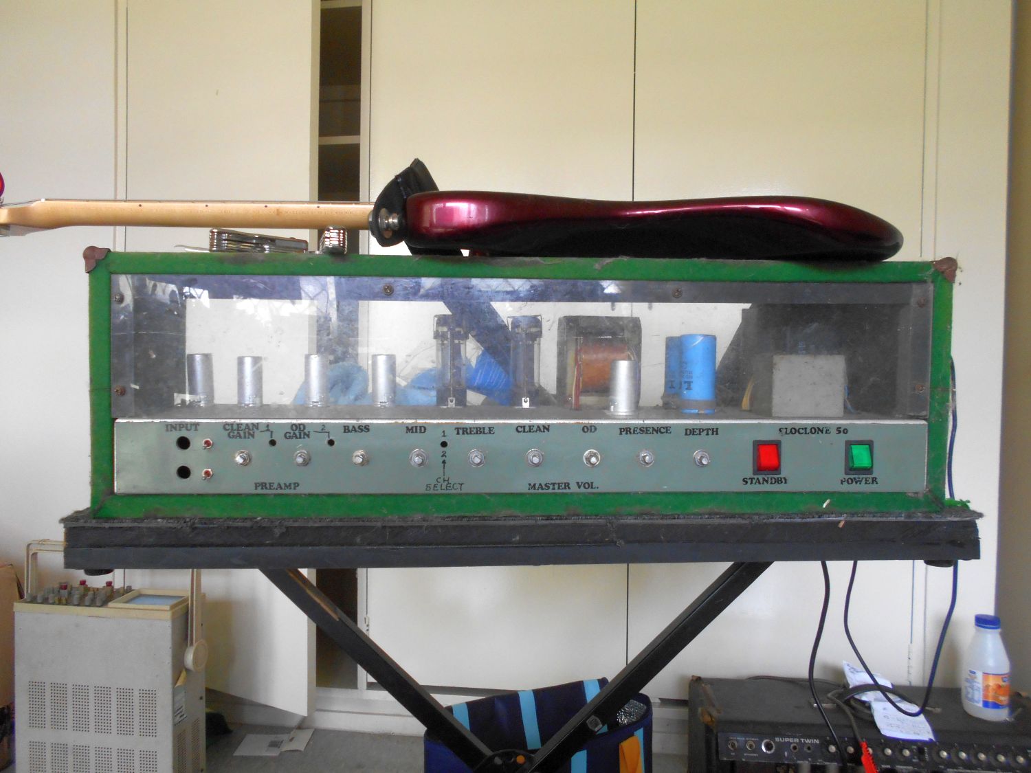

    Update:
    My mate and I are going to see if we can grab the two fridges and washing machine from my old flat today, and while I'm there I'm also going to see if I can grab the Valve head and a small LCD TV that my mate gave me, I'm definitely going to be doing work on rebuilding the Valve head next year, starting possibly around February when I start ordering the necessary parts from Evatco.
    Update 2:
    Okay I've got the DIY Valve head with me at home in my new flat now, some of the green felt covering is crumbling away so I thought that it would be a cool idea to re-cover it in a Tweed Tolex style and add some Fender-style pot knobs, chrome corner protectors, and etc to it.
Name:	The Sloclone 50_resized.jpg
  9. #88
    One thing I definitely need to do is re-do all the front panel labeling, some of the labeling is a bit askew and looks a bit of an eyesore, so it looks like I need to buy some new letraset sheets as well as all the necessary bits and pieces to get the amp re-built, should definitely turn out to be a fun project, I may even see if I can design a special dummy load that'll allow me to record the amp head straight into my DAW software, via the Audio Interface without disturbing my neighbors....silent recording in effect, there's an adjustable line out on the back panel, and I'm thinking of including a passive speaker emulator circuit of some sort so that the line-out signal can be fed to a P.A. system via a D.I. Box and it will sound like the amp is going through a speaker cab through the Front-Of-House P.A. speakers.
    I don't know whether a passive Resistor-Capacitor circuit will work, or a passive Inductor-Capacitor circuit would work better, maybe Marcel might be able to help me out with that.
