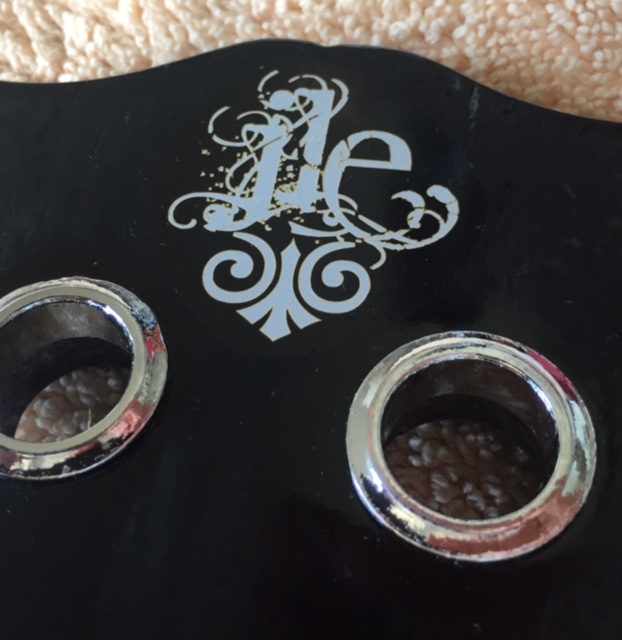

    Finally got my decal on. I may actually get this guitar finished!Click image for larger version.

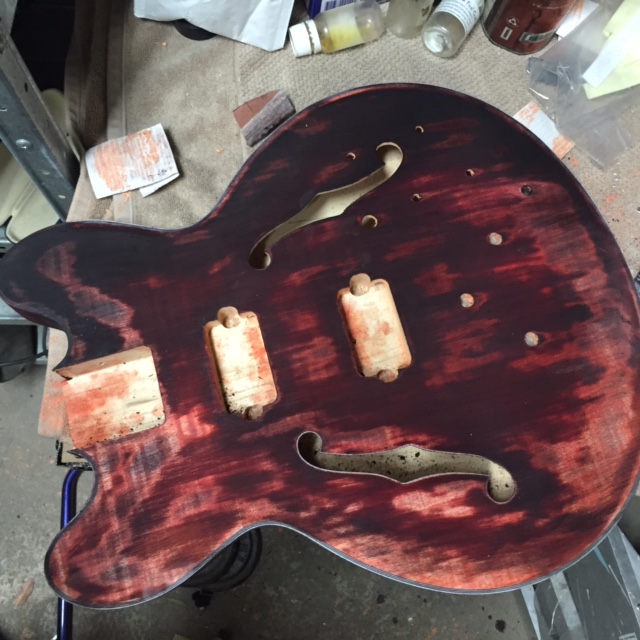

    Quote Originally Posted by darthdamo View Post
    Hey All!
    I haven’t posted for a while because I’ve been rescuing my guitar from the brink of destruction.
    Initially I wasn’t going to post at all because I’m a little embarrassed about how bad things got with my guitar but I also figured that my build might be a good read for those who think they have completely stuffed up their own build and can learn from my mistakes.
    I sanded the top coats back and tried to re-stain with a mahogany colour (feast watson) but as you can see by the pic..epic fail!
    Attachment 7124

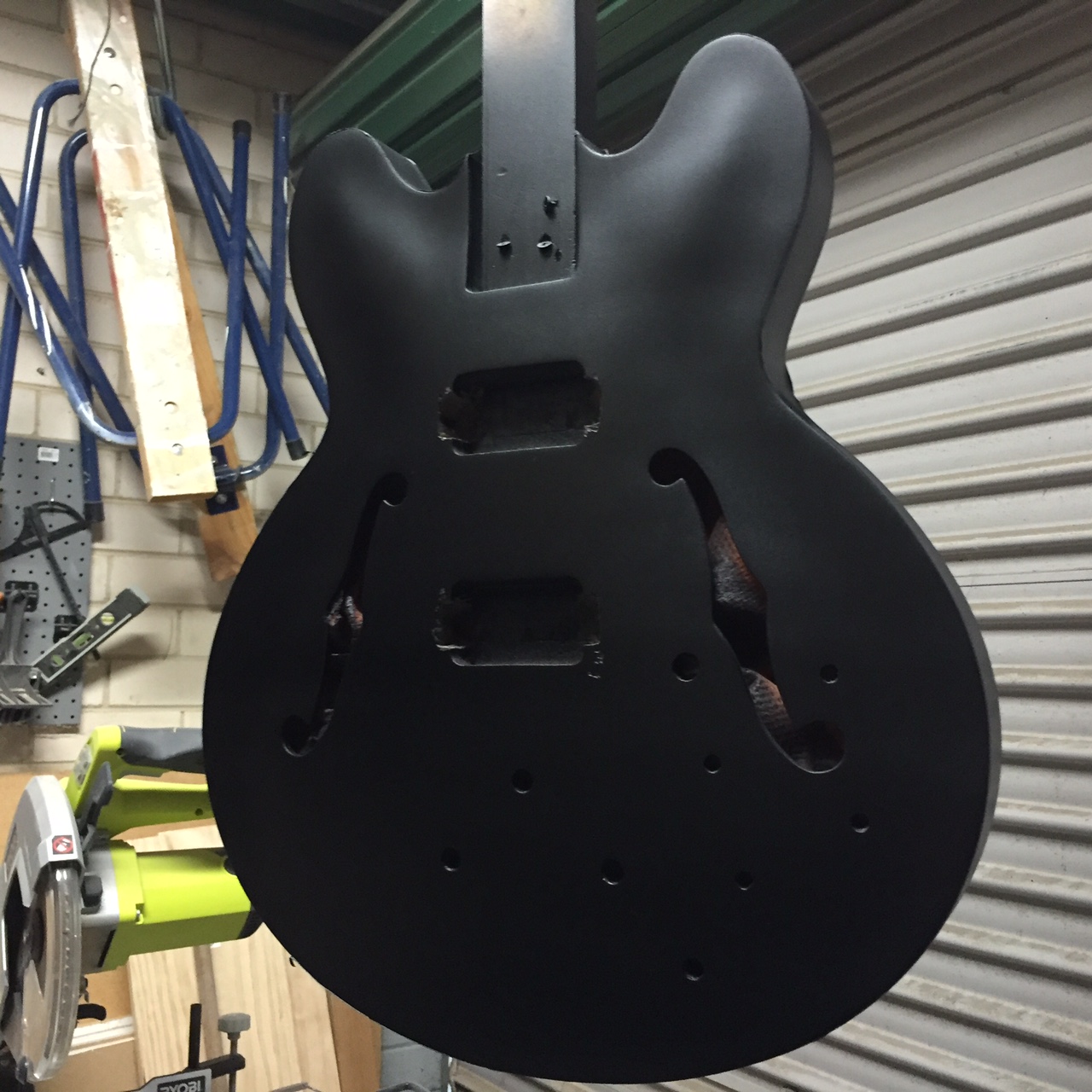

    After much thought I decided that the only way forward was to paint a solid colour because any more sanding and I would’ve ended up with a pile of sawdust and a fretboard. Going back over the guitars I’ve loved over the years black Gibsons have been high on my list. Did a lot of reading and watched many tutorials about rattle/spray can paint jobs.
    Got the body back to a smooth blotch free, stain free place after hours of careful sanding. 3 Base coats using Duramax with extremely light sand in between to get rid of overspray. I ended up with a really smooth even surface to lay down the colour.
    Attachment 7125

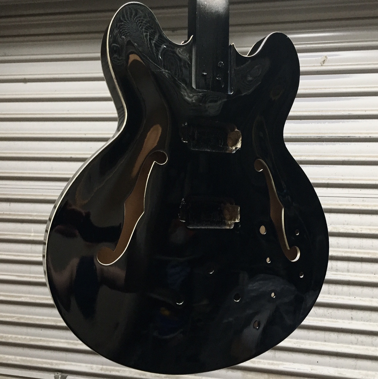

    3 Colour coats using Duramax flat black. I’ve never used this product before but I must say it was super easy and the finish is flawless.
    Attachment 7126
    Onto my 5th coat of Cabots gloss polyurethane and I couldn’t be happier. It's like looking into a mirror! Leaving to cure now and will do cut/polish and assembly after Christmas holidays.
    Attachment 7127
    Dude, if you'd got that any blacker, you would have been pulled across the event horizon. That is some great save work given the problems you'd had.
