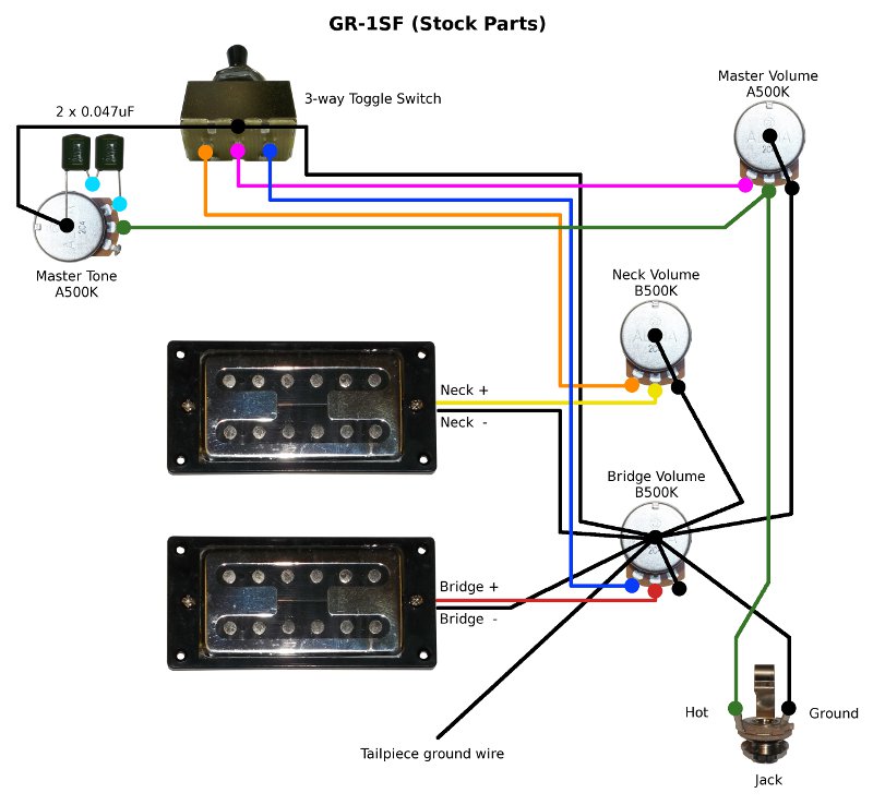

    In the GR-1SF diagram above all the black wires are 'ground' connections and the other colours are all 'hot'. So, linking that to the jack example in my previous post, the green 'hot' would be the inner core and the black 'ground' would be the outer braid.
    The positioning of the components is obviously different on your ESB-4SC, so it will be possible to streamline the layout and wiring connections to better suit your braided wire. If you want I can try drawing up a layout for you that should help with the connections and how to route the braided wire. Let me know.

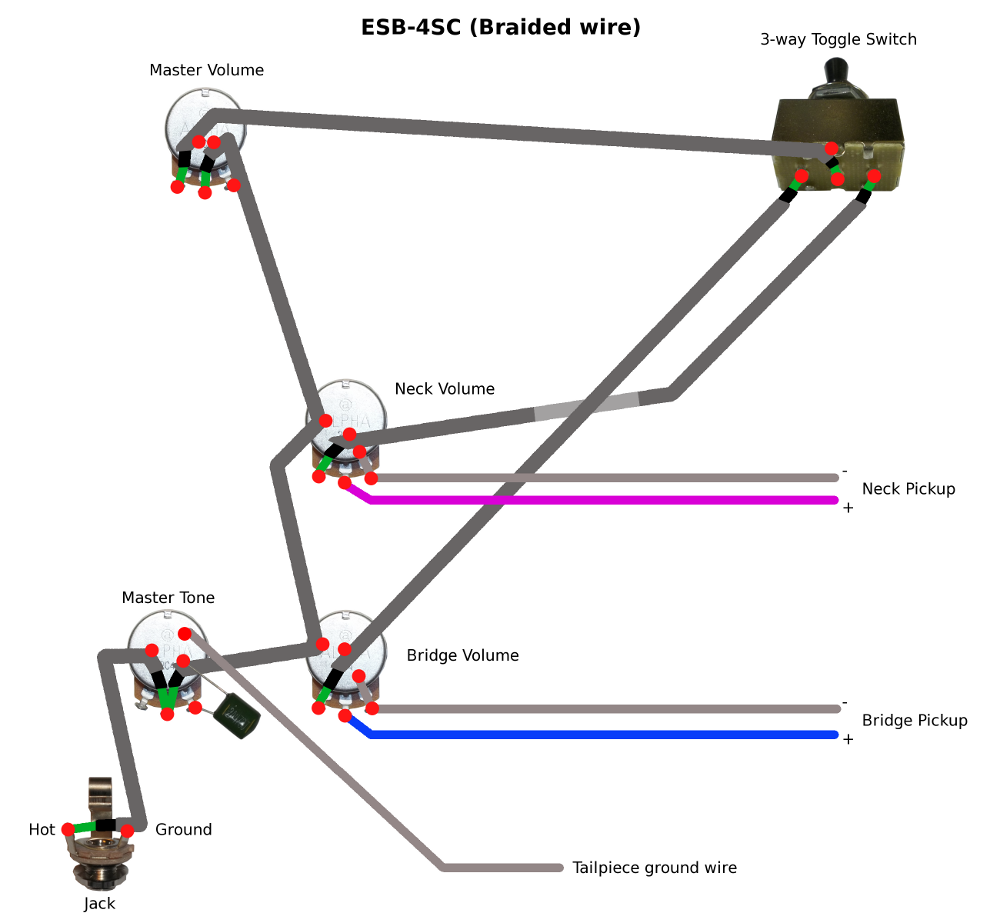

    It's only rough, but hopefully this will work as a guide for your braided wiring (viewed from the back).
    red = solder point
    green = hot core
    black = inner insulation
    dark grey = outer braid
    The braid carries the ground connection from the output jack across the backs of the pots all the way up to the toggle switch. The diagram is configured with independent volumes, like a bass normally is, so when both pickups are on turning down one pickup's volume doesn't affect the other. If you'd rather have it like a guitar with linked volumes (like the GR-1SF diagram), where in the middle position zero volume on one pup mutes both, then connect the pickup hots (+) to the left lug and the green cores to the middle lug.
    Setup a full size cardboard template with accurate positions of the holes and then start wiring it up from there. Remember that you have to feed it all in through one of the cavities, so the wiring needs to be robust enough to withstand it. Connect your pickups last. If you're feeding the harness in through the bridge pup cavity, connect the bridge pickup and then feed the neck pup wire in through its cavity and out through the bridge cavity then connect it. Then feed the harness in, ideally using tubing, and secure it all in place. Don't forget the tailpiece ground wire.
    Good luck and ask any questions.
    Edit: I should mention that in the above diagram the master tone is on the 'out' side of the master volume, which may not suit everyone. If you'd prefer the modern style with the tone on the 'in' side of the volume then you'll need an alternate diagram.

    Hi Scott!
    Thank you so much. That makes so much more sense for me.
    That works for me perfectly! Thank you
    What do you mean by that?
    Bass Player from London, England:
    Current Build ESB-4SC
  8. #88
    Vintage style wiring has the tone after the volume (like my diagram), so on the volume's 'out'. Modern style wiring has the tone before the volume, so on the volume's 'in'. There are pro's and con's for both styles, and some people have a particular preference. Here's a good explanation of the differences, although it's referring to guitars.
    I just wanted to point out how my diagram was configured, so if you wanted modern style wiring then I'll need to draw up another version.

    Weirdbits it took me a little bit to really understand what was going on. i really appreciate your help. I do have a few questions though.
    First obvious question: Is there a reason why the GR-1SF diagram has two caps on the master tone pot and the one you created for me just one?
    Regarding the Vintage Wiring I like the fact there is no treble roll-off when you roll off the volume control but I was wondering if the tone control's effect inconsistency is really noticeable?
    Then again with the modern wiring is the treble roll off when decreasing the volume very noticeable?
    Regarding the tail piece ground. Will the tail screw being in contact with the wire enough to ground it?
