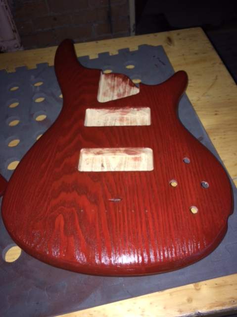

    Intensifying coat #2
    Second intensifying coat applied today.
    Starting to wonder if that's ochre or blood...
    If it dries evenly I think it'll be ready for the top coat (next week).
    - Sam

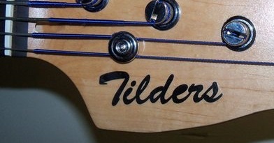

    Headstock decal
    So I've done this thing with previous builds where I make a logo in a style similar to what the guitar is modelled after. For example my fretless jazz...

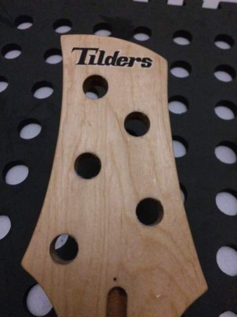

    So this time around, again using waterslide paper:
    It's an IB-5, so it gets an IB style logo.
    I've applied it already, waiting for it to dry before applying the top coat over it.
    Also waiting for the top coat test I did of a couple of decals on a bit of pine to cure and see that it really does seal the decal in.
    - Sam

  4. #84
    I really like that logo. Is that a font or did you draw it? If it's a font, do you mind sharing which one it is?
  5. #85
    Mentor robin's Avatar
    Brisbane
    1,513
    Really looking good Tindrrel, love the colour and the headstock logo.
    rob
  6. #86
    IB font
    A bit of both.
    My attempts to find a proper loadable font mostly just found websites that wanted to install software on my computer.
    I did find this, a guitar fan's attempt at completing the font in the same style.
    Cutting and pasting their letters, creating the T based on looking at other fonts and adding some dabs to join the letters together gave me something in the style I wanted.
    - Sam
