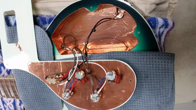

  6. #86

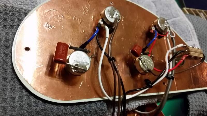

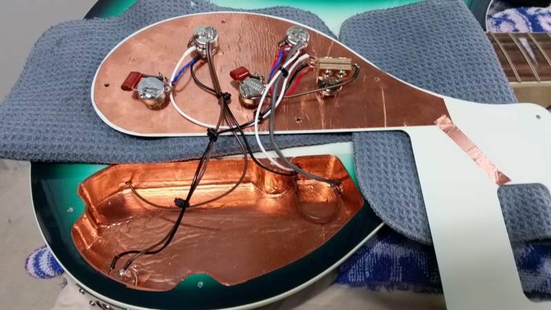

    Slow progress is better than no progress I guess, so have got the shielding and wiring done.

    Haven't used copper tape before, so hope I didn't create any earthing/shielding no-nos. Not been plugged in yet, keeping fingers crossed.
    Still need to check if frets are level and clean up some glue marks on a couple of inlays, then strings can go on.

    If anyone's wiring up one of these, don't follow the previous pics. Took a while to work out why there was no output when I thought all pots were at '10' and all signal was going to ground/earth. Turns out I wired the pots backwards - 10 was 0 - now have it sorted.
    This looks a bit better (actually works)

    Good stuff Grant. Heat shrink makes everything so nice

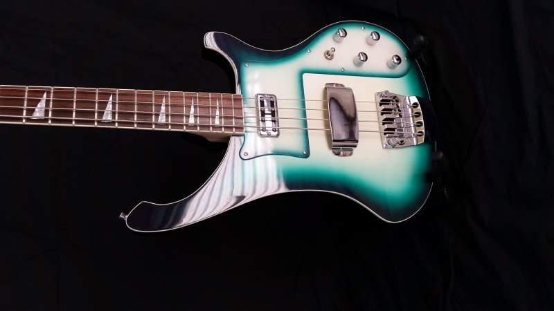

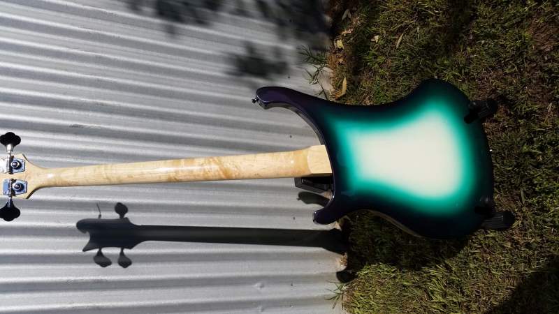

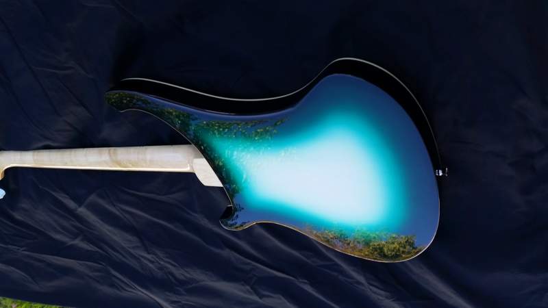

  10. #90
    Thanks Stan and Nick.

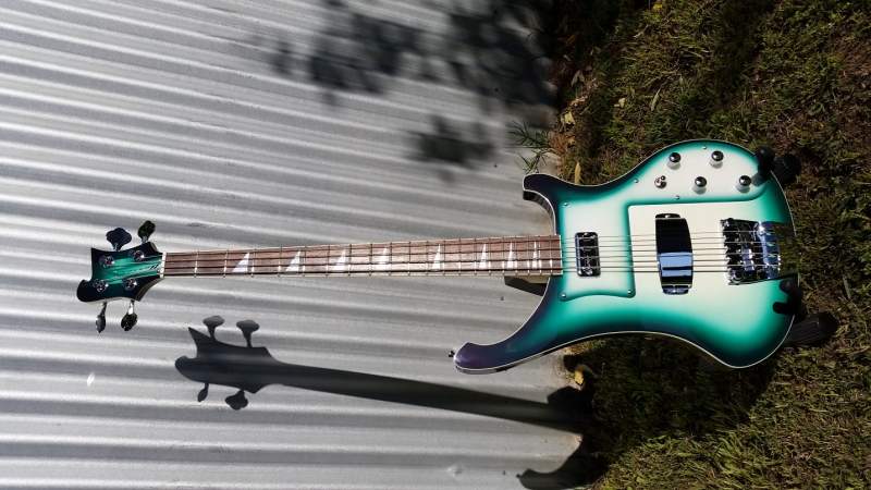

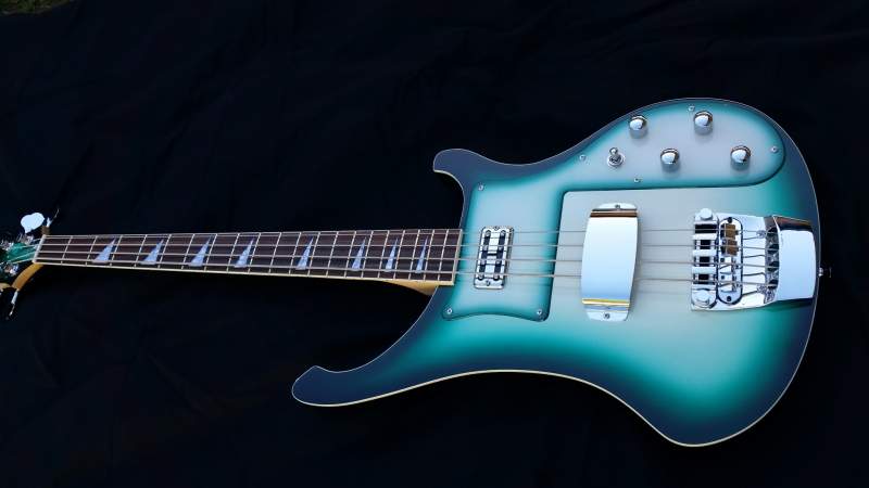

    Had a go at filing a bone nut and now have the strings on. Nut is still a little high but will wait for the neck to settle in before final adjustments. Pics
