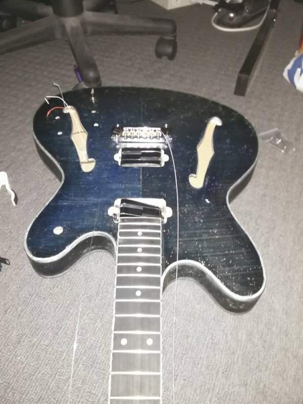

    Build is up and running again - the bridge fits now. It's a little too snug right now, so it's difficult to get the bridge low enough - needs to come down about a mm or two for the action to improve. The bridge is a couple of mm off the body.
    The neck is set. The angle of the neck on the stock kit was a little off meaning the angle near the bridge was way too high., I corrected it with some masking tape (about 3 layers) underneath the neck.
    Going to start working on the circuit now. Seems like it will be four push pull pots, one rotary switch and one kill switch.

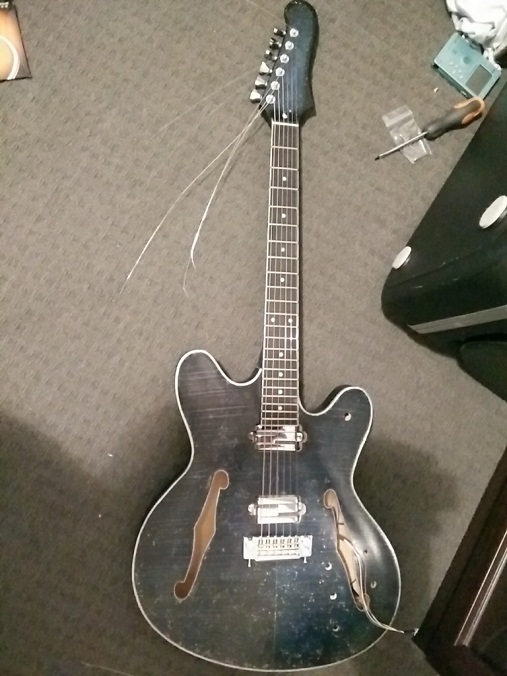

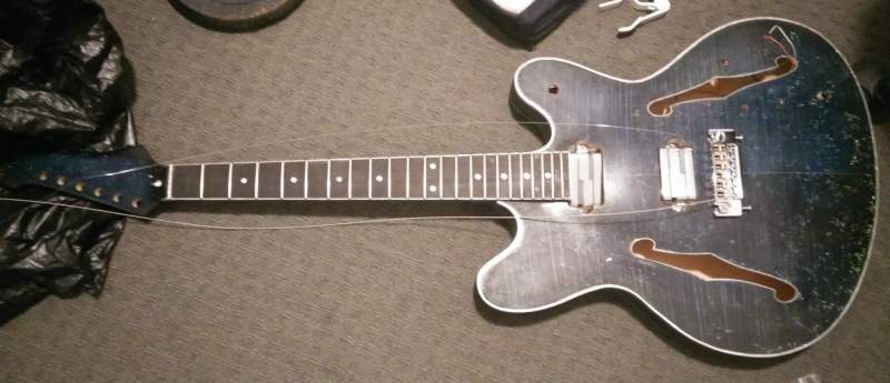

    Some pics of DB's handy work once the bridge is on. Coloured over the dowels or whatever they're called with the blue. You wouldn't know it's there! The colour in the pics is off because that's a yellow light in the background
    Neck set. String action is now great (bridge required a little more persuasion )
    Gotta enlarge the holes - can't find any of my drill bits. Gonna go see wokka if I can for a chat/some help in that regard - buying the bits I need for this one thing is a bit steep.

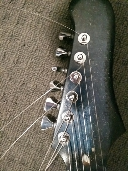

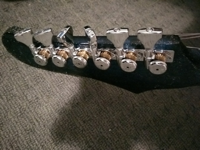

    Couldn't resist the urge to string her up and have a little strum without the electrics when the tuners got here.
    They went on like a dream. It's a nice, mellow sounding guitar as it is now.
    Pablo sent me some wicked pickup surrounds that will go on/in when I sand them to fit. Not long now - just gotta find out how I'm doing the wiring since I can't find the right switches - maybe two rotaries.
    Sorry for the mobile photos, low quality and bad colour. Just had to take some snaps

    Dang fancy tuners!
  9. #89
    wow those tuners do look ultra cool Chris can see the gear mechanism.

  10. #90
    Those tuners look great on it, very nice.
