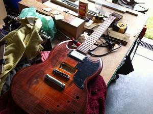

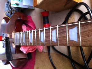

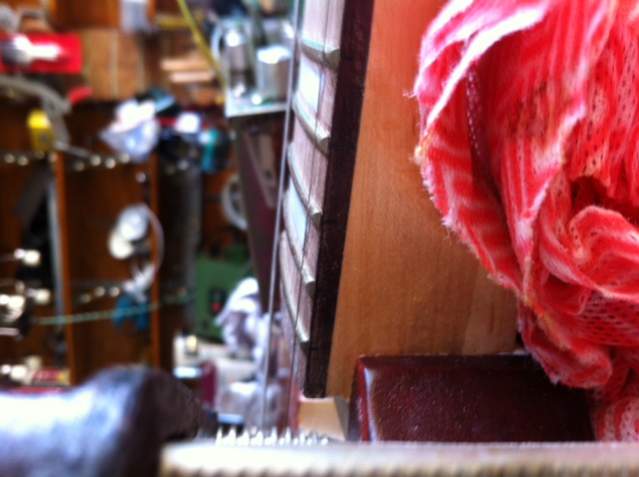

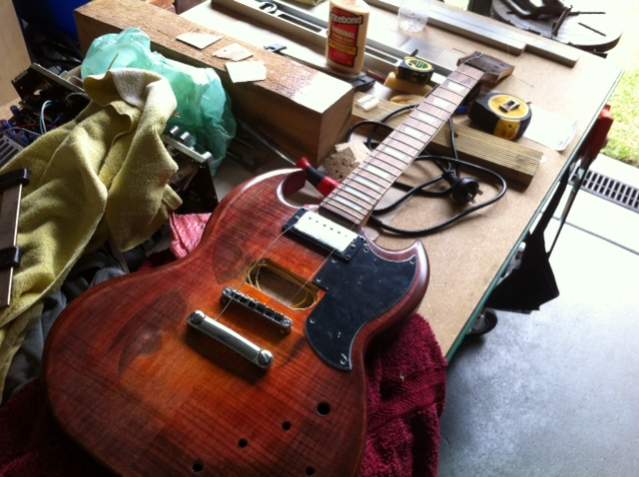

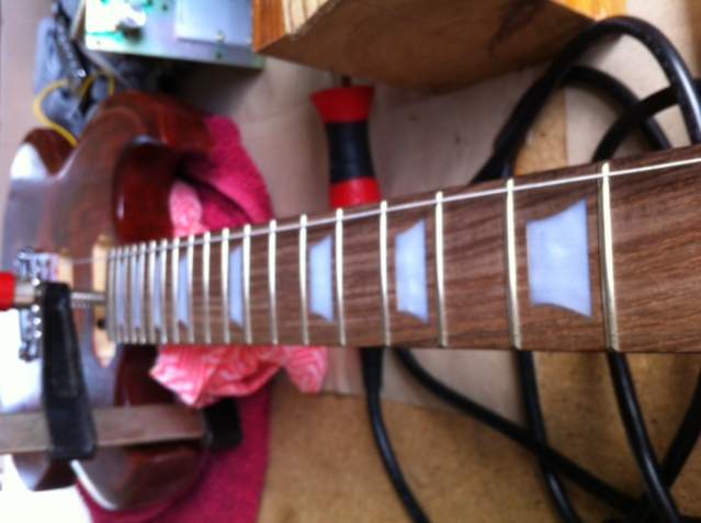

    Thanks again to all also found the glue at Masters and got the Original brand!
    I just glued the shim in and I have glued the neck.
    It was a bit hairy getting the right distance from strings to frets and getting it to be parrallel and I had to kick it out a bit from square from the heel of the neck to the guitar body but I think it worked out pretty well
    I just hope it all sticks O.K. and intonates properly.
    Have attached some pics below - hard to tell whether the neck is correctly positioned but fingers crossed!
    Thanks again Stan
    Alan

  3. #83
    Looking good Alan! Are there both E strings in the pictures? I can't quite tell. I'm sure she'll intonate perfectly. Did you test fit the neck pickup with the neck in position?
    Ga.
  4. #84
    always hard to tell from pics, but your alignment looks good Alan

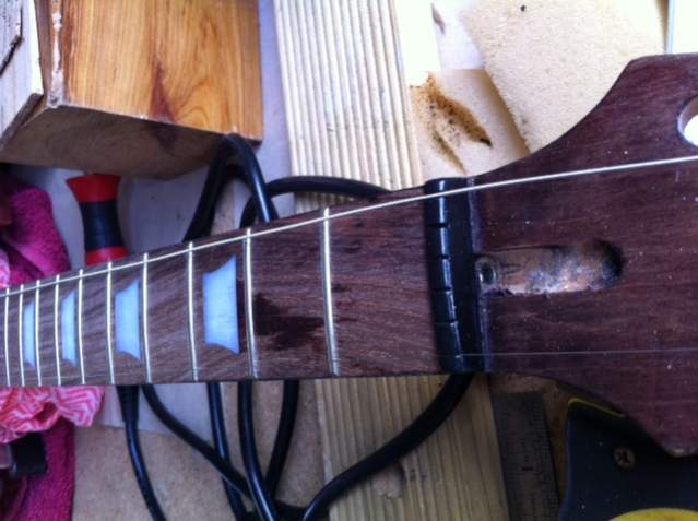

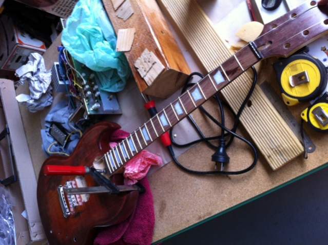

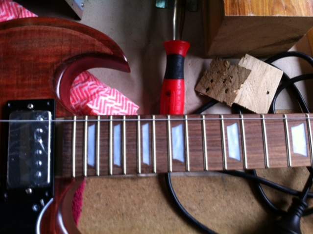

    Hi Stan and Gav,
    I have added a few more pics with pick up in place - I tested it before I did the final neck glueing and I had to shave some off the step up to the fret board because of the packing I put behind the neck base.
    So I think that should be O.K.
    I have got both E strings on but it is hard to see in the pics - they both look parrallel but well inside the edge which seems a bit odd but maybe that is how SG's are?
    I checked the glue today and seems to be stuck pretty well and re-checked the measurements from the bridge to the 12th fret and they maybe slightly longer than the originals but only by about 1/2mm??
    The strings are very close to the frets from the 22nd fret to about the 10th fret and then they tend to move about 1/16th away from the frets near the nut - hopefully that isn't anything to worry about...
    Could you let me know what the next step is - is it the soldering of the pickups and controls?
    Anyway thanks guys - I have only got this far due to you guys, Wokkaboy and all the others
    Alan
  6. #86
    they do look well inside dont they... at worst you might need a new nut... they seem pretty even though, I'd carry on
    If you are done with the finish and the neck is set, I guess it's time for the electrickery bits for sure.
    You've come this far yourself mate, we're just shouting from the sidelines, nice job
  7. #87
    Moderator dingobass's Avatar
    4,491
    It does look like the strings are a tad too far in.
    My 2c worth is to get rid of the plastic rubbish and replace it with a nice bone nut.
    If you grab one of our bone nuts you will find it will solve that problem.
    The slots are also compensated to allow for the string thickness, this makes it a lot more comfortable to play.
    Oh, and of course I must add one of DB's mantras...Bone for Tone!
