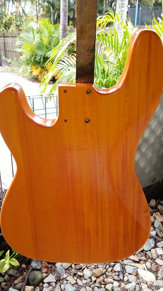

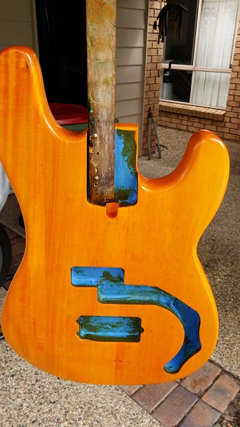

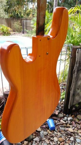

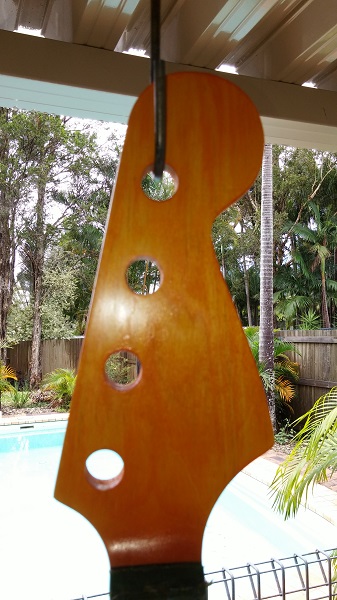

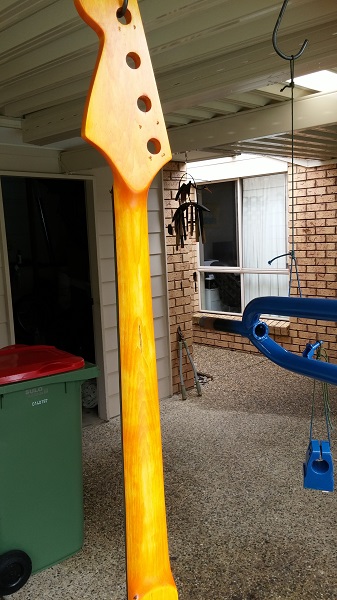

    Yes the above title is true. The neck final coat is seriously finnicky. Guess who put a tad too much on and it ended up looking like the guitar was sweating beads of finish.
    Quick zip with 400 grit and then the very last of the bloodwood stain back over the neck and the save has been made. I hope.
    I will have to work on an approach to apply the final coat.....when you dunk your cloth into the liquid it gets seriosuly wet.....then you wipe it on and the bit you start on gets a thick coat....and you are not supposed to overwork it.....so maybe little bits on a cloth may be the secret.
    The body got a 2nd intensifying coat this morning. In some places where the end grain was really opened up the intensifying coat has soaked in and made the section of grain darker.....I don't mind the look.....but something to be aware of.
    Photos taken as soon as the stain and intensifying coat was applied.
    Night shift tonight.....so they shall hang for a few days....probably til after xmas.
    Merry xmas to all and a happy new year.
    Gyro.

    ....And the front.
    And the last shot of the front.
