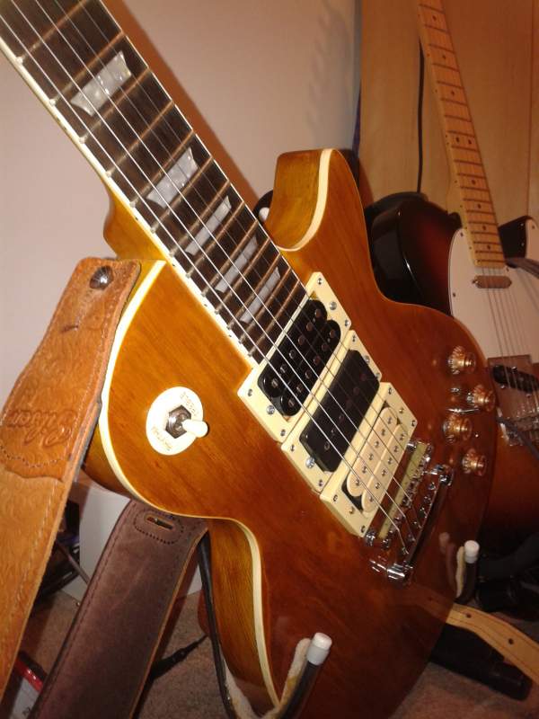

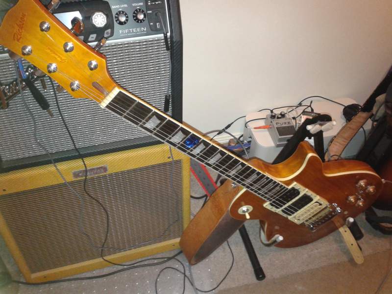

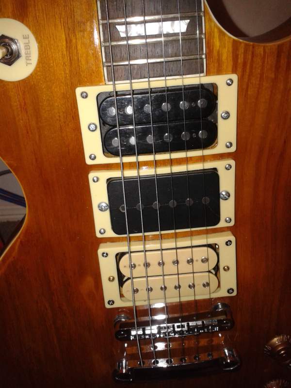

    While adjusting the front pup the spring "pushed"the bolt through and striped the thread. (on the pup mount) Thats what I get for using beat-up pups'. (see photo). When I change the strings I'll fix that.
    Another pic shows that I have changed the middle switch from an on / on, to an on / on / on, this is because I didn't like what the first switch was doing. I wired this up to the Dimarzio to give me three sounds. Parallel, series and single coil in the middle position.
    Not exactly happy with the three pups', don't think I'll be doing this again. The first way I wired it (my way) didn't give me what I wanted so wired it to the book, so it is working the way it should but I don't like it. The reason for 3 pups' is (to my way of thinking) either pup individually, any two together or all three together. This isn't the case here so, I am thinking that I may need to wire the P94 to a separate out put, but I doubt this will happen will get used to the way it is.
    Another problem, which I won't worry about, is the middle pup is as low (in it's cavity) as it will go which happens to be about the correct place so guess it's ok.
    pic #1. Ash, resting in it's sister's bed.
    pic #2. Striped thread on front pup.
    pic #3. New on,on,on switch.
    Rick.

    Have been enjoying playing it but not really having it work the way I wanted, so, today I took the control cavity cover off (almost put it straight back on) what a mess, wires everywhere. Oops! no wire connected to one of the pots, wonder how it got a sound? (strange).
    Anyway sorted everything out, tried, one pickup wasn't working but got that sorted, the volume pot must be a little wacky as a light touch of the knob done the trick (after much trouble shooting) although it just decides to stop every now and then. Should have used the ones I have here, next time I'll drill the holes out before I apply the finish.
    Spent about 3 hours but rewarding as it is now working as I want, each pup or any combination, should have done that first. It's a bit of mucking around because turning pups off with the volume is time consuming,
    All the switches are working, but not happy with the tone switch, I expected more variation, might be just me (deaf) hearing much but it's working. Not that I will use it much I'm sort of a 10 guy.
    The 3 sound switch is working but best when I have just the back pickup alone.
    Fixed the front pickup base so it will hold the screw and spring. first pic if I can figure out how to send them.
