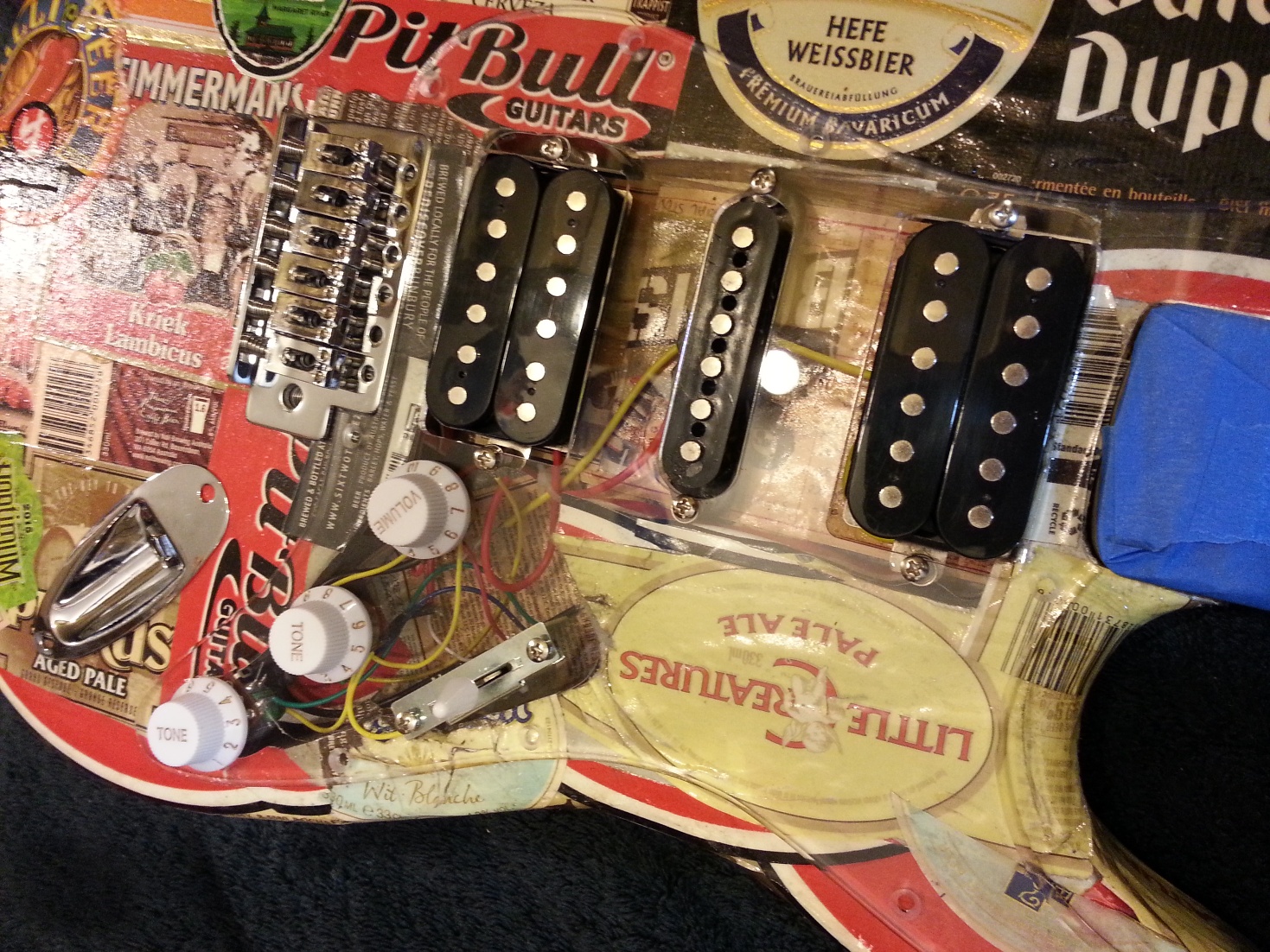

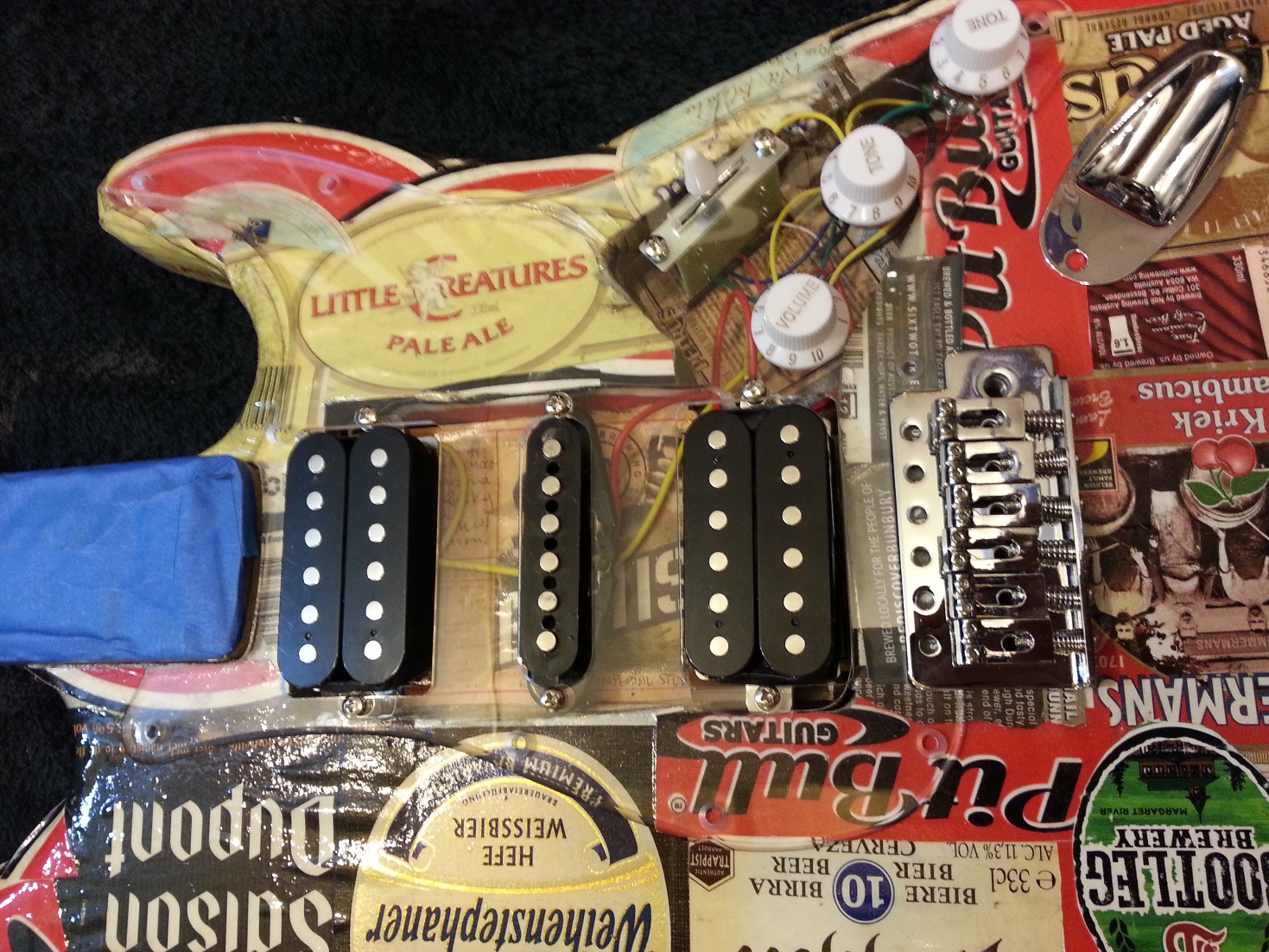

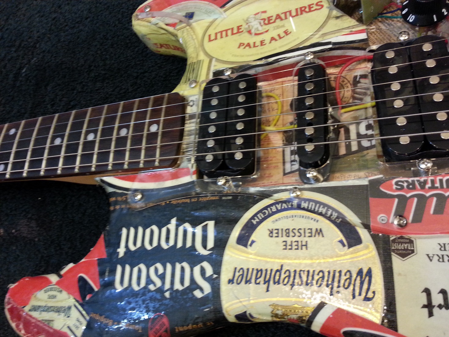

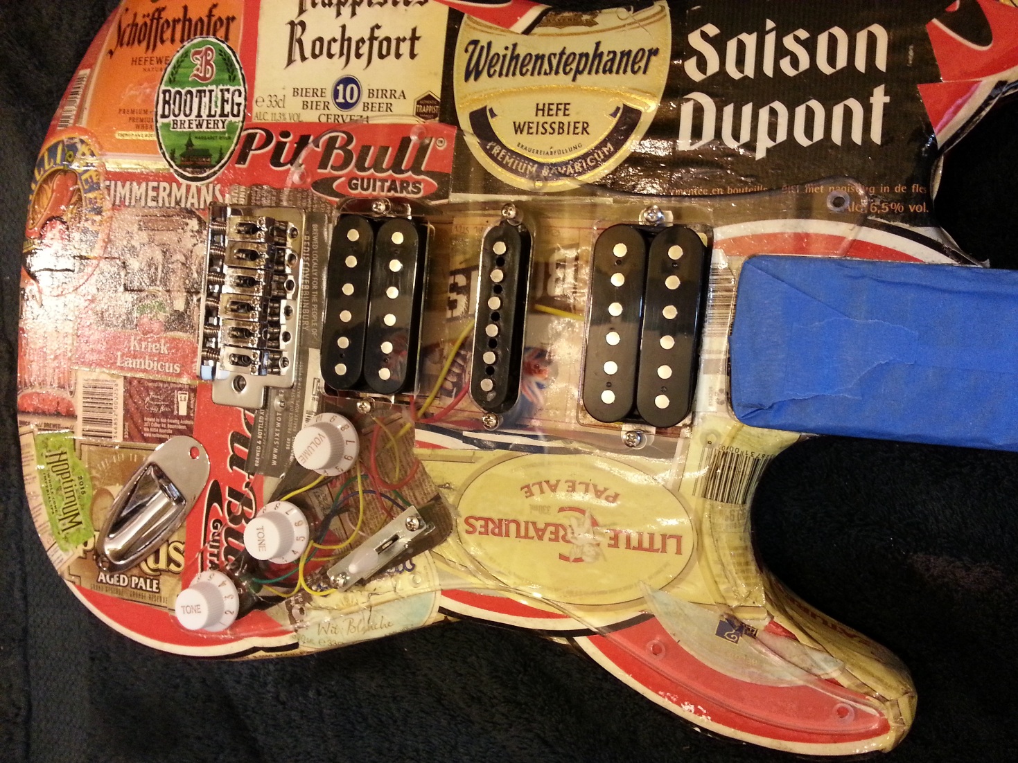

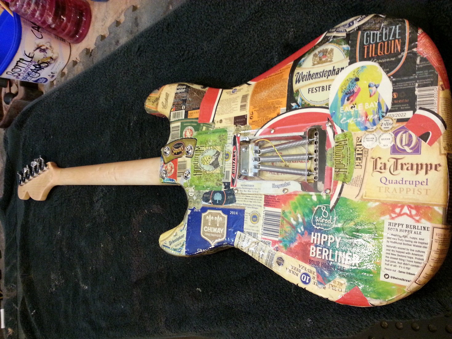

    the clear pickguard and trem cover arrived in the mail lastnight from Pablo, thanks for that Pabs they look great and just how I pictured they would look. I decided to go for HSH configuration as DB suggested this axe should be a rocking djent axe hahah
    Happy how alot of the labels are still visible under the pickguard. Trem cover is the same but will fit that during assembly and leave the protective paper on that.
    Also thinking of using neck screw bushes and leaving the neck plate off.
    Found these humbuckers in my stash, no idea where they are from but neck measured 11.6k resistance and bridge 11.8k, versus about 4.3k for the middle single stock PBG. Might have to replace the neck pup with a mini bucker.
    Anyway will continue with the clear coats, some of the stickers aren't taking the clear too well, trying to get a nice thick glossy finish over the labels to smooth it all off,
    I will also order some black vol/tone knobs and switch tip

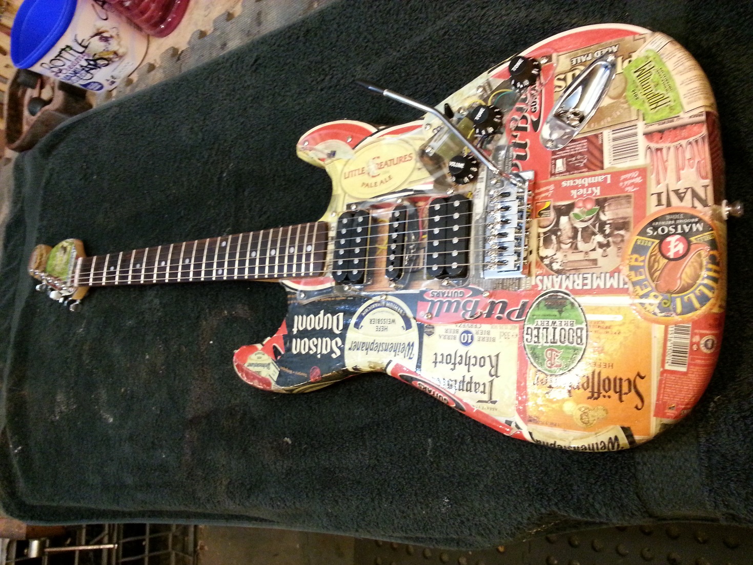

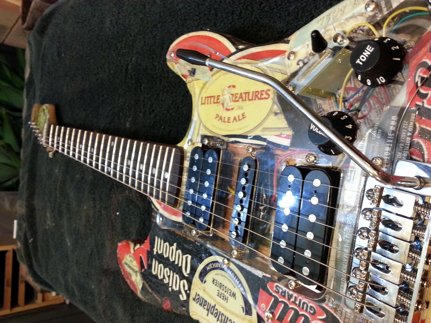

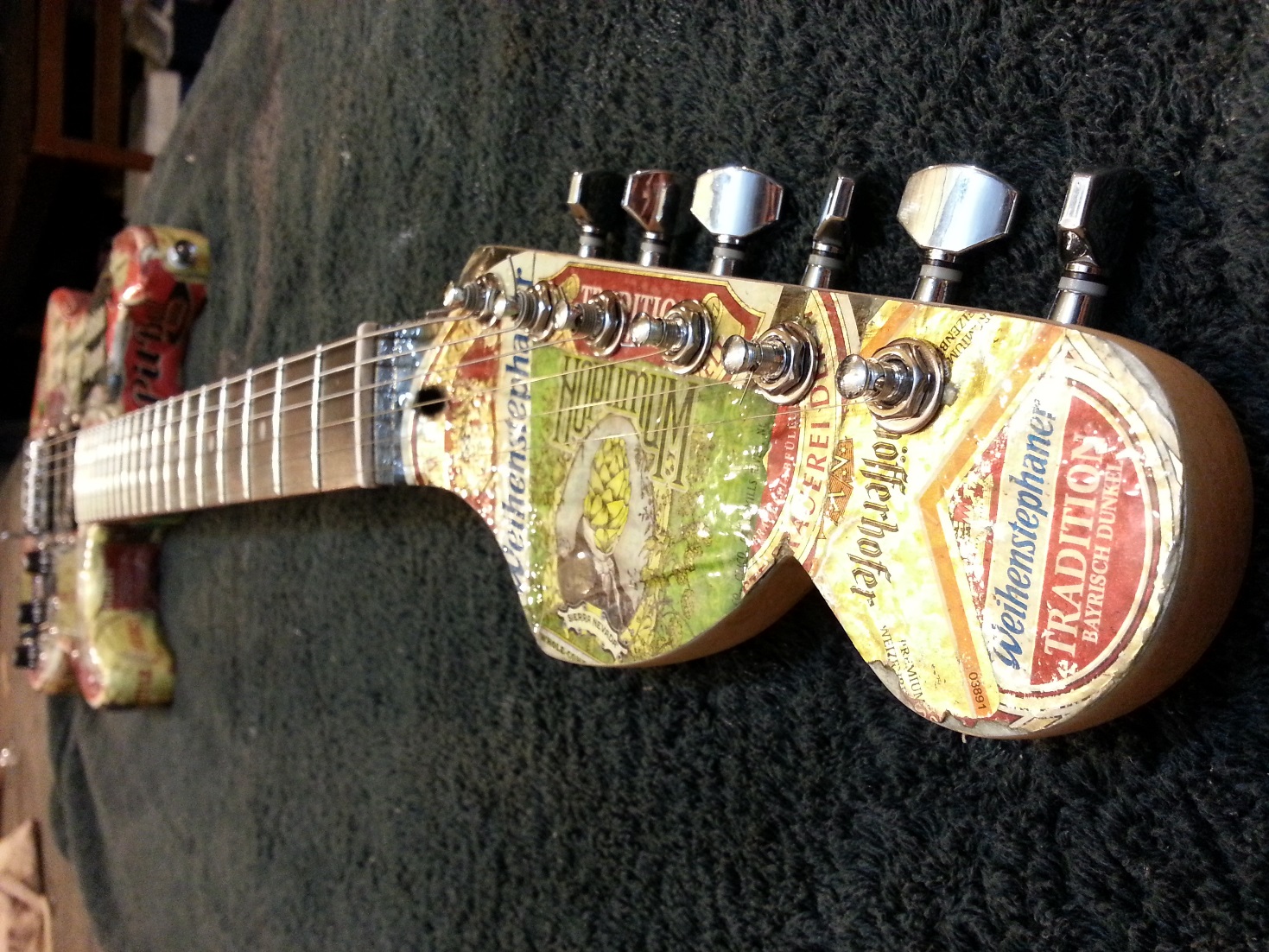

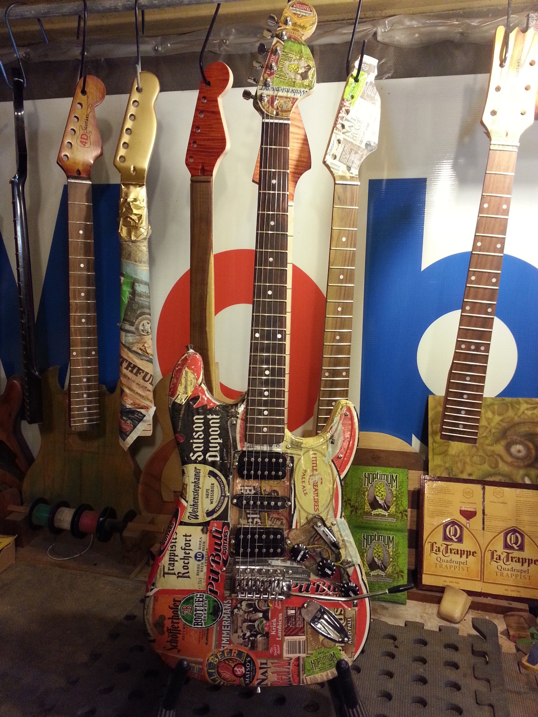

    build completed
    G'day all, finished the build lastnight, sounds pretty good early days, I'll upload a sound demo sometime

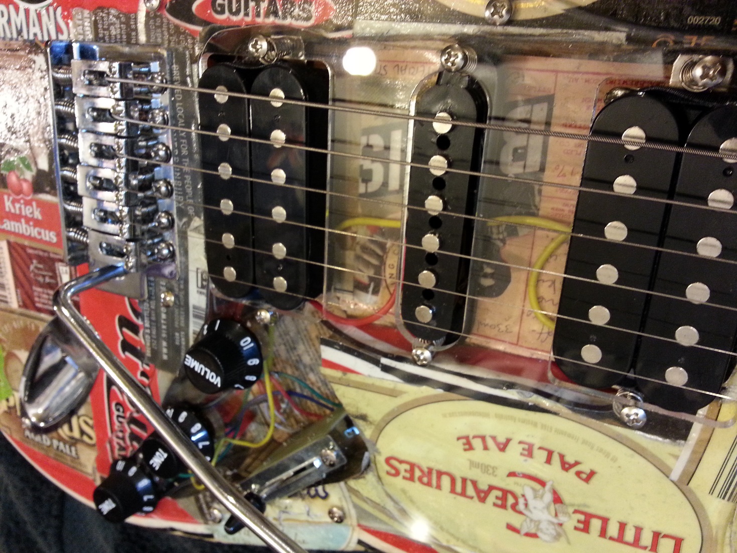

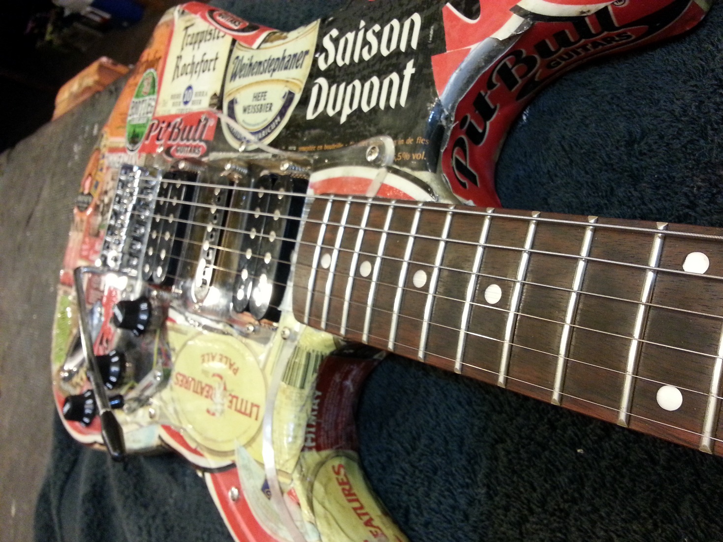

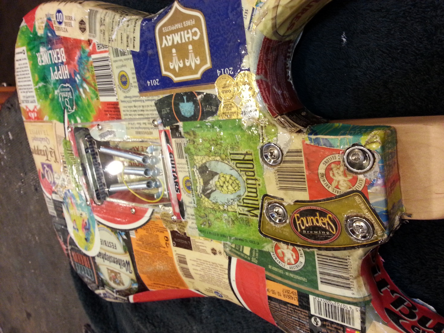

    few more pics
