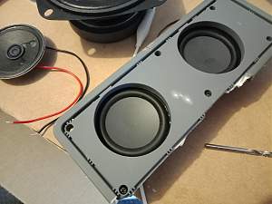

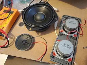

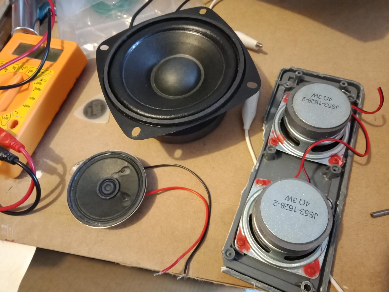

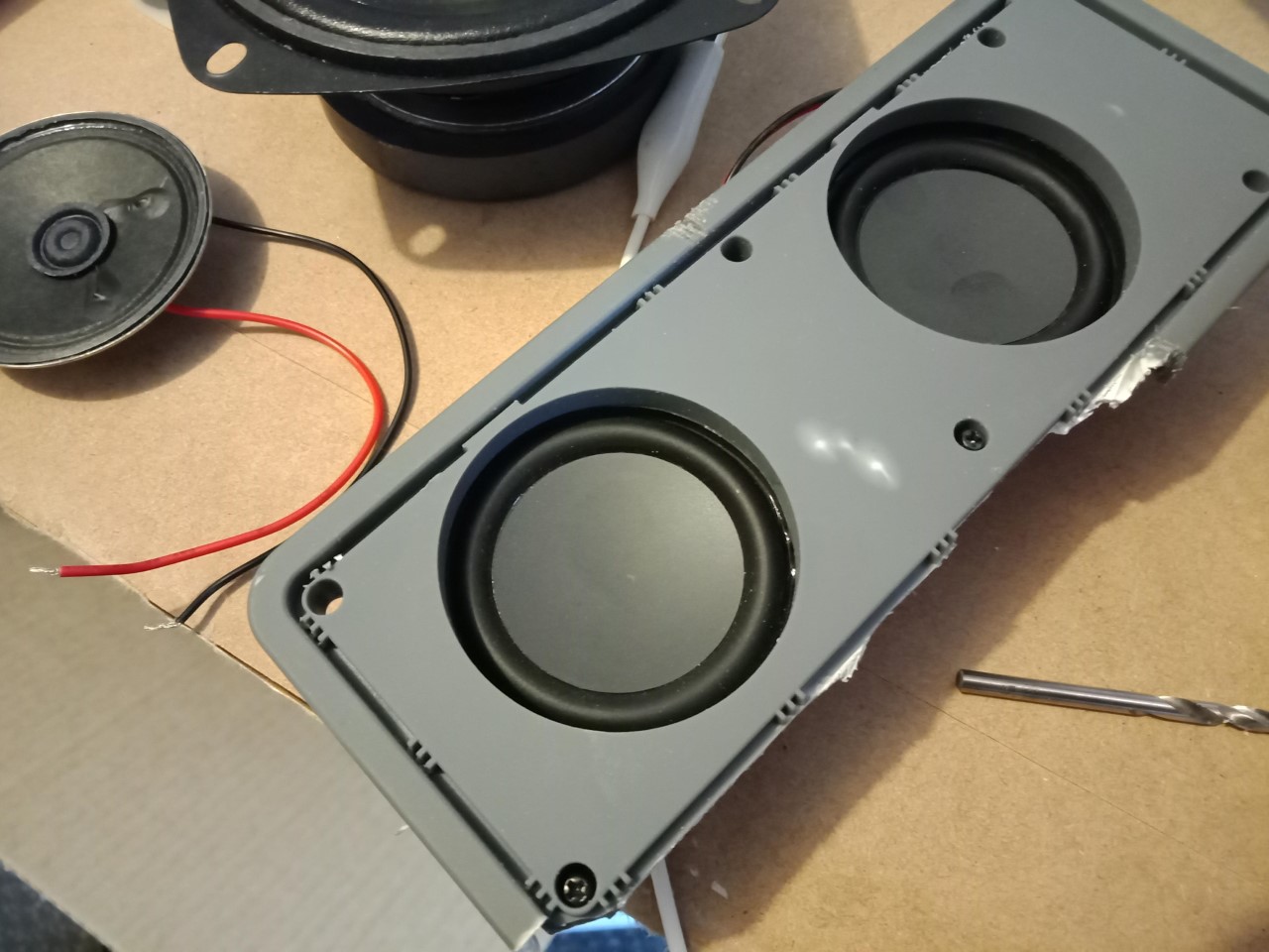

    I tried a single coil with a thin metal sheet but couldn't really get it to sound any good. To be fair, I didn't spend a lot of time on it, but it wasn't really doing much for me.
    Tried a piezo, but also found it made a tiny tap rather than a thud (probably unsurprisingly).
    Raided my random speaker box and found I only had these three to choose from. The big guy is a 4" 4 Ohm, then there's a small 8 Ohm and the two small 4 Ohm speakers from an old bluetooth unit. After trying all three the bluetooth speaker gave the best result - a good thud, which was quite loud when I ran it through a boost pedal

    It's looking more and more like a small speaker is the way to go with these things. I have a 5" driver and can salvage some smaller 3" speakers from the remains of the PC speaker set that I got the broken sub speaker from.
    When the 4" one went thump it was impressive, but I really needed to give it a whack. I only had to tap the small one for a good sound, so that seems ideal for the application. Glad I salvaged that little bluetooth speaker from my old job!
