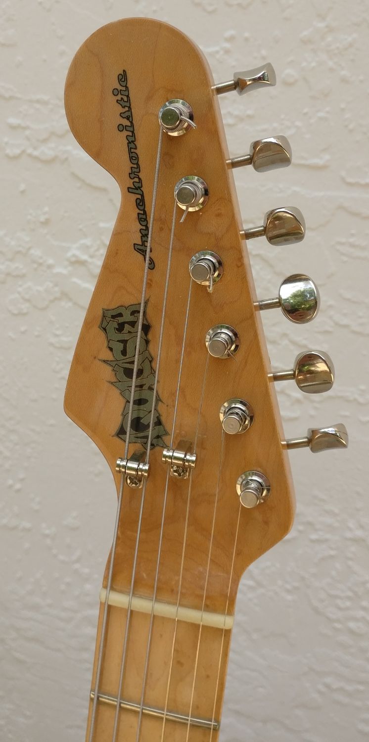

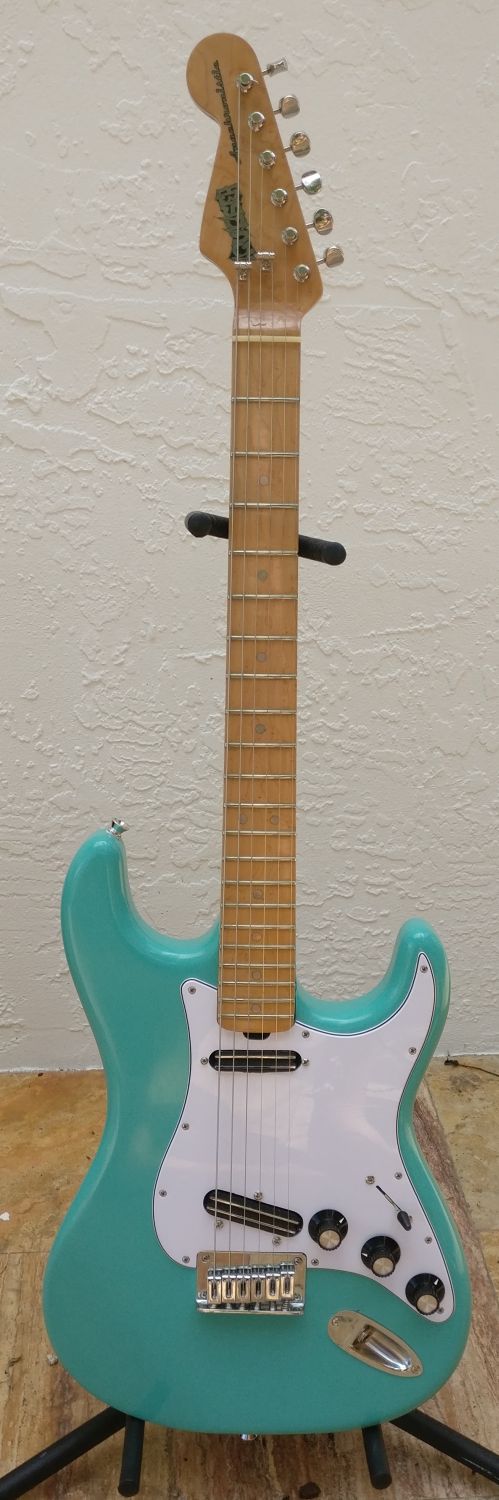

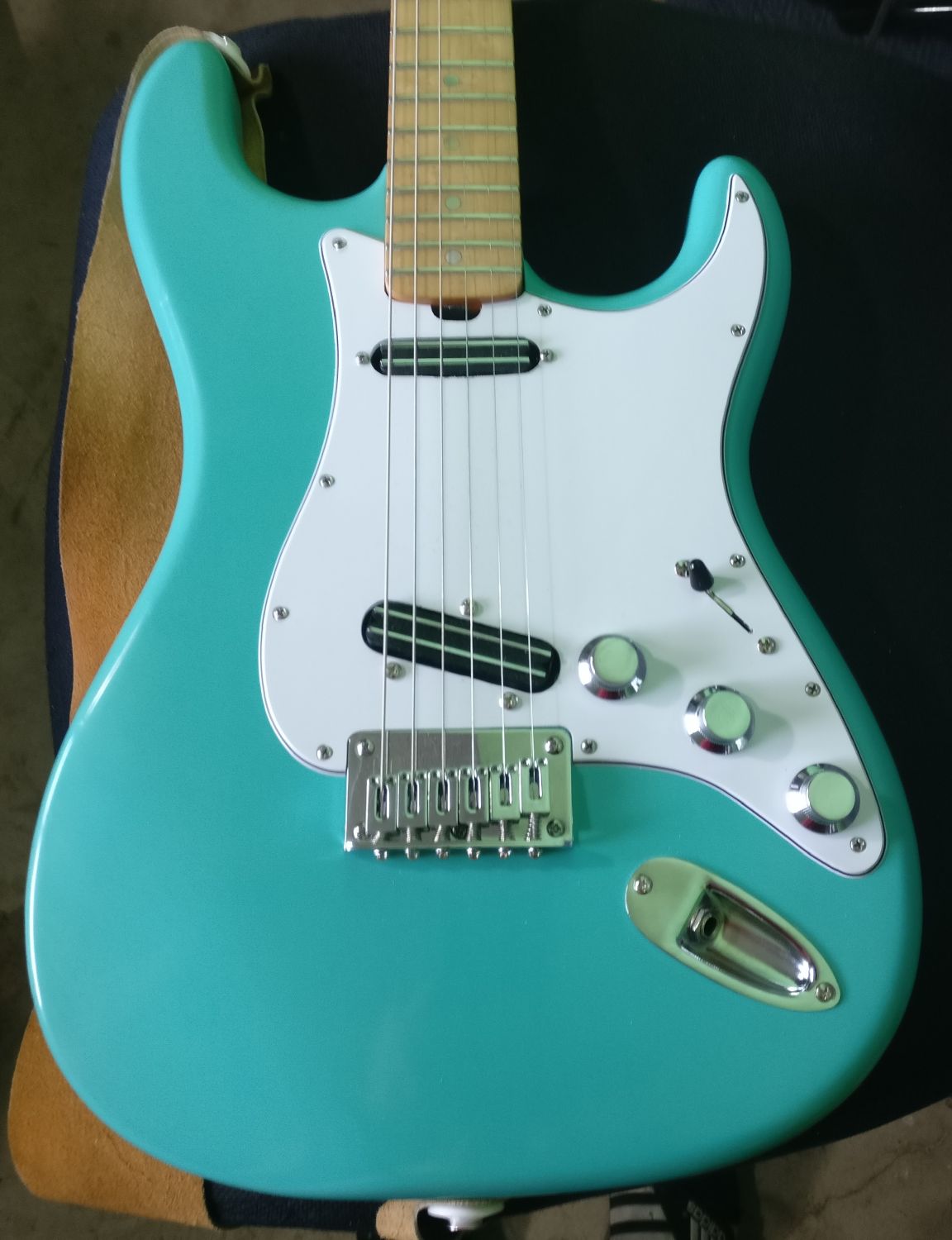

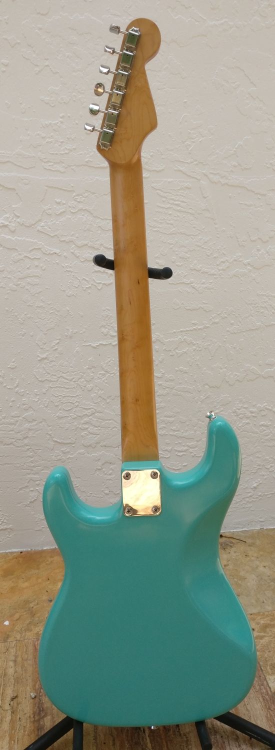

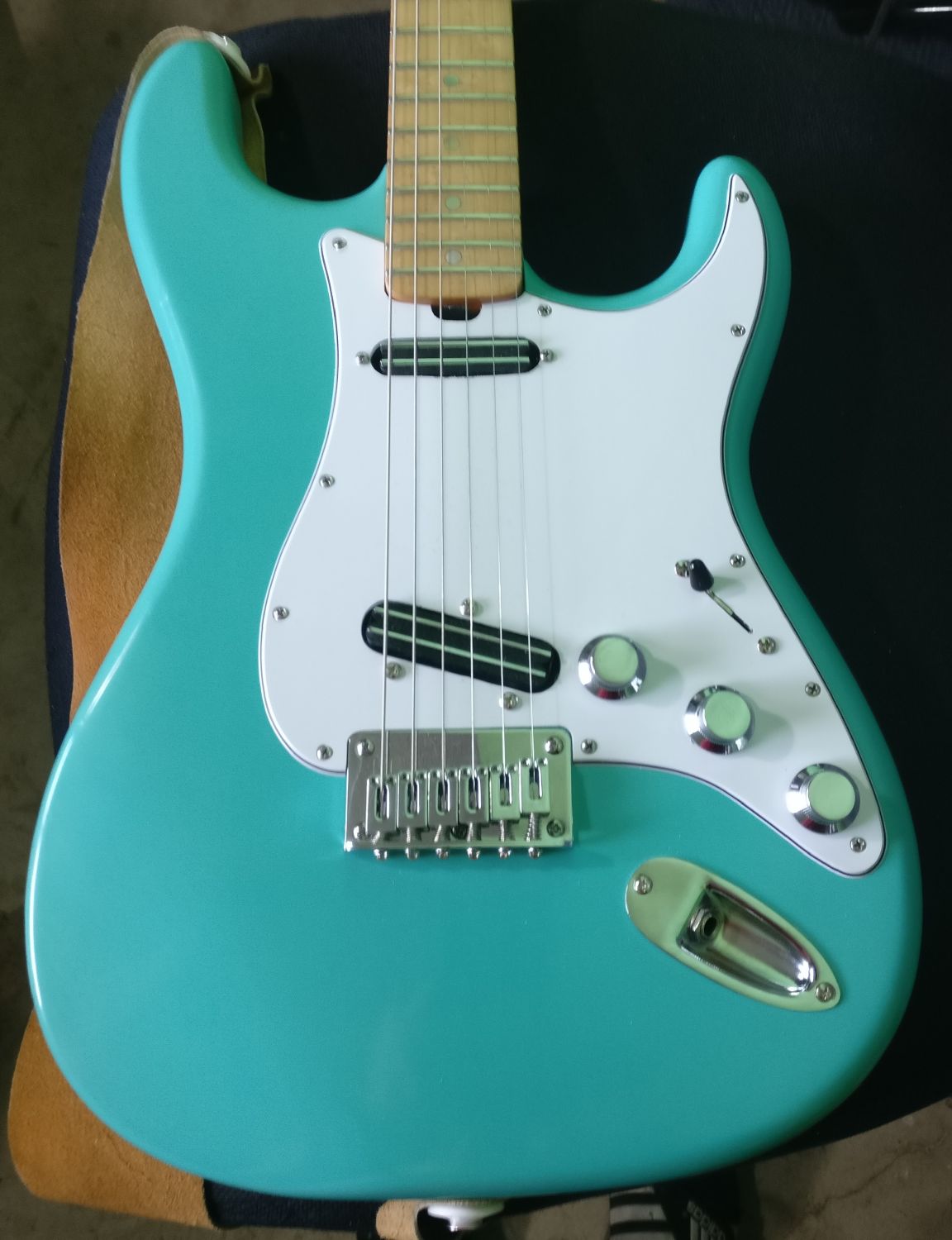

    I put the new set of shorter screws in the bridge two days ago. I put a final-ish tweek on the setup. I am declaring this build complete.
    I started this in the spring of either 1986 or 1987 in my mother's driveway with a can of some sort of satin finish that I put on the neck and body before storing it away until I could get back to it.
    I believe the record is now set at 33 years.
    One semi-interesting detail, is that the color of the neck was as white as the raw PB maple neck I got recently, and I really did not notice a change when I sprayed a very light clear finish on it. The yellowing is entirely aging. Not sure it's the way I recommend getting some color on maple, but effective.

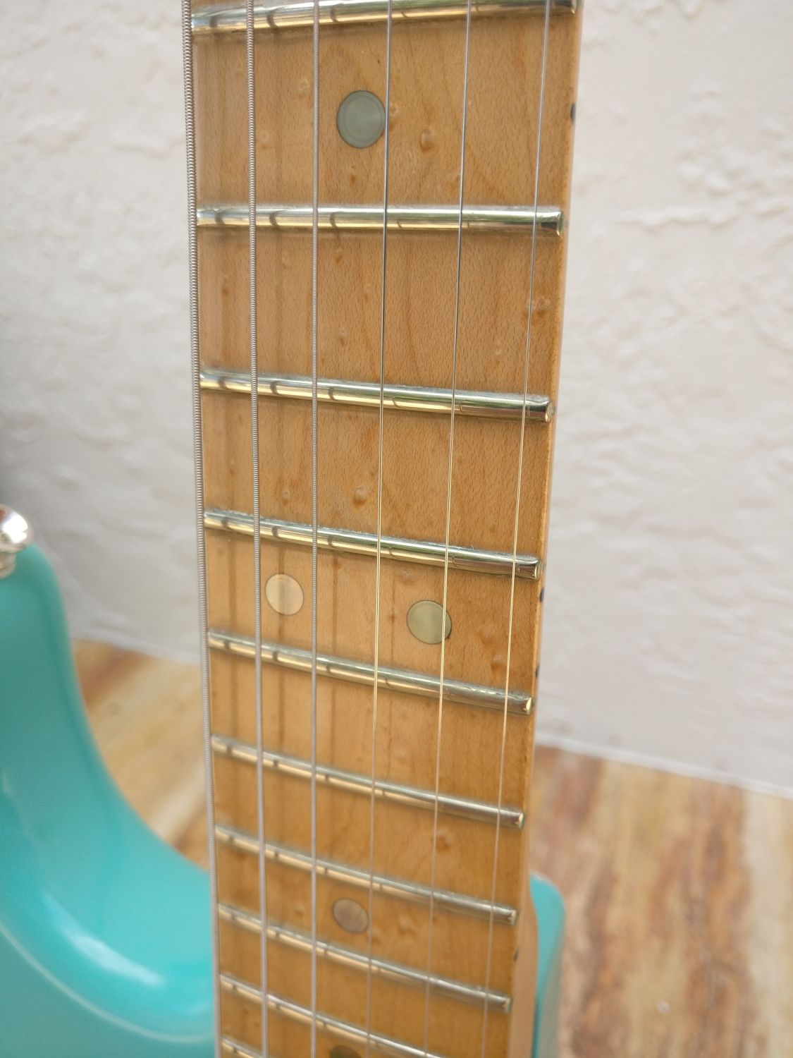

    One nicest things about the guitar visually is the lovely bird's eye figuring in the fingerboard and the abalone dots.
    Aside from that it is very simple. It is not a lefty because I wanted "Hendrix string tension," as one of my friends observed. It is a lefty neck because that's what was on sale. If you look closely you can see the treble side dots on the neck. Those are original. I added dots to the bass side, something Hendrix probably did not need to do.
    I can't remember why I got a hard tail. It was either to keep things simple or because they had a poplar hardtail body on sale.
    I wanted to keep things as simple and clean as possible. The only exception is the switching. The middle "pot" is actually a four way switch which puts the rail humbucker pickups in H+H, S+H, H+S and S+S modes. There is push-pull switch on the tone pot that switches the S+S mode from traditional to humbucking mode.
    Deets:
    -- Bone nut from DB
    -- Gotoh vintage (Kluson-style) machines
    -- GFS Lil' Puncher (Modern Vintage) pickups
    -- Oak Grigsby 3-way blade switch
    -- Bourns master volume and tone pots, the latter with a DPDT push pull switch
    -- 4-way, 3-gang rotary switch that somehow made it into my box of parts, I know not when or how, but it looked like decent quality...
    -- Dragonfire custom cut pickguard
    -- Pure Tone jack
    -- Not sure on the brand of the string trees, bridge, strap-buttons or jackplate. I know they were inexpensive and nothing fancy, but seemed like decent quality.
    It was originally going to be dark blue with a drawing of a spaceman on it that my oldest daughter made. I had logo drawn to make this an "Astrocaster" but she could not find the drawing I remembered. My son, meanwhile liked the "Bali Green" color...which had more of a surf vibe. So my youngest daughter, who is practicing her graffiti style made me an "Aquacaster" logo. Not sure I am crazy about the way I got it aligned, but my daughter thinks it's cool. After three daughters, my experience is that when your 15 year old says something is "cool" you should stick with it, because you may never hear that again.

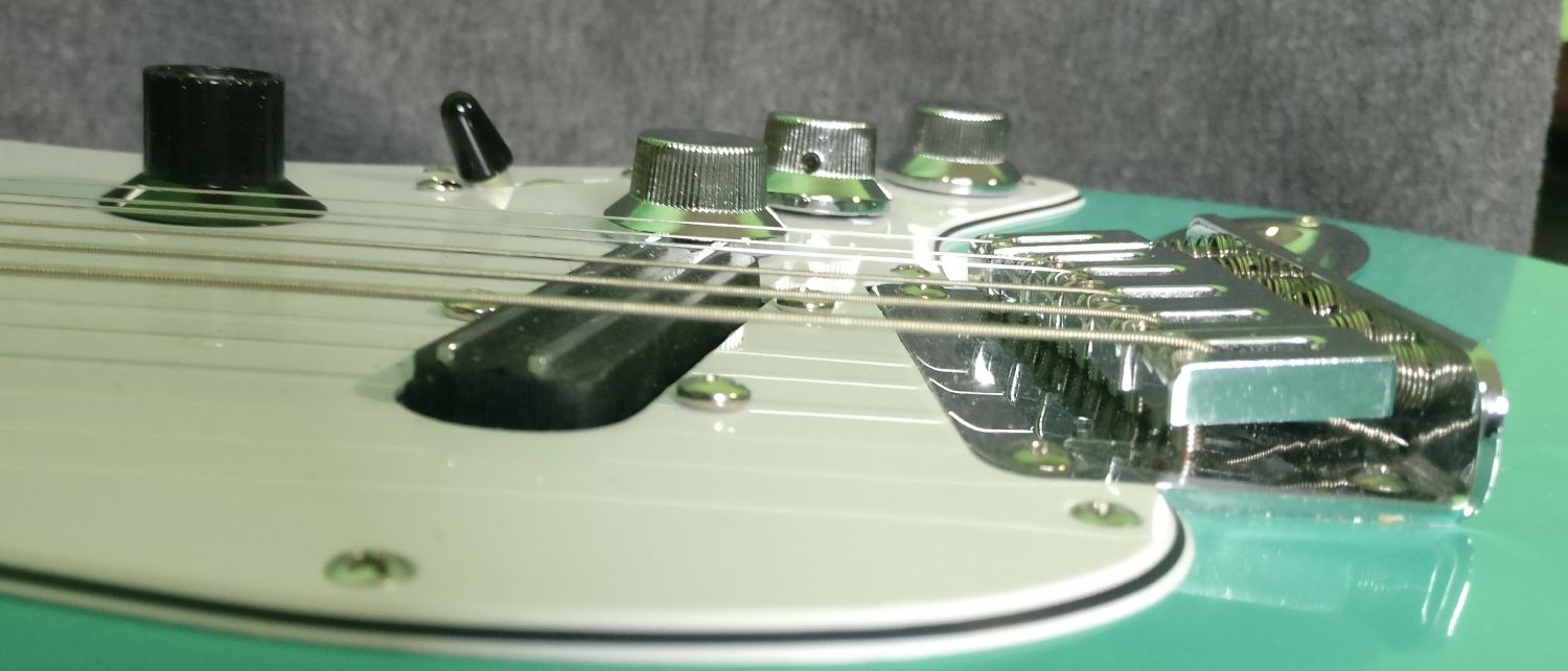

    I really liked the Raytheon knobs that I used on this build. I used Raytheons on the my first build (an ESB-4) to give it a little different-than-the-rest look. Plus the Raytheons are really high quality. I had the same thing in mind for this build. I liked the look, but I kept whacking the volume knob when I strummed. So I started to look for more traditional, low profile strat-type knobs. I found some chromed metal ones on eBay with set screws. You can see the difference in profile here.
    Old knob is on the left. New knob is installed. Actually needed to file off a bit of the tops of the shafts to get the knobs to sit right--a process that took about 15 min. Now I understand why strats have the low profile knobs! It doesn't completely eliminate the issues of the knob getting in the way of aggressive strumming, but it is quite a noticeable improvement.

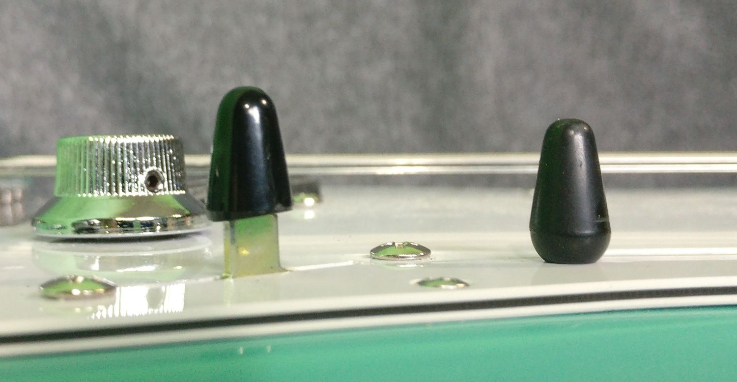

    The other profile issue is with the switch. In my case, since I used Tele pups, so it's a three-way Oak Grigsby. In the bridge position I found it annoyingly easy to hit the switch. On the interewebs I learned that hitting the switch and changing the setting unintentionally is a fairly common thing among Strat players.
    I noticed that if I took the tip off the switch I stopped hitting it unintentionally. So I set about lowering the profile of the switch. I noticed that the slot in the tip was actually longer than the tang on the switch. A few minutes with some sandpaper on the bottom of the of the tip allowed me to lower the tip by a good 5mm or so. This makes it both shorter and lower (closer to the pickguard) in the bridge position. Here's a pic of what an original tip looks like and the one I sanded down.
    In the closeup the bottom of the sanded tip looks uneven, but this is not noticeable in real life.
    Taken together, I think I like the look of the new knobs, and there is no noticeable change in the look of the switch...so mission more or less accomplished ;-)
