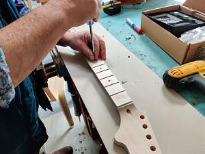

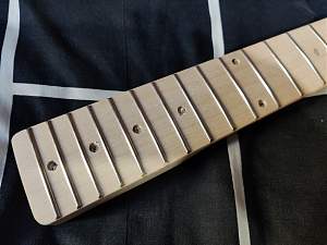

    So, slowly does it. Fret markers are removed, now i will check to see if the black stain will permanently affect the new white dots so ill know to either put them in first or after i stain.

  8. #78
    Hard choice. You'll want to sand the top of the neck once the dots are installed to get it flat. but that may make the board look patchy if it removes some of the stain.
    Test a dot with the stain? Or get it flat, mask the dots with a liquid masking compound and then stain?
    The latter sounds like the way to go. Will have heaps of time to test in the coming months locked in hey.

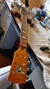

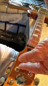

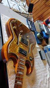

    Spent last night sorting out my SG-1. Aweful buzzing through the amp.
    You guessed it, bridge earth had been forgotten. So took it all to pieces, fixed the problem. Its now back together again with slightly heavier strings, 11 gauge as i want it for a banger...lol.
