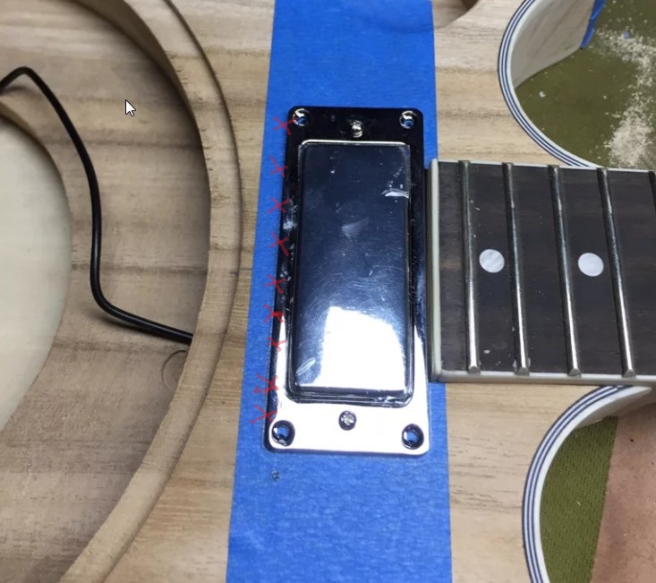

    What advantage is there in your approach compared with the simpler way around the problem of slightly extending the pickup well (red XXX) ?
Name:	ScreenHunter_1619 Oct. 21 21.39.jpg
    No real advantage mate, in the provisional measure I’d worked out that moving it back would have impacted on the cover.
    The other option was to make another pup ring with a cut out, but I thought that might look a bit dodgy.
    And I always end up doing things the hardest way possible. 🤪🤯
