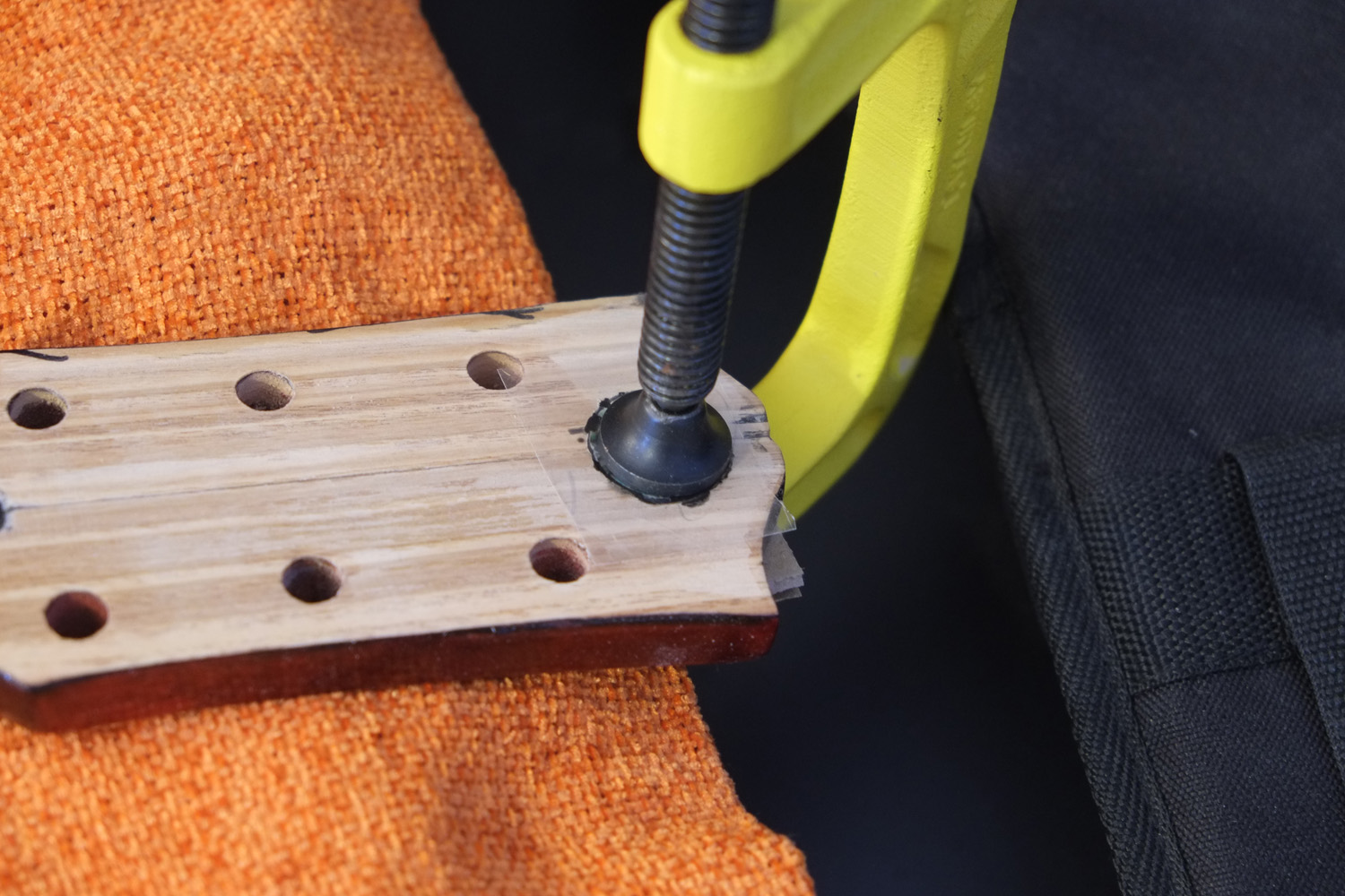

    Well, might as well post a few pictures.
    Here's the body. It's had several sand downs and all the dips and glossy spots had gone at the last sand. Now had a couple more coats of Tru Oil over the top of that, so it's now going to wait for the neck to be finished so I can glue that on. It's a bit dusty I know, but that all comes off when it's rubbed down.
Name:	330 body hanging small.jpg
    Well I've stuck the veneer on the headstock, trimmed it down, patched up a couple of areas where the veneer broke off at the corners, routed out a circle for the inlay to fit in, and stuck it down with black superglue. A brief wobble with the router gave a not quite perfect circle, but it really doesn't matter as any gaps just get filled in.
Name:	330 headstock small 2.jpg
ID:	25162Click image for larger version.
Name:	330 headstock clamp small.jpg
    There is a protective layer of plastic film under the clamp - the same film I found out earlier that didn't adhere to superglue.
    The clamp is now off and the top of the inlay is now covered in black superglue. I've done the same to the headstock of the ESB-4 bass. It seemed sensible to do them both at the same time.
    Because the inlay is stuck to a plastic backing, I drilled holes through the backing in places so that the superglue oozed through the holes (and it did), so should lock the whole inlay piece in place.
    Now I just need to wait for the glue to dry hard, then can sand most of it off the top, paint the headstock black with a few coats of black paint, then sand everything flat, hopefully with the inlay design shining through. A bit of gold writing on the headstock, some clear coats, and the neck should all be good to go and stick on the body.
    Oh, and I need to stick the new bone nut on before I forget!
