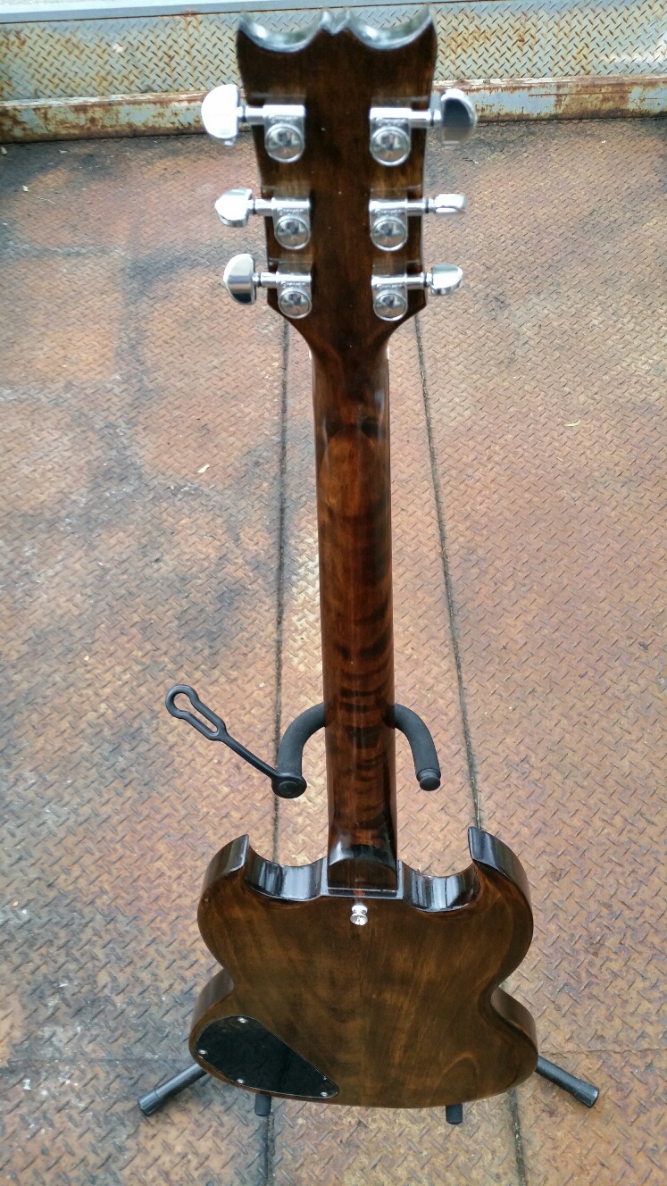

    It seems that leaving the thing well enough alone is what was needed. After getting fed up with the compressor pedal I cleared the bench so as to change the errant G string. After giving the beastie a quick tune I thought to check a few fretted notes to surprisingly find all were close enough that a run through an amp was in order....No string change required.
    Fretting notes gently is the go, pressing too hard as I all too often do is less than desirable... and with a light touch this dark one sings. On the VOX Pathfinder 10 in overdrive mode is awesome. Not too much bottom end on the neck and plenty bright enough on the bridge where it counts, a nice range that with the flick of a switch or tweak of a dial inspires the imagination with the well known overtones of Sabbath and AC/DC...
    Neck seems somewhat fatter that what my taste prefers, and I'm not yet accustomed to what feels like a much longer neck, but the balls are there in spades ... I'm saying it's done... Just need a decent guitarist to pick it up and play....

    That looks superb Marcel, very very nice, I have one of these kits waiting in the wings to assemble, also my first venture with Tru Oil to go on it, now fingers crossed it will look as good as yours does... well done
  5. #74
    Agreed, this is really nice.
    I think I need one.
  6. #75
    Nice look on the back of the neck too.
    Overall it is something I would be happy to add to my own collection.
