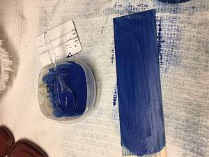

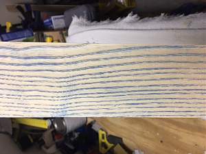

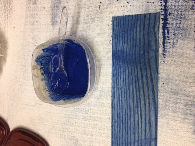

    Thanks Drummerdude, that would be very greatly appreciated. I think I'd describe what I'm after to be an "unnatural finish" For a test run I'd be happy to see if the blue stands out at all, anywhere along this gradient really but I guess somewhere slightly right of middle https://goo.gl/images/cejzdL
    If I had a piece of scrap I'd try out a range of options. My concern would be with the blue stain on the filler effecting the non-grain areas.
    EDIT: keep in mind I have no idea what I'm doing. It could be that what I'm imagining isn't possible or will just look completely horrible

    No problem. It is very easy to do since you would be sanding back the filler only the blue would remain in the grain. I will try and try it tomorrow evening. I am leaving for a vacation on Thursday so I will try to do it before I go. I actually have to mix up some blue stain for my bass so I will add to some natural timbermate and give it a go.
    Quote Originally Posted by Drummerdude View Post
    Awesome thanks again. And no worries at all if you don't have time.

    Here you go Sergeant,
    Here is what it would look like to grain fill with blue timbermate and sand back to only leave grain accented.
    You can see the mixed color, applied and rubbed in grain, scrape off excess, and then sanded back.
    Hope it helps

    Legend. Thanks Drummerdude I love it, I think it'd make for an interesting looking guitar. My wife is scrunching up her face at it. Out of curiosity, what type of stain did you use?
    Current Build:
    TLA-1F - Jötunn
    I used transfast water soluble dyes. You just mix them with warm water and you can make the color as light or dark as you like. I hope it helps..
    Awesome very much appreciated. And yes very helpful. Thanks.
