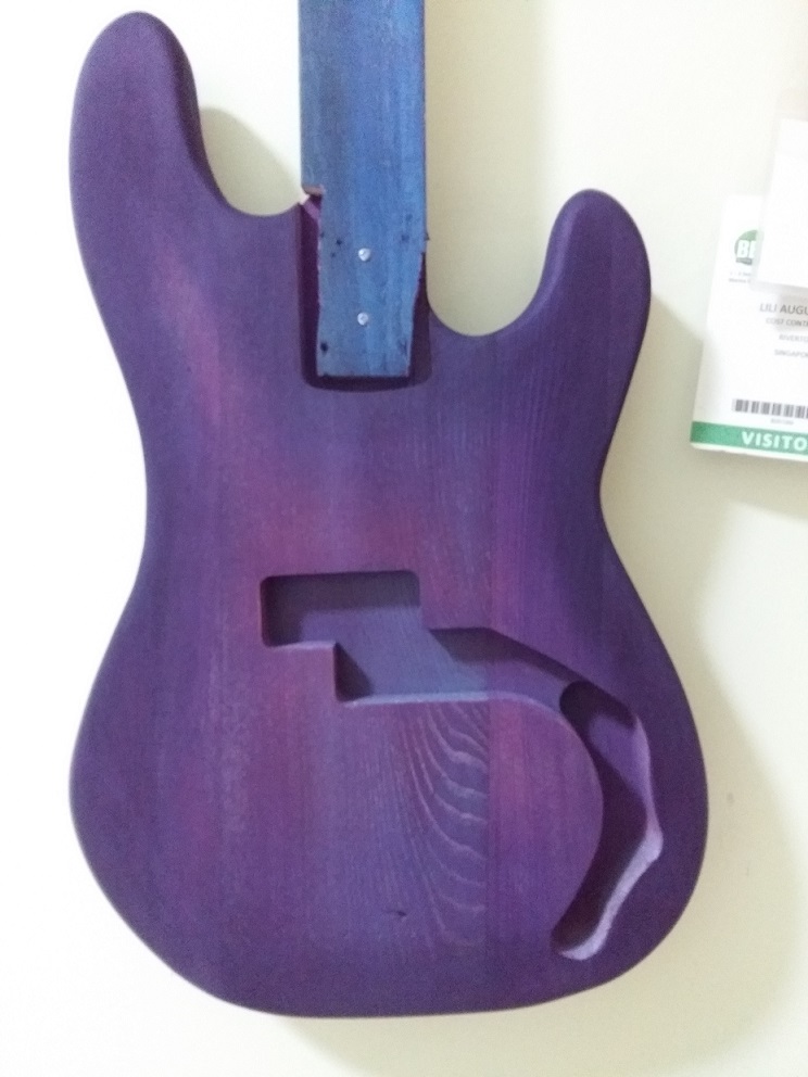

    Hi Toshi looking good and glad the sanding phase is over (for now anyway !!). I would guess that too much water dye has been applied and small parts of the grain have lifted. I would maybe do a lighter coat, one coat per day so it cures quicker and I think you should be fine. Give the lumpy areas a light sand and continue with the next coat.
  2. #72
    It's normal for any wood grain to lift when its wet. It's one way of finding any loose ends of wood fibres. As Woks says, a light sand will remove them. You can't really prevent it from happening at all. Your initial stains need to be quite wet to really soak into the wood. You then either need to carry on with wet stains and be prepared to sand down lightly between stains (once the wood is dry), or then go with a dryer stain and apply more coats, and then maybe just sand down once at the end of the process.

    Typical reaction when using water based stains on Ash. If you want a dead flat finish with no grain definition you may need to buy some natural or white timber mate and add some of the stain to colour match then apply all over to grain fill. Leave for minimum of 12 - 24 hours and then lightly sand off. Very messy and best doing this outdoors.
    Alternatively you could lightly sand down between coats as Woks & Simon have mentioned and load up the initial top coats so that they also act as a grain filler.

    I was trying to make Vivid black grain in colour just like you did on Red JB. That contrast was great and what i really had expected on my bass, however, when I finished filling grain, i noticed black dye was not enough in Timbermate to pop grain up... so i decided to change to whole strong colour with normal grain, that resulted a bit too much water i applied. Thank you for advice for fillings method. It helps me a lot for the control grain definition for future project.

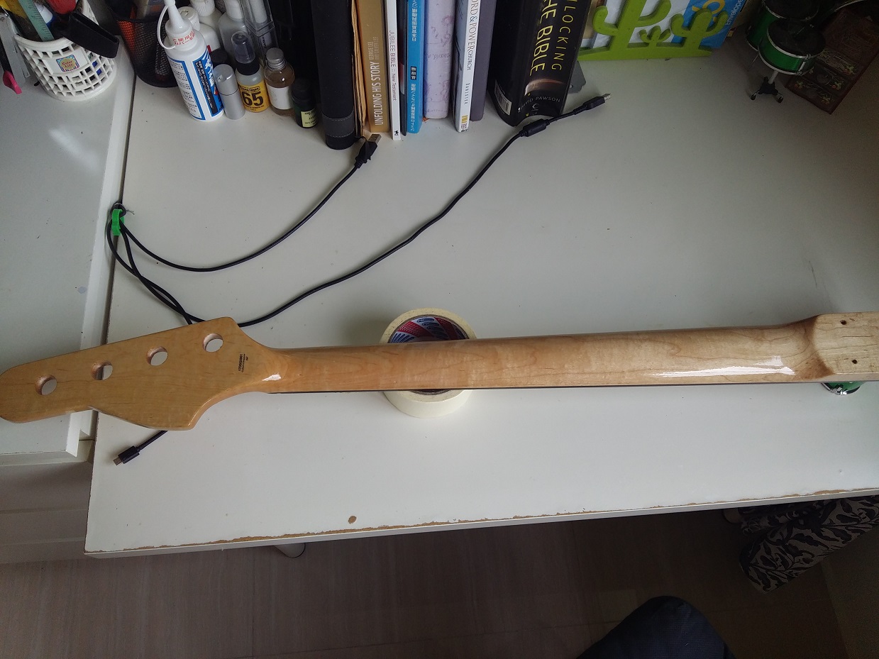

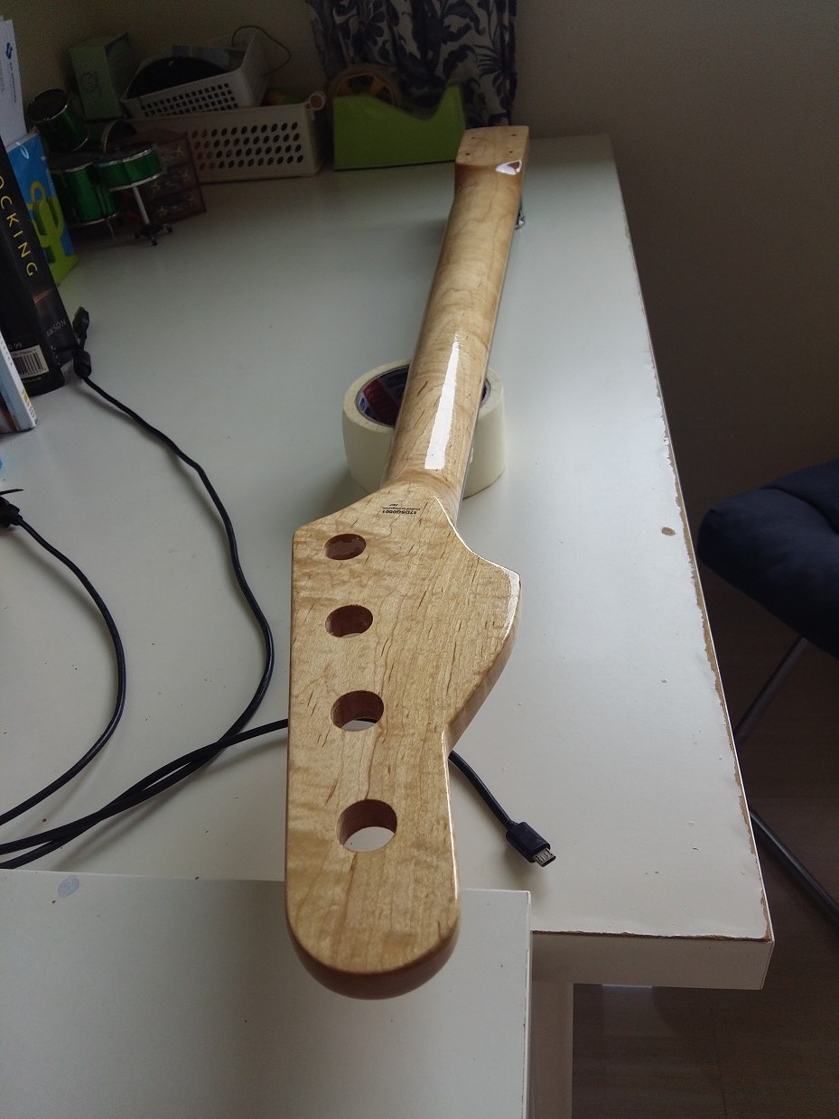

    While I am working on body for staining, i'm also dealing with neck. i am thinking to apply the methodology of water-based acrylic varnish on body for neck with Tru-oil as well, coating 20-30 times and sanding down to make flat surface and polishing at the end. so far finished 15 TO coating on the neck in photo below. If you have any pre-caution for this process, your advice will be very appreciated.

    Hi Toshi, 15 coats on the neck might be enough already.
    I haven't gone past 12 on a neck yet and usually stop at about 20 on bodies. That being said, on my current Tele build I have done 6th & 7th TO coats applied on the body with 600 grit wet and dry in a light wet sanding action and it has smoothed everything out brilliantly. May not need to go much further than 12 coats at this rate and plan to move up to 800 grit for the next couple of coats. Might start the wet sand application method on neck after the next wipe on rag coat as that will then have about 6 down to work with.
    If you haven't done so already check out a couple of Andrew Osborne's (Ponch) builds where he uses this wet sanding method for applying TO. For me the wet sanding part works fine but then reverting to wiping off with clean cloth was not so good. His tip about 50/50 mineral turps/TO is a good one too.

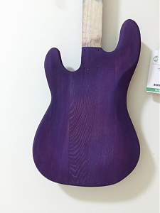

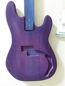

    A week to struggle with staining, drying, sanding lifted parts several times and finally grain became calm. since repeated attempt caused strong color tone, i have decided to try sun-burst as below. I don't know whether this is proper approach to make it. but since i will not be able to use spray guns to graduate color, i think this is only option for me for sun-burst.
