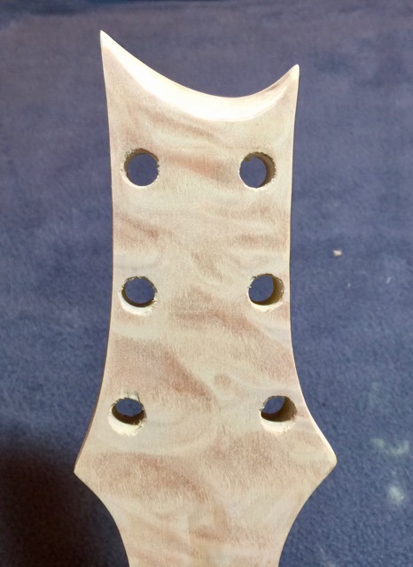

    Headstock

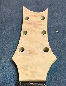

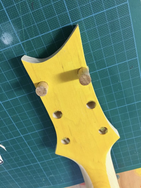

    SO with Xmas and all it has been a while between updates. I have been making progress though.
    As predicted by Simon and others, the holes on the headstock became very close to the edge once I'd got to the shape I wanted. I plugged the top two with dowel and re-drilled.
Name:	Headstock - 1.jpg

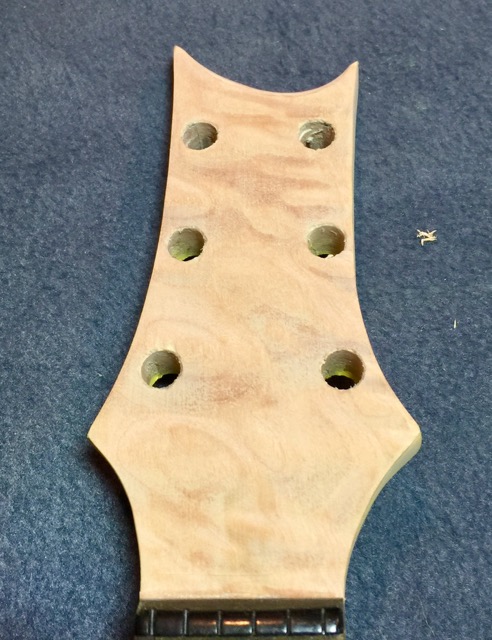

    The old holes are covered by the quilted maple veneer on the front and I'm reasonably sure the back of the tuners will cover the rear.
Name:	Headstock - 2.jpg
Name:	Headstock - 3.jpg

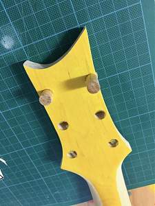

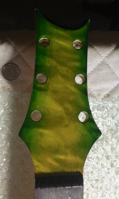

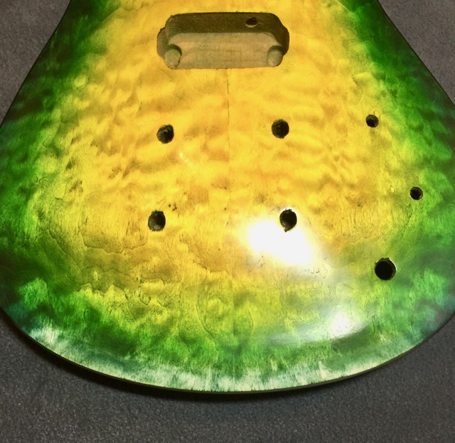

    I applied the same colours to the headstock as the body but they did come out a little darker due to different wood.
Name:	Headstock - 4.jpg

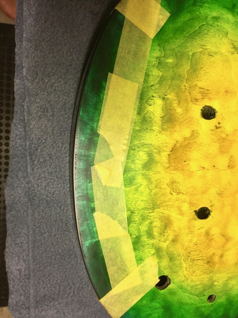

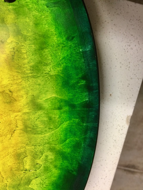

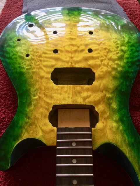

    Fixing some dye
    Next up was to fix some application marks on the dye. I'd left some stripes on my last burst of blue.
Name:	Dye fixing - 1.jpg

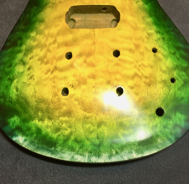

    Mask, sand and re-apply.
Name:	Dye fixing - 2.jpg
Name:	Dye fixing - 3.jpg

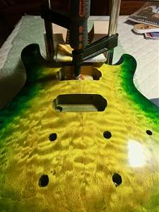

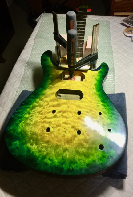

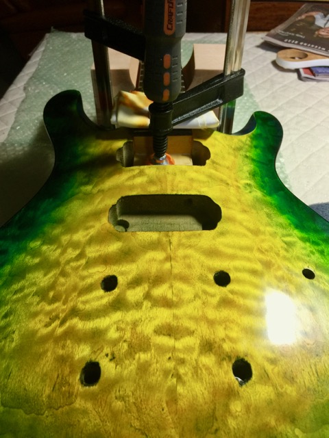

    Neck glueing
    Now onto one of those "no turning back" moments - glueing the neck. The neck was a good tight fit on the sides. I did have to level the bottom of the neck pocket with a touch of sand paper. I got enough glue squeezing out to indicate that I'd applied just enough and not too much.
Name:	Neck glueing - 1.jpg
Name:	Neck glueing - 2.jpg

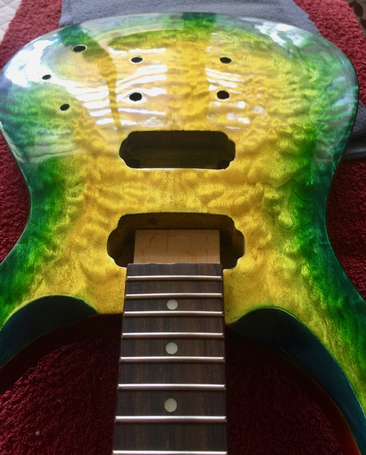

    Final finish
    Onwards to the arm muscle building part of oil and cut and polish and wax.
    I applied about a dozen coats of the Aussie Oil. About halfway I did a wet sand with 1200 and a 0000 steel wool two coats from the end. Then a cut and polish by hand with Maquires. Finally a coat of U-Beaut Traditional Wax and a good rub. I'll likely do another wax coat and buff with the mop after getting all the gear in.
Name:	Final finish - 1.jpg
Name:	Final finish - 2.jpg

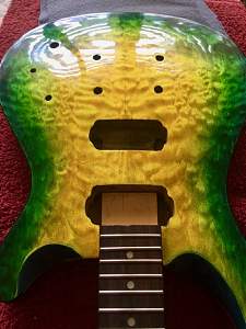

    It is difficult to get the quilt effect in photos as you see in the mags and big brand guitar websites. Any tips would be appreciated.
    I'm quite happy with the shine and depth of the finish but I have learned a lot about the underlying prep as I've gone along.
    Next up is shielding and wiring. Stay tuned (tuned - get it:-)
    Cheers
    Dean
