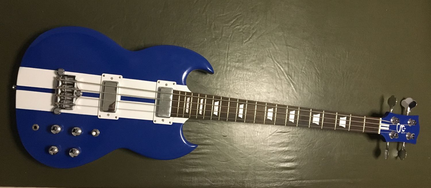

    I used this for my SG Bass - https://www.ebay.com.au/itm/3M-471-F...IAAOSwYGBZiogp

    Did you spray the white first, wait for it to dry, then tape it off and spray blue? The lines look super sharp!

    Oh man. Now i HAVE to build my own AC Cobra SG
    They look awesome!
