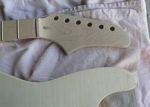

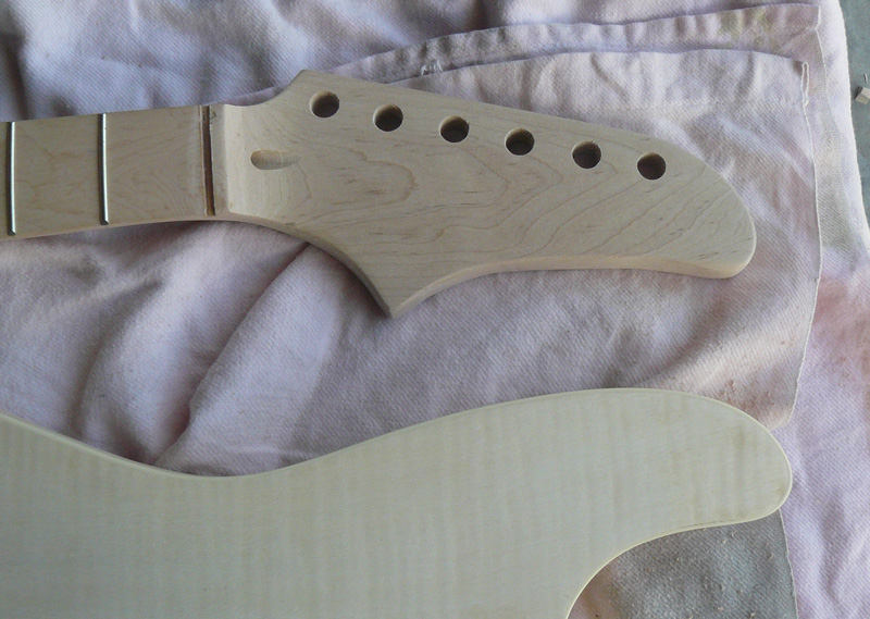

    Head stock cut today..gee where did I steal that shape? :P Just traced the top horn onto cardboard, it works with the super strat look I think
    cool headstock shape Dedman
    great work, love the headstock
    Simple, clean, classy.

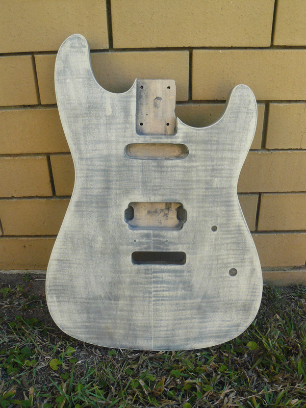

    Did the timbermate and initial sanding on the body. GLUE GLUE and more GLUE! Will go to the shed of despair tomorrow for some gunk off. The stripe down the middle worries me most, the rest of the front glue I could hide with a narrow burst.If I cant get it off with Gunk Off I'll have to slice it and fill with timbermate and have a black line which is preferable to white.

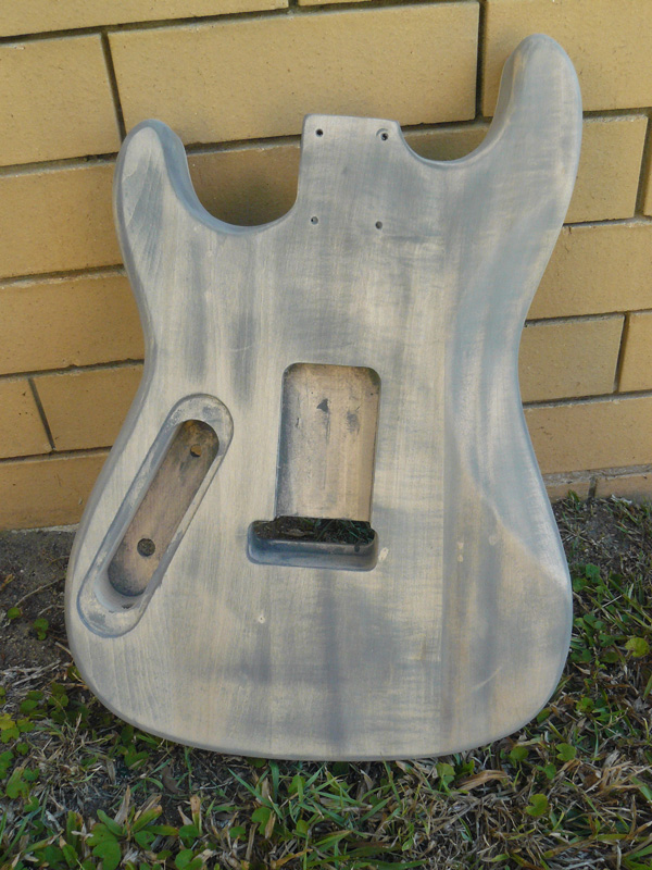

    more glue but the back is getting painted solid black so this doesn't matter. I'm sure these guys must have glue fights when the boss isn't lookin

    pity about all the glue Dedman. Sure you will work around the white line on the top. Looks like some nice flame on the veneer at least.

    Hey deddy same thing happened to me mate. Loosened with some brushes and it came up pretty well. What colours are you thinking? Or is that a secret
    Thanks Nick. Red ink on top, solid black on the back
