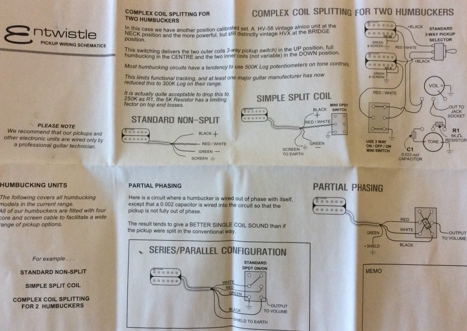

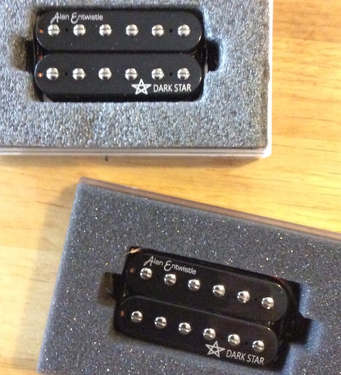

    So... These just arrived and I can't seem to get this stupid grin off my face
    Wiring suggestions
    If plan A fails, remember that you still have 25 letters left.
  6. #76
    nice pickups Andrew, where did you order them from ? They are different to my Dark Stars in an EXA-1 build, they don't look like they are from PBG. Lots of wiring options what are you thinking just split coil both humbuckers ?
  7. #77
    Member AndrewA's Avatar
    Broken Hill, NSW
    115
    Hey Wokka, they are the Entwistle Dark Star ND-B pickups from PBG. I noticed they look slightly different from the picture on the website, but I'm buying them for the sound and don't mind the new look.
  8. #78
    Looks like new cosmetics and packaging as the wiring instructions were on the shiny outside cardboard part on mine. The fold out paper instructions are similar to what you get in Tone Riders.
    Have Thursday as RDO and will bang out and post some rough notes for you to hear the different sounds that can be achieved from coil splitting individually.
