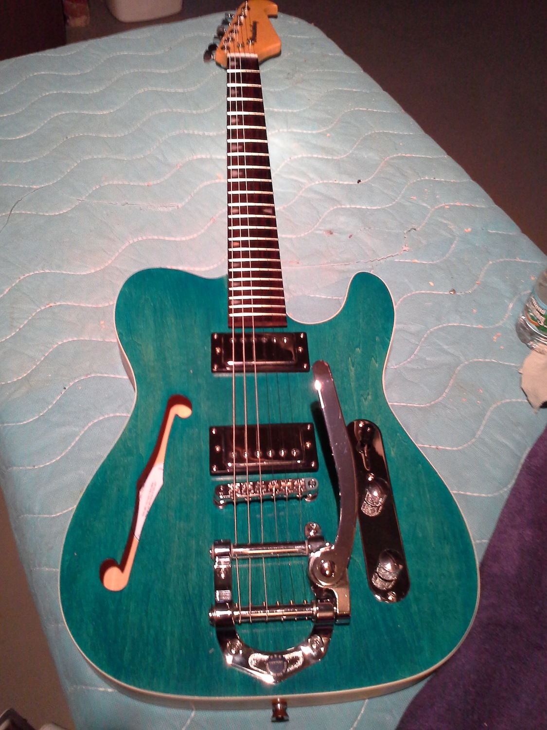

    Hey Friends,
    Here's the latest: I let the body hang for a week so the stain/finish could set.
    Here's the beginning:

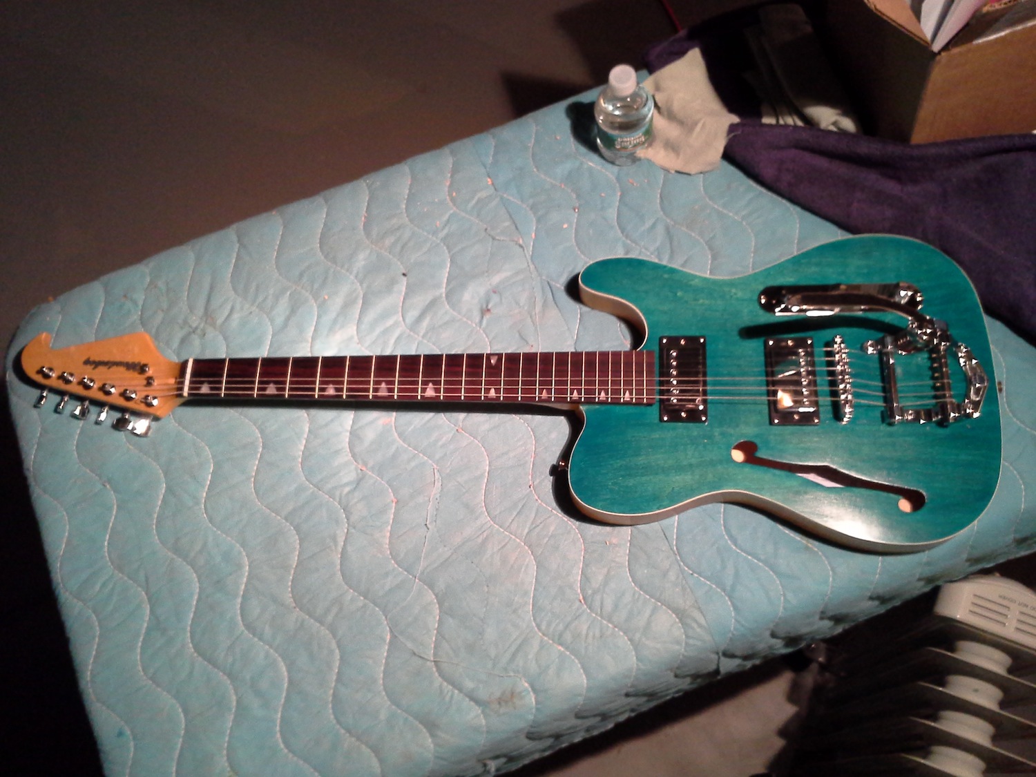

    ...and here's 2 hours later:

    So far, so good; everything fit pretty well, even if positioning the whammy was a bit of a Hail Mary. What you see is everything from the kit - no upgrades. The neck needs to bow a bit more - I tweaked it and will let it sit with tension for a while and see what happens. Miraculously (and I hope this is some kind of sign) the intonation is fairly spot on. I need to do the usual set-up tweaks to get it right (and possibly a smaller spring for the whammy), but my quick test tells me that it has a nice sort of hybrid sound - fairly bright, but with some warmth from the humbuckers.
    I'll keep you posted and get better pics...

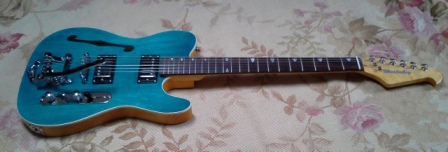

    Still left to do: neck adjustment, nut work, neck bow, intonation tweaks...

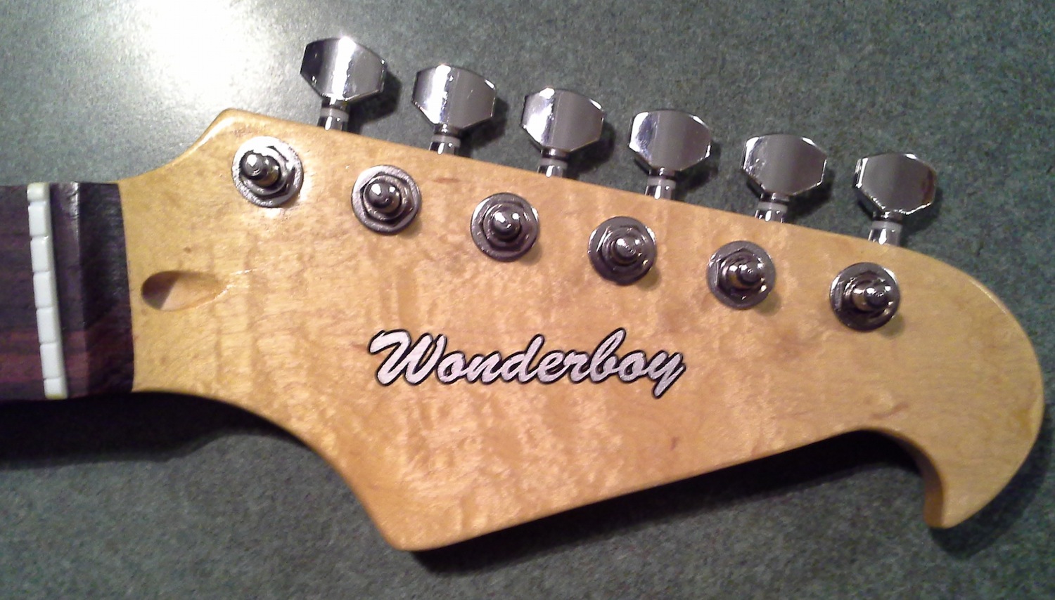

    Set-up Advice?
    Hey Everyone,
    I've gotten a bit bogged down in the set-up, and any advice is welcome.
    First, the nut slots were all too high off the fretboard, so I thought I could lower them all uniformly by taking the nut out and sanding the back. Clearly I was leaning too hard on one end, as when I put it back to check the B and E were buzzing like a sitar - I had sanded off too much on the high side. I tried to put a very thin shim in, but that raised it too much. I ordered a bone nut from Pit Bull, and I'm going to try again. If I have to lower the nut slots, what's the best way to do that - get a set of nut files?
    Also, the neck was absolutely flat, and I wanted to introduce a slight bow. I have cranked the truss rod a number of times(counter-clockwise, please tell me I'm doing it right!) and the result is incredibly slight.
    Once I get the nut in I will adjust string height and intonation - my fingers are crossed as there is not much travel in the bridge saddles.
    Right now it plays fine in the middle of the neck, but not in open chord positions. The B and E strings sound great if you're into that Coral Electric Sitar thing...but I'm not.
    Fingers crossed! If all of this fails I may have to learn slide.
