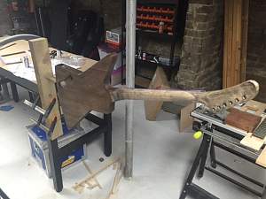

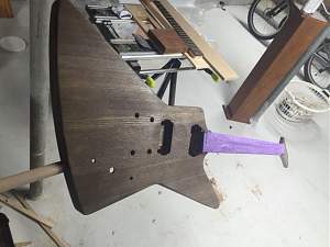

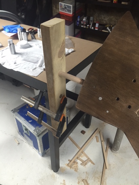

    Okay so we have finally gotten unpacked and set up enough to start working on this thing again!
    Taking on board some of the experiences of others, and having already tried staining it once, I decided some thought was needed in order to be able to stain without juggling full guitar, stain covered cloths and trying not to let it rest on anything.
    So I knocked this together from materials on hand:
    Its a bit rough but at least it allows me to access all parts of the guitar and turn it without too much trouble. In hindsight though, version 2 will probably use a bearing to ease the turn.
ID:	13506 Click image for larger version.
    if you are wondering about the grey on the maple neck its a legacy of having tried to darken the maple with india ink from my first translucent Black stump attempt. the india ink worked okay, the finish less so.
    On the whole the finish has gone on a lot more evenly, with the wipedown method pioneered by ...Andy40 I think? I was concerned that there were areas that might end up looking a bit ragged from the sand back but it all seems to be looking okay. Now to wait 48 hours.

    I do something similar with a dowel up the plug socket hole (said the bishop to the bar maid) and held in a vice.that body is going to look great once it gets clear coats
