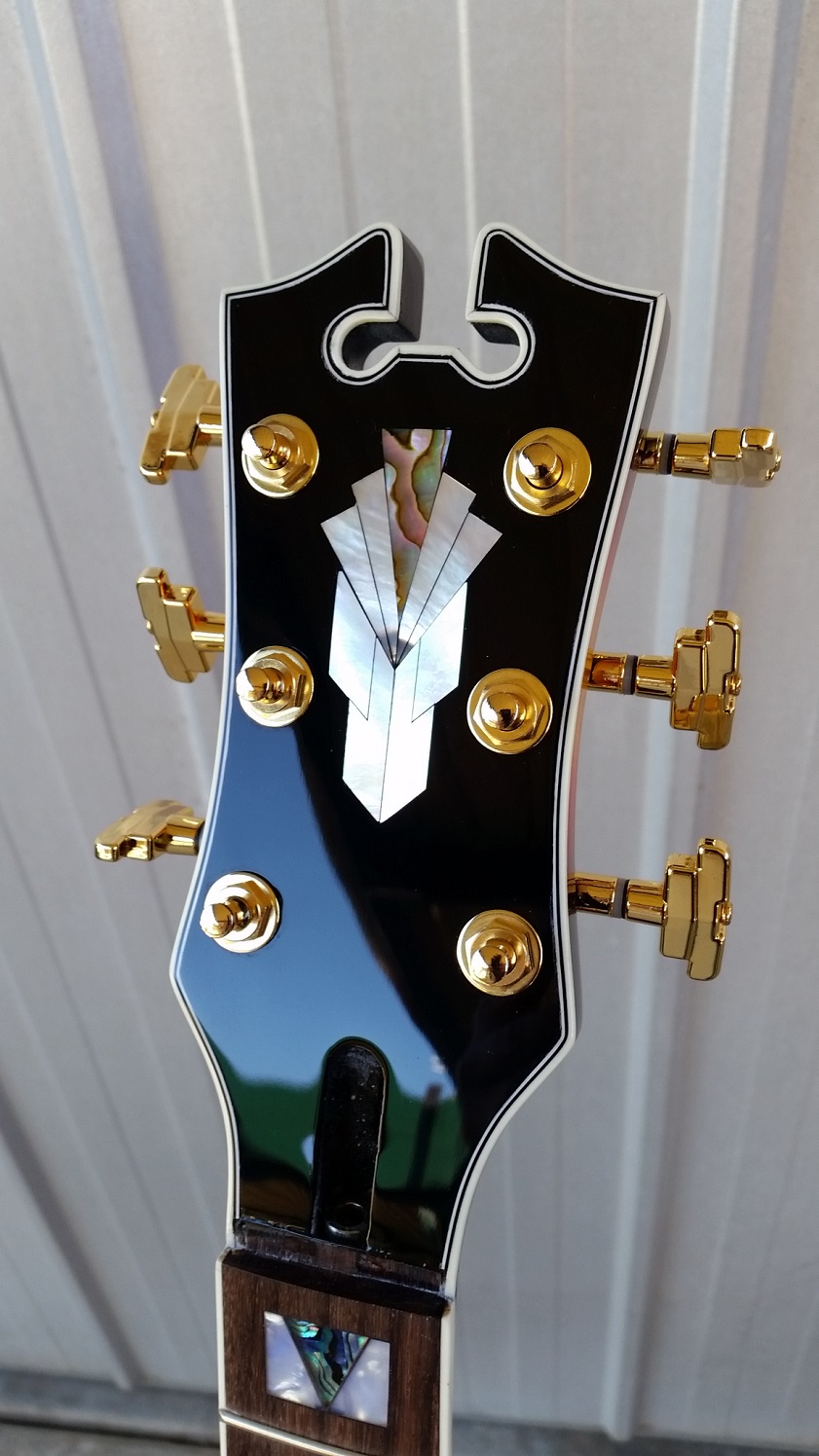

Tweaky - I had the same thought of using a headplate. Taking 2mm off the face of the headstock, making the 'plate smaller around the edges to allow for the binding/purfling, putting the inlay in the 'plate, use locating pins to glue it in place. That way, you have an instant binding channel on the edge of the headstock to work with. Down side is taking material off the neck so close to the scarf joint. As you point out, it will be replaced, but would the same strength still be there? Don't know, so I did it the way I have.

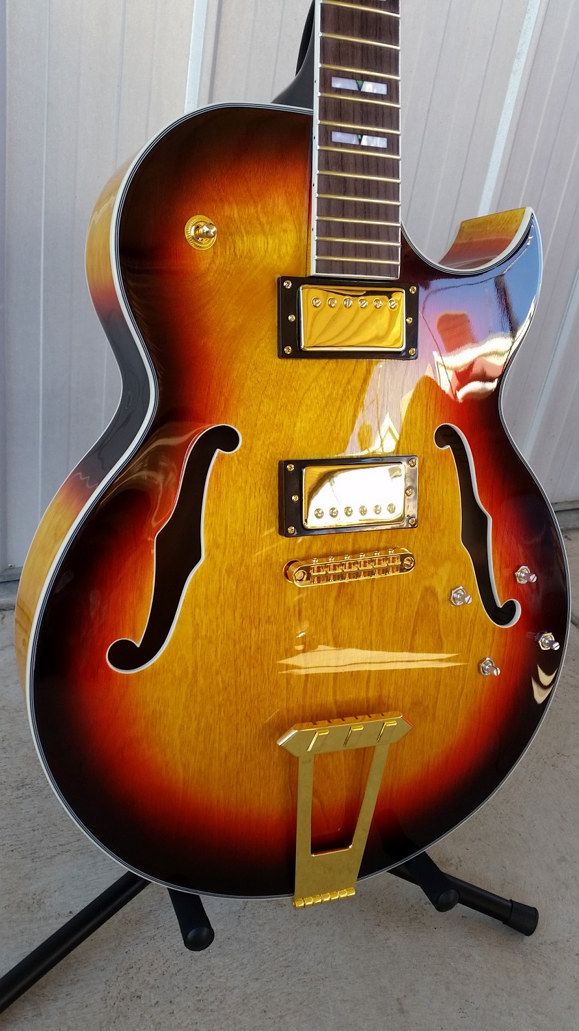

Thanks DB07, I used Maguires Ultimate Compound and Scratch X 2.0, have to thank GavT for pointing me in that direction. There are less expensive compounds and polishes out there, but the time you can save with this stuff makes it worth it.
Thanks Andy, I used Colortone stains, from stewmac. A mix of vintage amber and lemon yellow for the main colour, then cherry red and black for the burst.

Cheers guys. Have made some progress. Neck has been polished and glued in. Tailpiece screwed on.

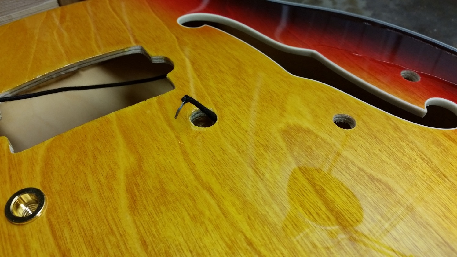

Soldered the pups to the wiring harness and installed that.

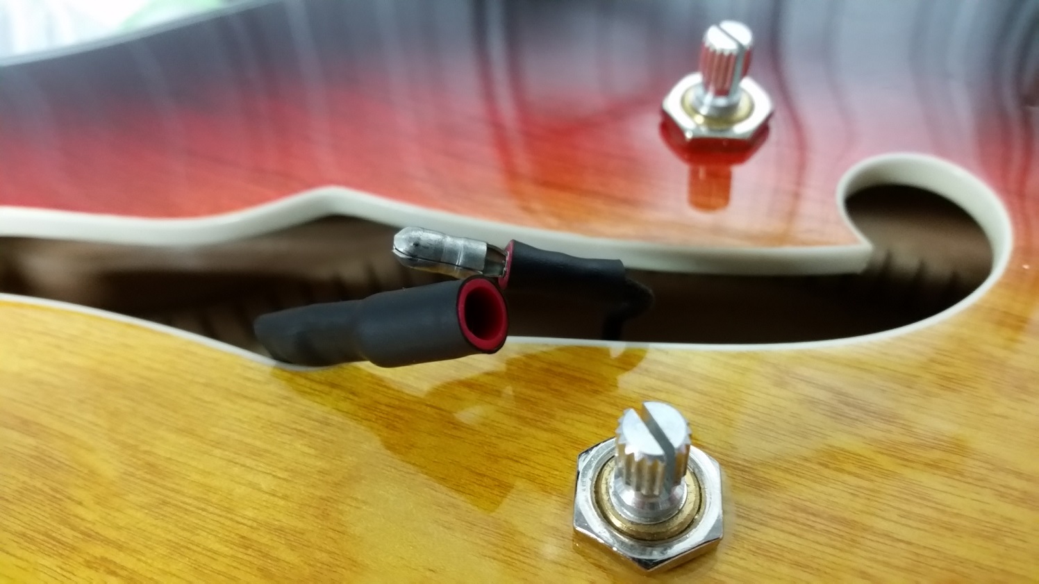

Some pics. First, earth wire to bridge post, decided to add a bullet type connector to that earth wire in case the wiring ever needs to come out.
Pups mounted.

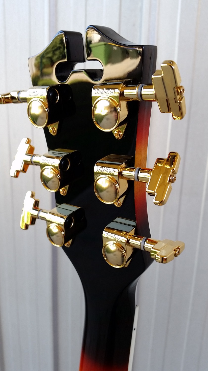

And fitted the Wilkinson Imperial tuners.

Sweet... I think thats the shine I want on mine. Did you use any clear acryllic, or just straight to the Meguiars?

DB07, you will need to put some sort of top coat over the stains. I used acrylic lacquer but you could go for DingoTone, polyurethane, nitro-cellulose, tru-oil, etc. With the exception of DT, you are going want to protect yourself from the nasties in these products.
A reminder to brush some of your clear coat into any drilled holes before you start wet sanding the top coats prior to polishing - got that tip from the forum, Jarrod I think. Stops the timber swelling, and try to keep the amount of water to a minimum.
