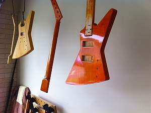

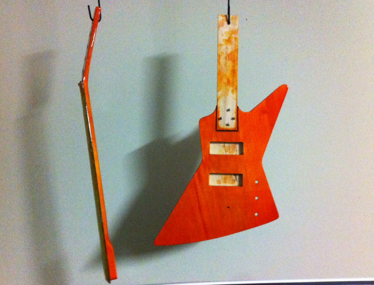

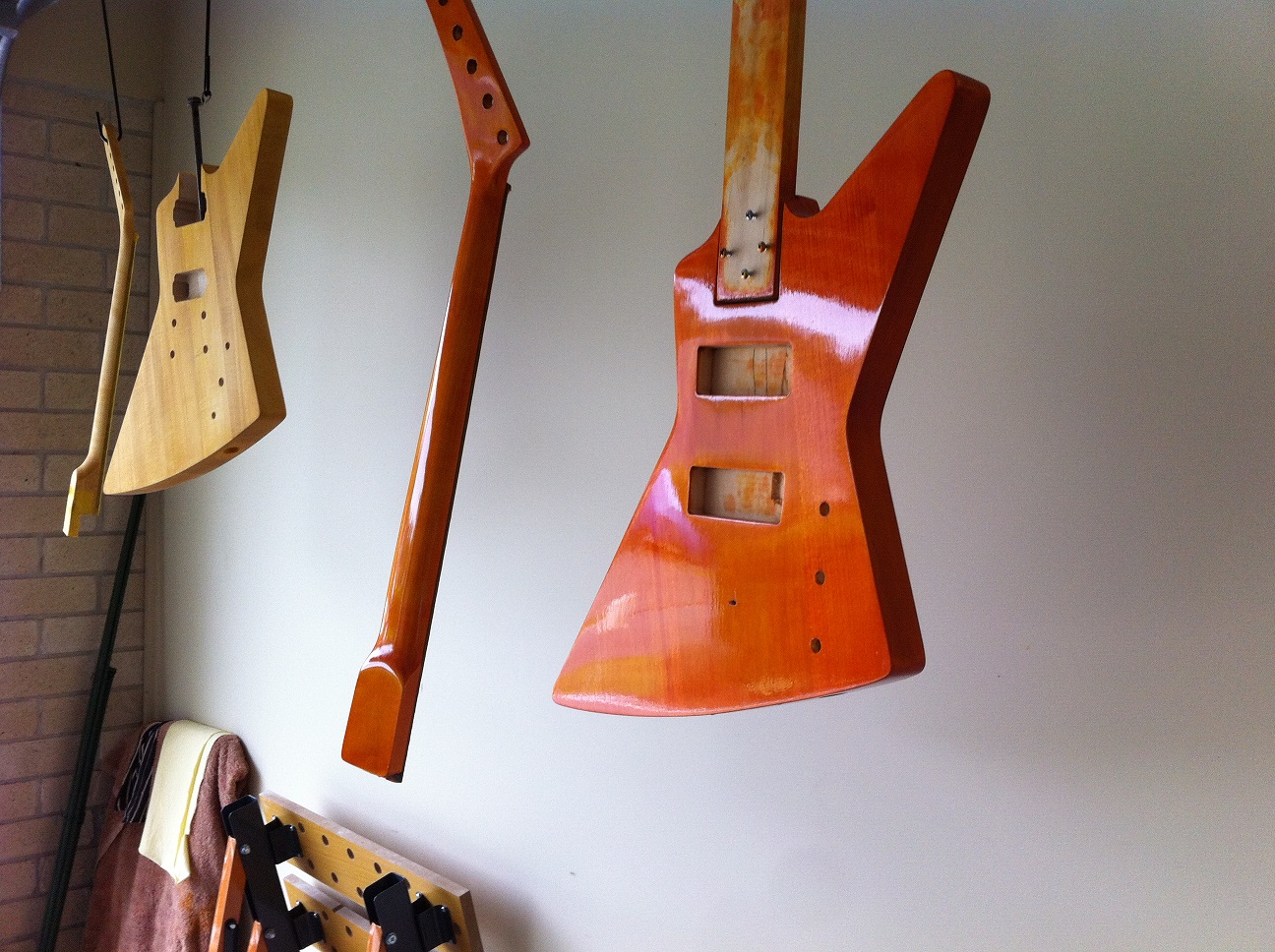

    Applied 5th coat of TO with a brush today.
    Varnished a few sailing boats when I was a teenager and TO looked and smelt similar so why not use a brush. Looks good wet with not too many brush marks however overnight drying will provide proof as to whether this worked or not.

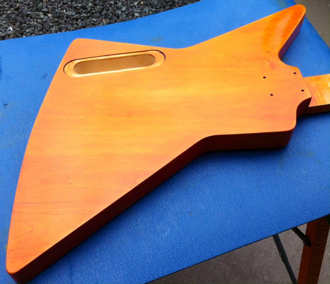

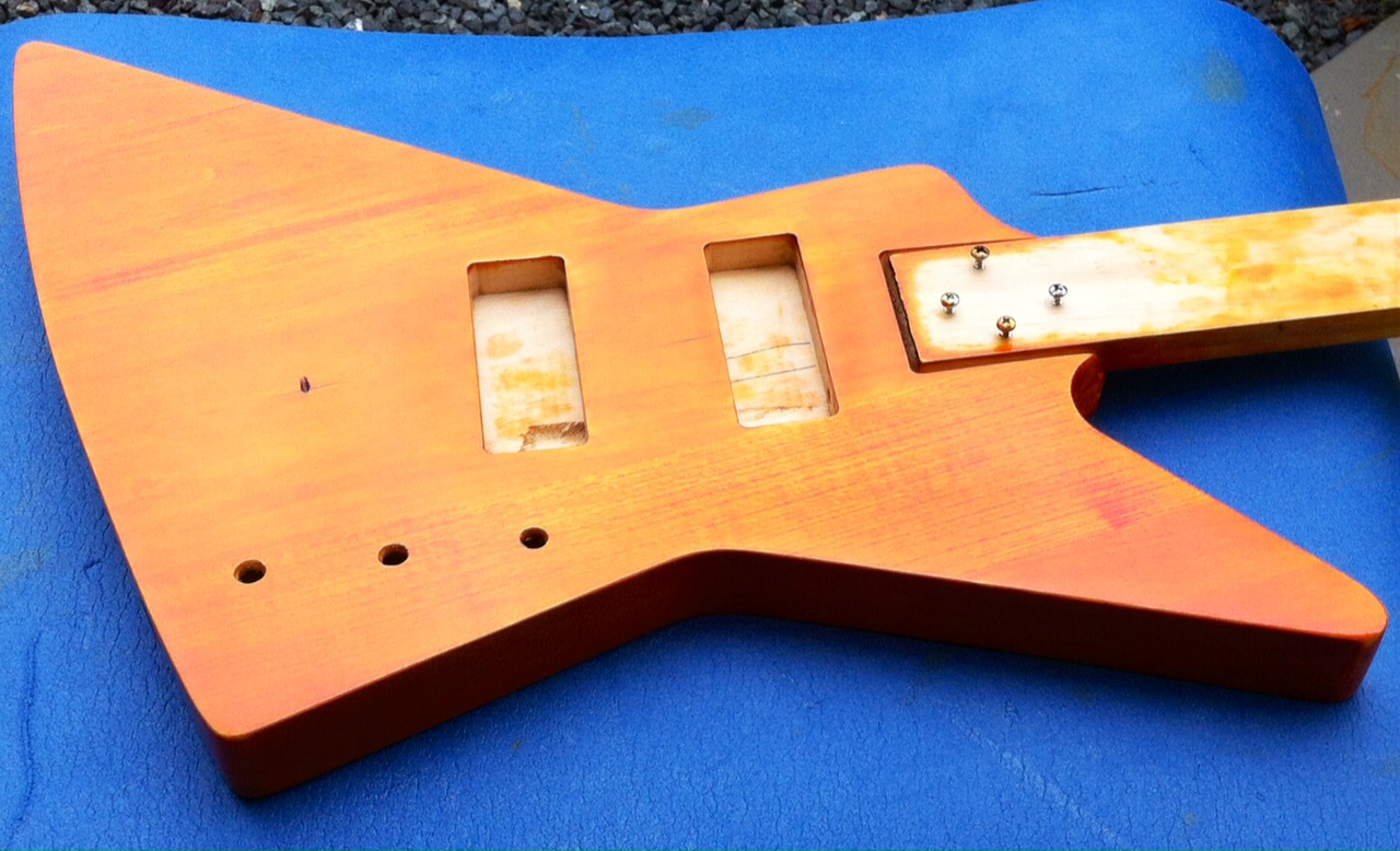

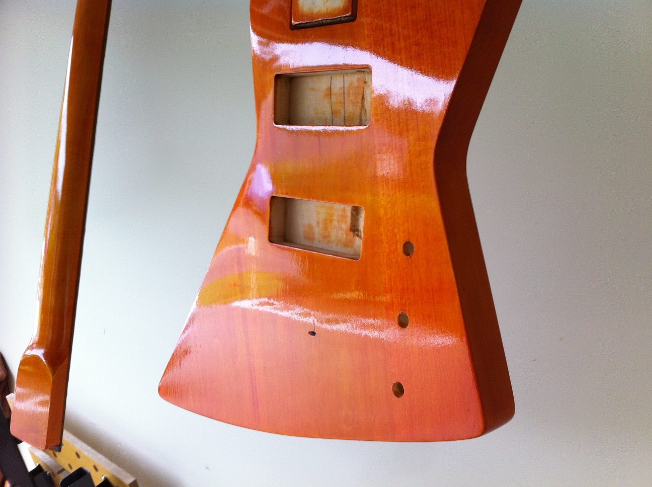

    Here are some better shots using soft natural light as it is overcast here this morning.
Name:	Guitar shots 28 Dec 2015 001.jpg

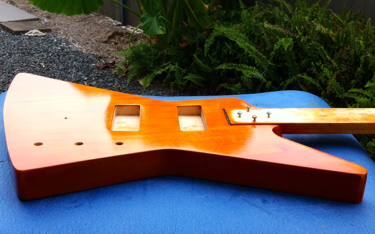

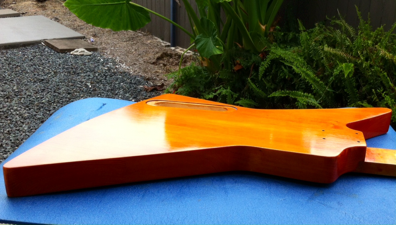

    Time for an update. Over past few weeks have applied 4 coats of TO by brush, left to cure for a few days and last weekend wet sanded with 1500 grit. Ragged a further 4 coats on during the week and took these shots outside using overcast skies for some soft natural lighting. The colour in photos is a true representation of how it looks and really pleased with how it has turned out.
ID:	7836Click image for larger version.
ID:	7837Click image for larger version.
ID:	7838Click image for larger version.
